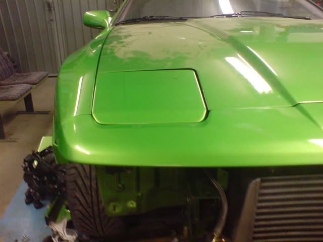

Startedout mounting my nsx headlights. Which was a f**ing hell. The funny thing is that i read on swedish forums.... "it's bolt on" and so... but i can say it's everything but bolton. But actually that's good cuz then dont many others do this mod.
After one and a half days work me and my friends come this far. Everything is testmounted with "glue" or what it's called, hehe.
After one complete weekend one of them was finished properly. Just the realdeal no cheat.
If you click the link there's a video.

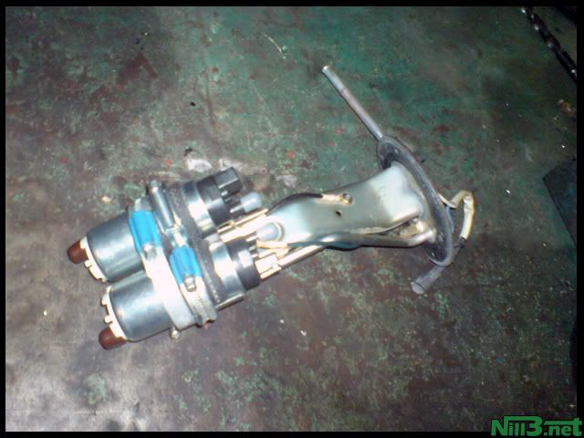

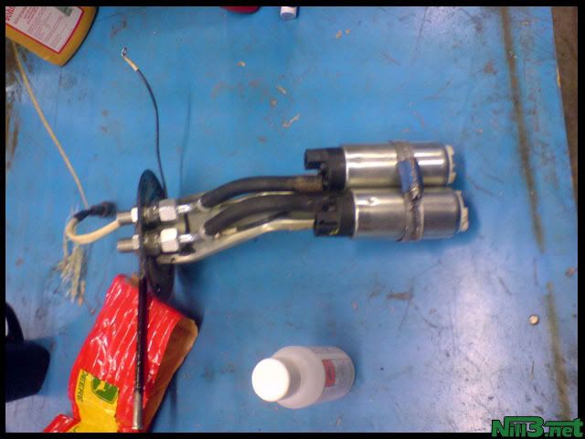

Today i've build a dual walbro pumphanger. Didn't got the tank where i was but i hope it will fit. Otherwise i make it fit :) i've also trashed my interior plans, for now... don't got the time. Also bought interior parts so i can restore it to how it was before. I will skip the backseat tho and have the battery there.
nille__
Sep 8, 2006
22
sweden

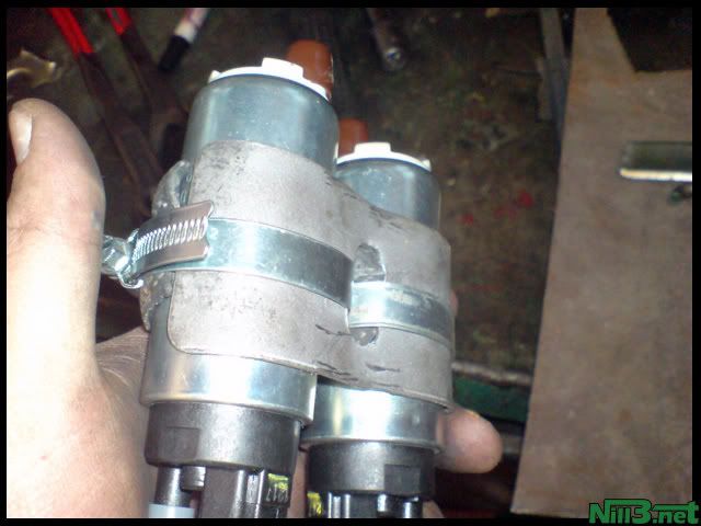

here we go... another weekend has passed by... it took three failures before i got my fuelpump hanger right. It's a pain in the ass to have the car 20km away from where i was working with no messures. But after some grinding on the tank i got them in.
Drilled two holes in the lid. And fitted two 1/4" fittings in there with 45degrees fittings to the fuelpumps.
Now i just have to order som adapters from an to inch. I went with 1/4" from
the pumps to a y-cross then 1/2" through a aeromotive fuelfilter and to a fpr. After that i go with black an fittings and stainless steel braided lines because it looks nicer. I wanna keep my engine room polished and black.

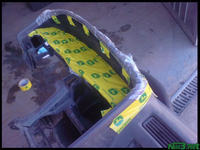

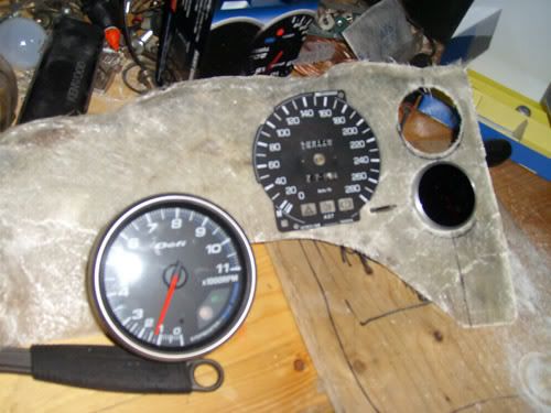

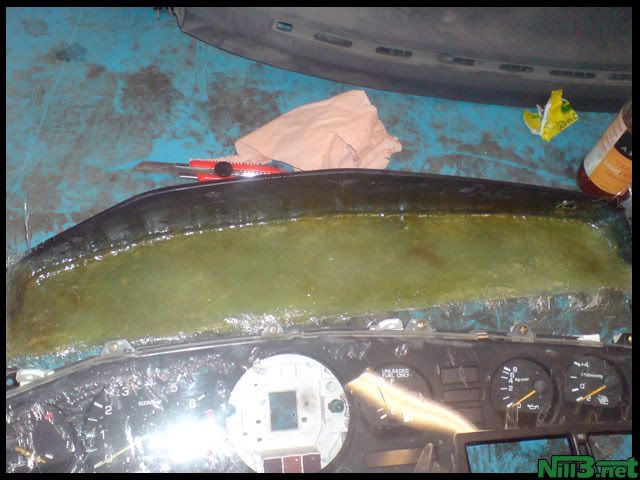

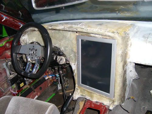

I've also started on my new dashboard. Since i put my computer and 15" touchscreen on ice i have to make a new one because i will use defi gauges.

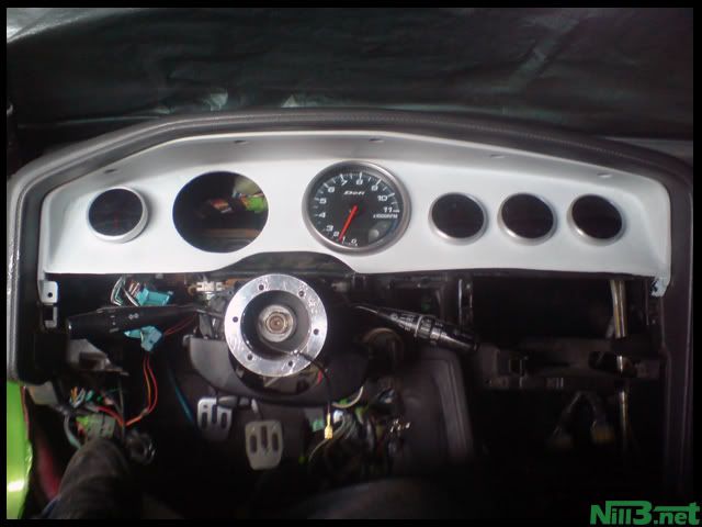

Today i mourn, both westham and hif lost(they play soccer). But your weird people doesn’t care about real football! ;)
But atleast I can give you guys a picture I took a couple of days ago when I testmounted my dashboard. Not finished yet but much closer than one week ago.

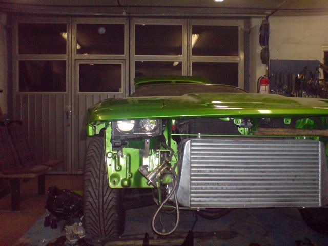

Started mounting the kit here manifold and oil lines are there and i plugged the cooling lines.
Also removed old oillines and stuff from the powersteeringpump and mounted my new from driftmotion.
Also got the new lightendflywheel and arpbolts from dm so i mounted it and the gearbox with driveshaft. Just waiting for my clutch now. I get it wednesday or thursday.
