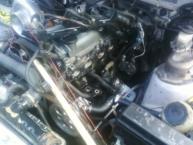

Starting to strip down the 2jz to clean it up :D
1 days worth of fun :)
started to gut the interior (massive rust spots, trying to fix)
Picture of my lovly R154 already for the jz. (built with marlin crawler internals, from previous owner and receipts :p)
i think shes ready!
and shes in
Than i moved, and dident take to many pics, fixed all the rust. did a primer job. and this is how she looks as of today
and man, this pic makes the t78 look godly. haha i <3 Lighting

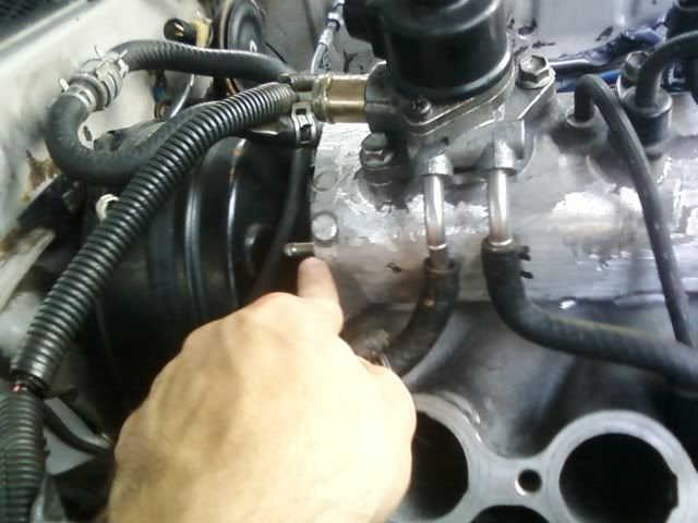

#1

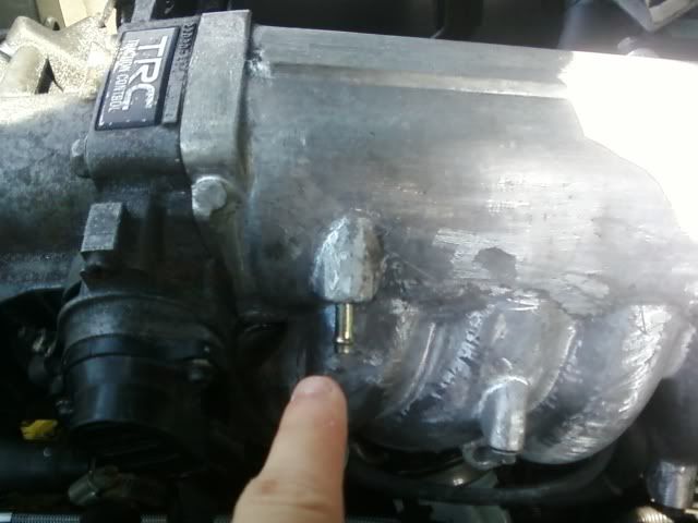

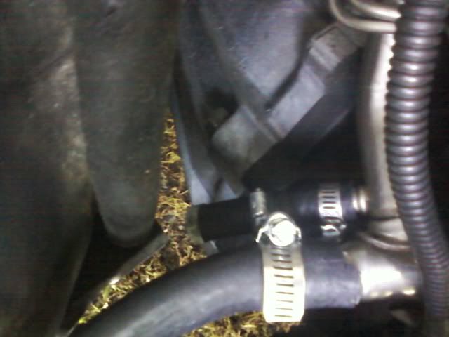

#2
#3
I dont know where these go, and the big one (i think its a coolant line but im honestly not sure at all). just post liike #3 (this is for this and goes here) i need your help supramania :(......and how do you guys like my.. FAIL polish job. i cant do it, im afriad to hurt something. haha

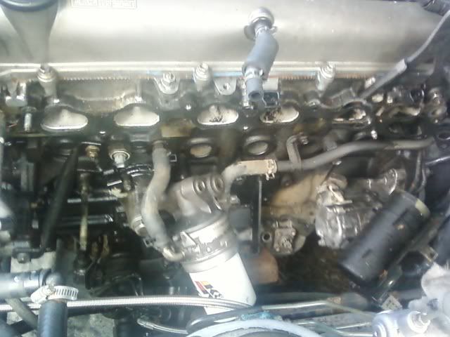

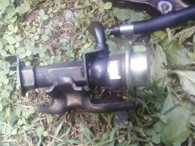

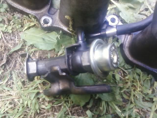

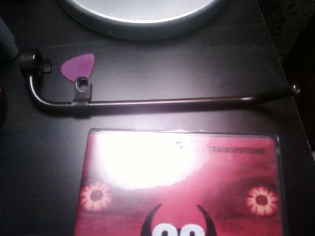

Update on the Build. Went to turn on the car (not start) to see if the fuel pump was working correctly. and after .1 seconds of the key on "on Position" i heard splish splash. and turns out the fuel banjo was NOT sealing. new brass washers dident work. threads on this unit are stripped. so i need your guys's help. i wanna get rid of this. i honestly dont know what this is. and want to get a fuel line and bypass it completly. the threads on it are completly stripped and i need to do something that really dosent cost too much to fix this problem here is pictures of the unit.

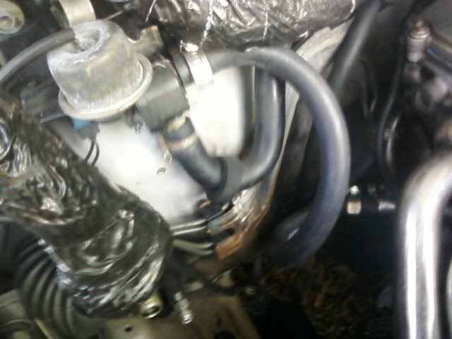

Also, above with the lines on the intake manifold Picture 3 is suppose to be running on a water by pass hose. well after i got the intake runners off. WHERE IS IT? What should i do with this water line, and the really big one in the back.......Nothing is there!. Here is a pic after intake runners were off. i removed nothing else.
---------- Post added at 06:27 PM ---------- Previous post was at 06:13 PM ----------
Found out what that thing is, its the Fuel Pressure Pulsation Damper........Can i get Delete this?
NokaoiMK3
Drifter..
Jul 27, 2008
275
Gilbert Arizona
Driftmotion has the fuel dampner bypass hose for like 65 bucks i believe and its braided stainless with an fittings.. defiantly good to delete that dampner anyway since your single and im sure you will be upgrading injectors and possibly fuel rail soon as well..

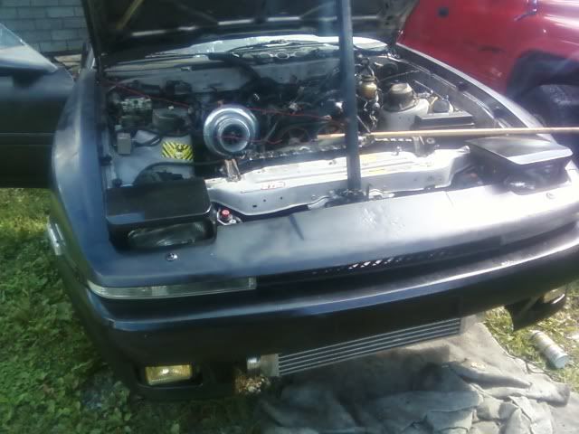

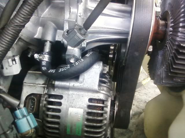

Yeah, in due time. as for now im going to Ghettoly bypass it, due to the fact i lost my job etc. so i gotta be cheap for now but get it working to get a job etc. its almost finished and ready for the road... so what im going to do is on the fuel rail, the inlet/banjo hardline. im going to cut that. use Fuel injector hose and hose clamps (THE GOOD ONES, not cheap ones lol) and run the line from the hardline to the stock mk3 hardline. eventully i want to do the top feed fuel rail and 1200cc injectors+ems. i already got 2 fuel pumps so yeah. just in due time. (Income tax). as for now heres a update on the car.
