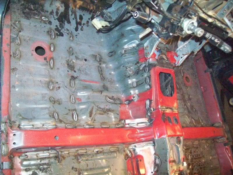

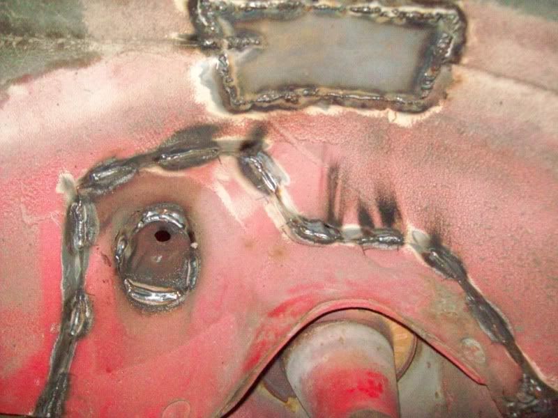

Engine compartment is stitch welded, and all unnecessary holes are patched (going for an aggressive wire tuck and battery/fuse box relocation)
door jambs, and rear hatch are also stitch welded

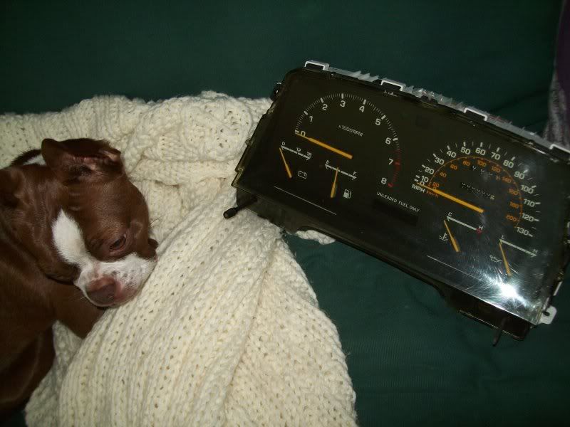

taking it easy i re-freshed the dash cluster and heater controls with blue LED bulbs and a general good scrubbing... Also seeing how the title already had an odometer discrepancy i figured there was no harm in marking the cars re-birth by rolling it back to 0
my boston Gizmo was less than impressed by the improvement!

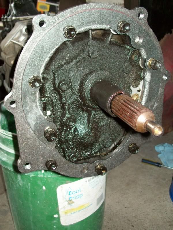

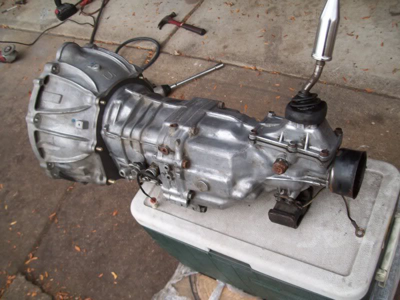

using the plans from
http://www.v-eight.com/tech_forum/viewtopic.php?f=40&t=753
I fabricated two sets of trans adapters (1uz to w58) one of which is up for grabs :naughty:

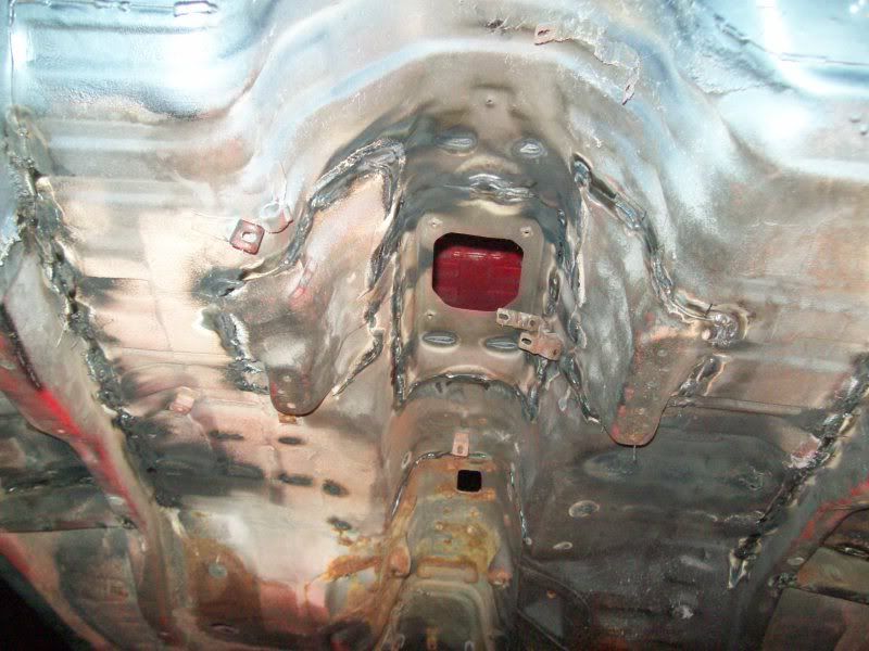

More stitch welding and rust patching
(rear shock /wheel well)
(front frame/transmission area)

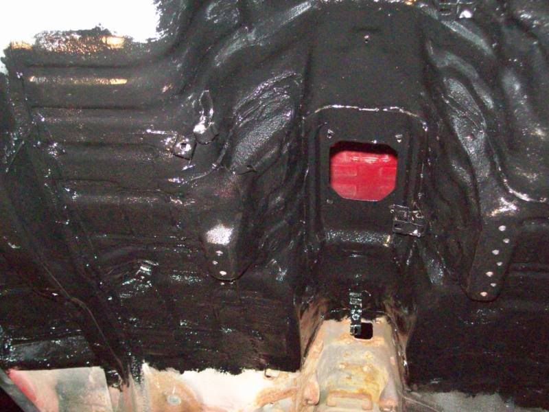

naturally more por-15

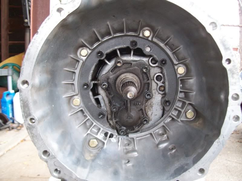

11-23-09
With a little bit of modification the 1uz auto bell housing test-fit looks to be very promising

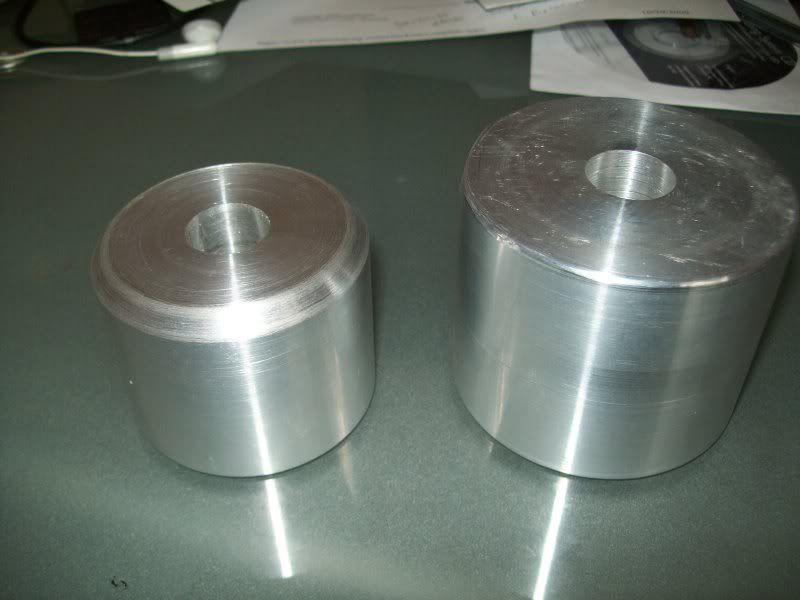

Work on rear suspension has begun, including the fabrication of solid aluminum sub frame mounts
