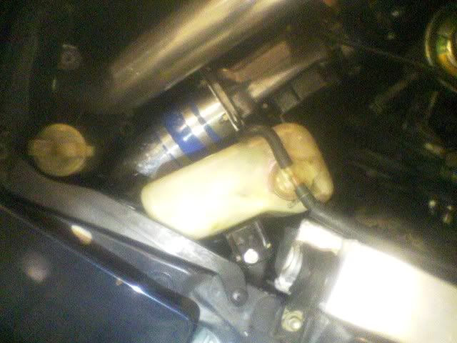

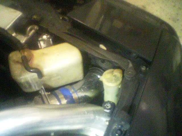

There's not as much engine braking as a direct mechanical drive, true enough, but if you keep it in a low gear with the gear selector lever, you will still get the job done. You shouldn't need much more than 25 miles to get it set and then you can have some fun.
Never heard of the level of the overflow bottle relative to the rad. to be a factor, but I learn something new everyday. Possible to keep it near same height as stock if you move it to the location you are talking about? If not, a friend of mine tackled the relocation of the overflow bottle by putting it in approx. the same spot as the stock air box. Keep in mind, he is running e-fans and NO shroud, and the air filter is on the lower end of the pipe on the front of the AFM for everything to fit in that corner. Not the optimal set up if you drive your car when the roads are wet. See below:

Yeah that might work. My air filter is where the washer bottle was so there should be room there, but Ill se when I got most of the parts back on.
