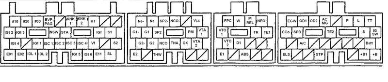

Hi i have a question about that switch, i have a auto ecu with manual r154 gearbox, how should i connect nsw and sta to get the car to start? I dont want any clutch switch or anything like that.

I dont know what it called in english but you cant start the car with the drive or reverse on the automatic gearbox, so i must rewire something to get the car to start with the manual r154 gearbox..?

Oh, I missed the part about the auto ECU, sorry. Anyways, the line should either be grounded or hooked up to 12v. I'm not sure which though. Try grounding it, if that doesn't work, hook it to 12v.

I'll get you the answer here in a little bit. There is a big plug that goes to the auto tranny and you need to connect 2 of the wires. I can't remember the colors though. I'll have to go out to my car and untape it and take a look. I'll let you know though.
