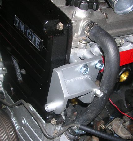

I know you are going with a short runner, but no one has posted a pic for ya, so here is a pic of my Alt drop bracket I made for using a long runner FFI. This way I keep my AC. You can see how the Alt sits in pics on my build thread.

nice...thanks a lot man. did u use the stock tensioner in the same stud/spot?
also wat size hose are u using for that oil feed?

No I'm not using the stock tensioner, mine is like the one in the pic below. IIRC the vent-blow by hose is 5/8".
i was looking at getting a ffi setup also.. but i wanted to keep my ac in the stock location and was looking for a lowering alternator bracket like you have. where can i get one of those brackets?
