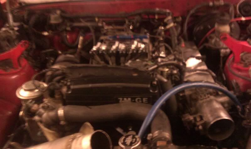

Hey guys need help figuring this out. I bought a new built motor off this guy a lil while back and with i got a custom front facing intake manifold. From the looks of it it seems to be a lexus ls400 throttle body . My problem is mainly with the throttle postion sensor . This tps doesnt connect to my factory wiring harness. The part number is oem toyota part with # 89452 12050. From what im thinking this is from a ls400 too. Is there a connector that will attach to the factory wiring harness or can i use my oem 7mgte tps on this throttle body? And cable wise what is the best way to route the throttle cable and what cabling system can i use?
Heres a pic of the setup
Please guys help me cant find any info on this...

Use the 7M TPS is the best choice.
Just make sure they both turn the same way when the throttle is opened.
You may need a Mk3 NA throttle cable assembly, as they are a tad longer than the GTE cable.
Or, find a heavy equipment supply house, as they are ussually set up to make custom cables.
Take them your assembly, and say you want it 'X' longer.

So a 7m tps should work on a ls400 throttle body right? (just making sure before i buy on)

Don't buy one first, find someone with an old one, and look at it.
Sorry, it has been about 6 years since I had a 1UZ throttle in my hands.

well i realized that i still have a stock 7m tps but i have to check and make sure it will work tmrw. it would be awesome if it does.
Any body know for sure?

ok so my mechanic said that the stock tps wont work with the ls400 throttle body so does anyone know where i can source the connector that connects the tps and runs to the wiring harness or what else i can do with this??

well thanks for the help i guess guys but i found an ls400 tps connector and wiring and im wiring it into my wiring harness should have my car up soon!!!
