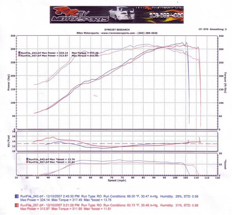

im pretty impressed with the low end response from my na cam. but the lack of power above 5000 rpms makes the cams not worth it. in order to verify the power fall off i feel in the butt dyno i need to go to a actual dyno and make sure its as bad as i think. for reference there is a thread somewhere with comparative dyno pulls between a turbo and na cam
