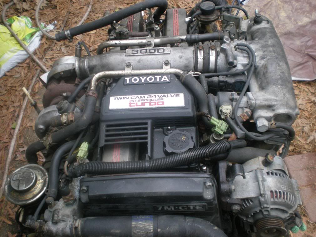

Monday I took off work... Lord knows I hate that place, LOL, and pulled the motor from the donor. Everything looks to be in great condition, aside from a couple of rotted hoses and buildup from leaking valve cover gaskets. The guy I brought the car from said that he was getting rid of it because I was leaking antifreeze from behind the block and a local shop told him it would be $800 to fix :aigo: because they had to pull the motor. This thing actually had a hole in every single hose that runs behind the motor.
Anyway, I finished pulling the rest of the accessories that I needed today, so for the next couple of months, I'm going to take my time and gather the things I need to complete the first phase of this project... gaskets, seals, valve job, ect.

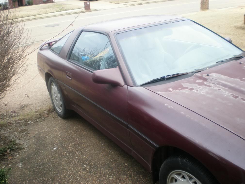

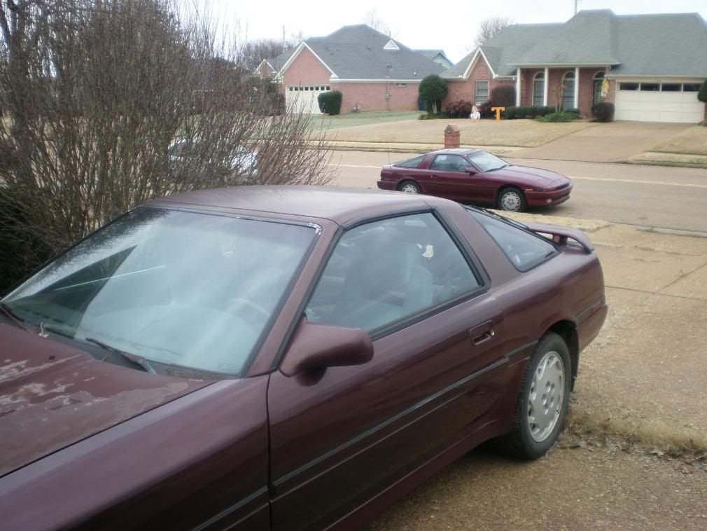

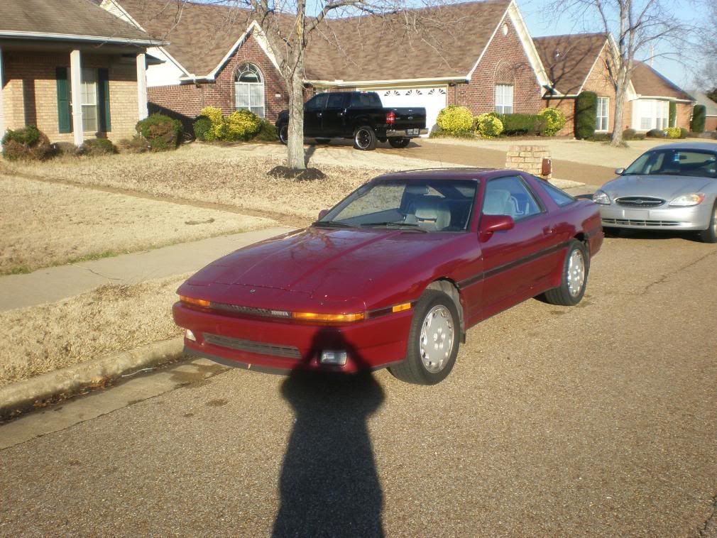

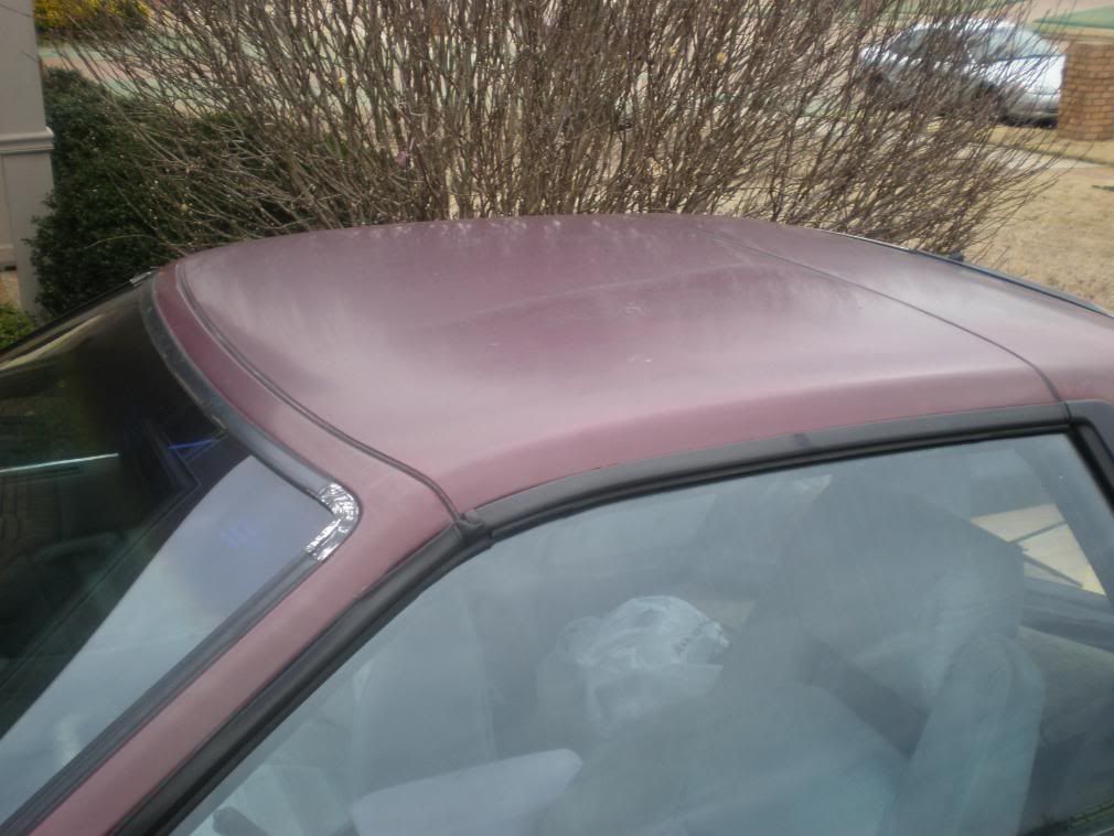

Yeah you're right, so here we go. I think it should be easy to tell which car is the donor and which is mine, but mine has the sunroof and is shinier... the donor has the targa and is a little faded...

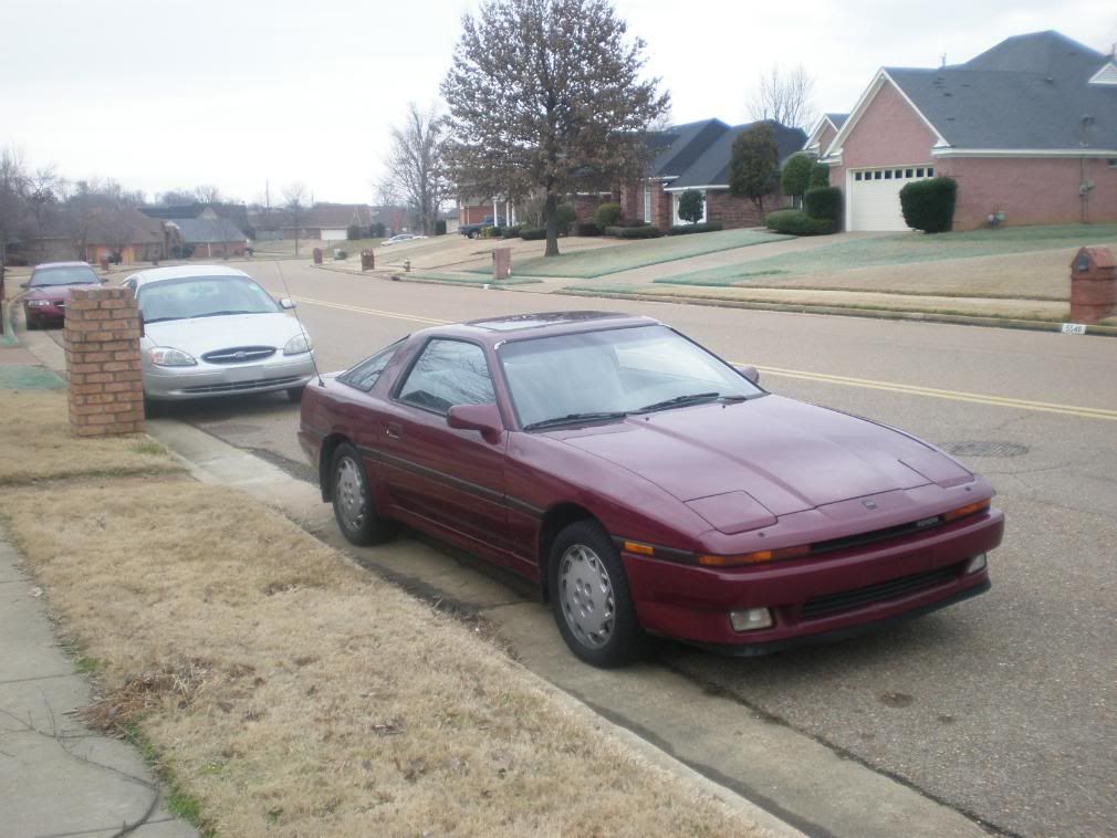

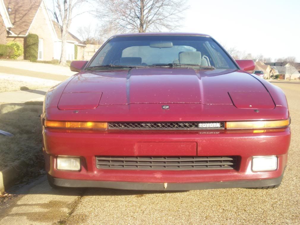

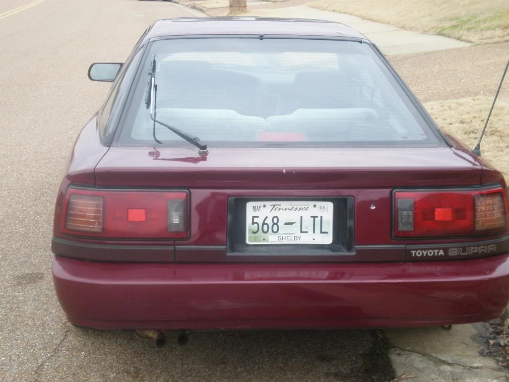

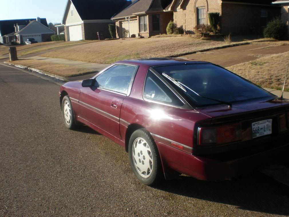

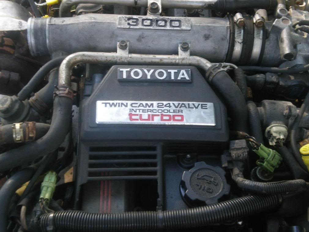

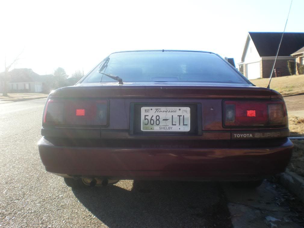

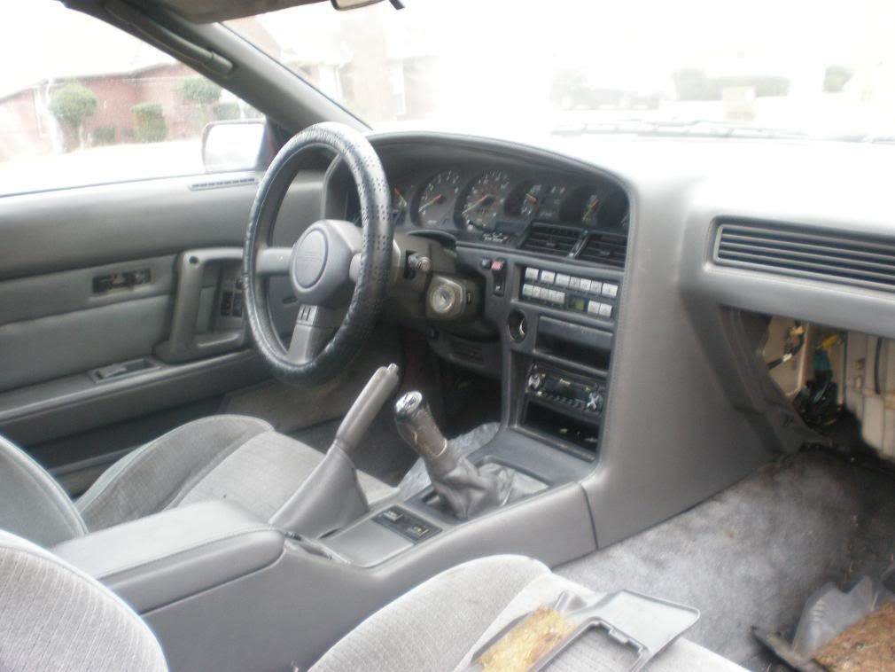

Alright. So it took a while to get these pics up, but here they are. I'll try to arrange them in some sort of order... hmm...
OK, these first couple of pics are of the NA that I'm converting to turbo...

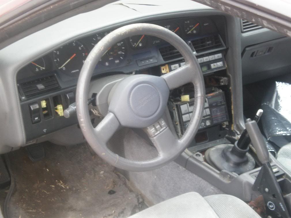

And the interior...
During heater core job...
http://i268.photobucket.com/albums/jj23/adicken1/SupraPics005.jpg
Back together...

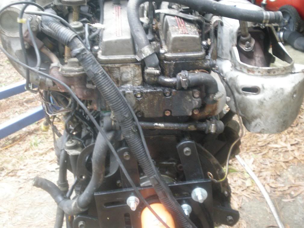

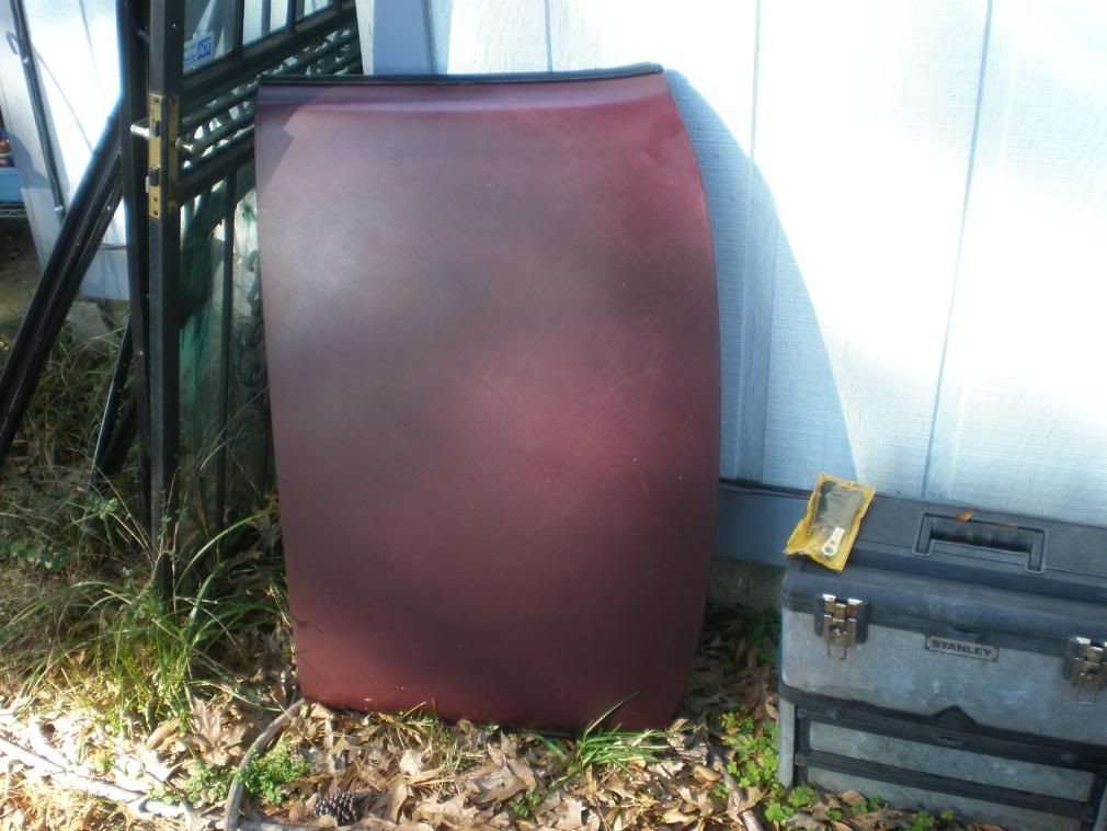

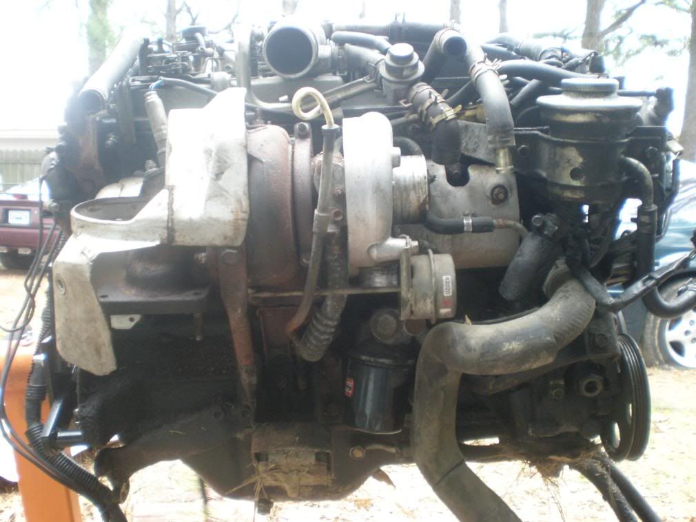

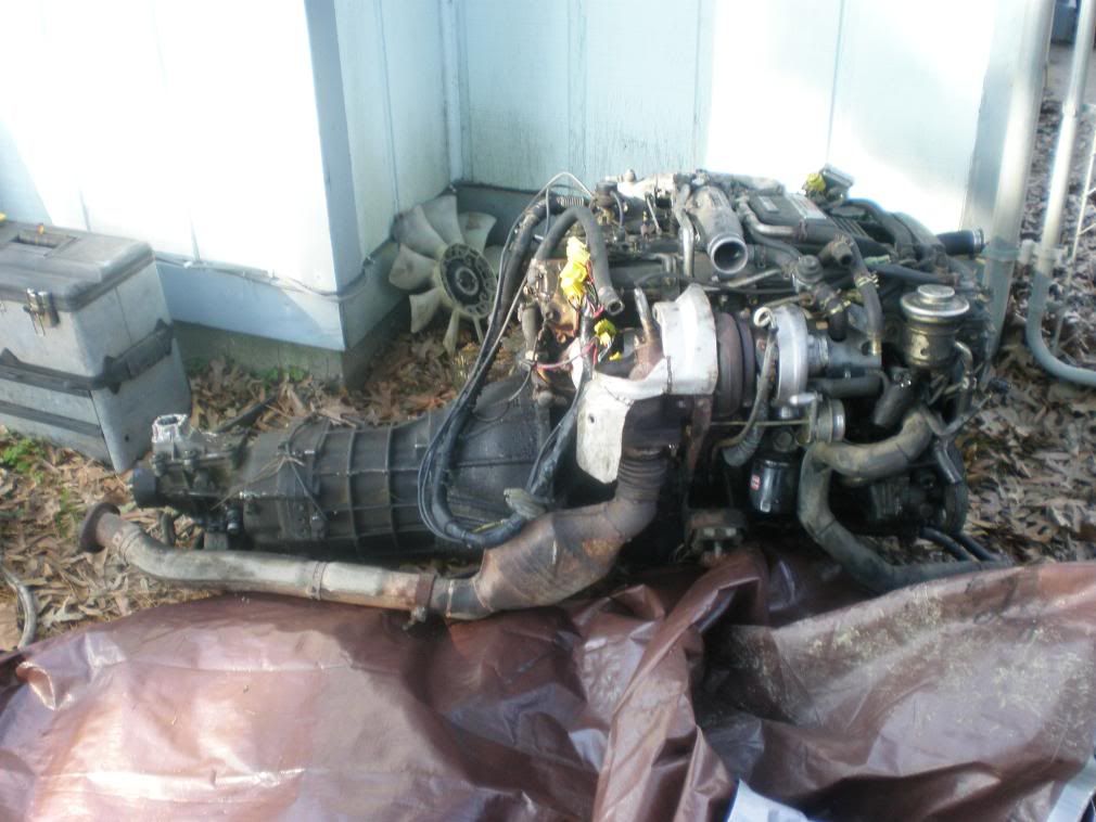

Now heres some pics of the donor...
And its interior...

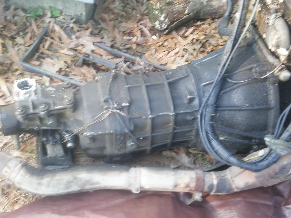

And the pics after the car was stripped and the motor was removed...

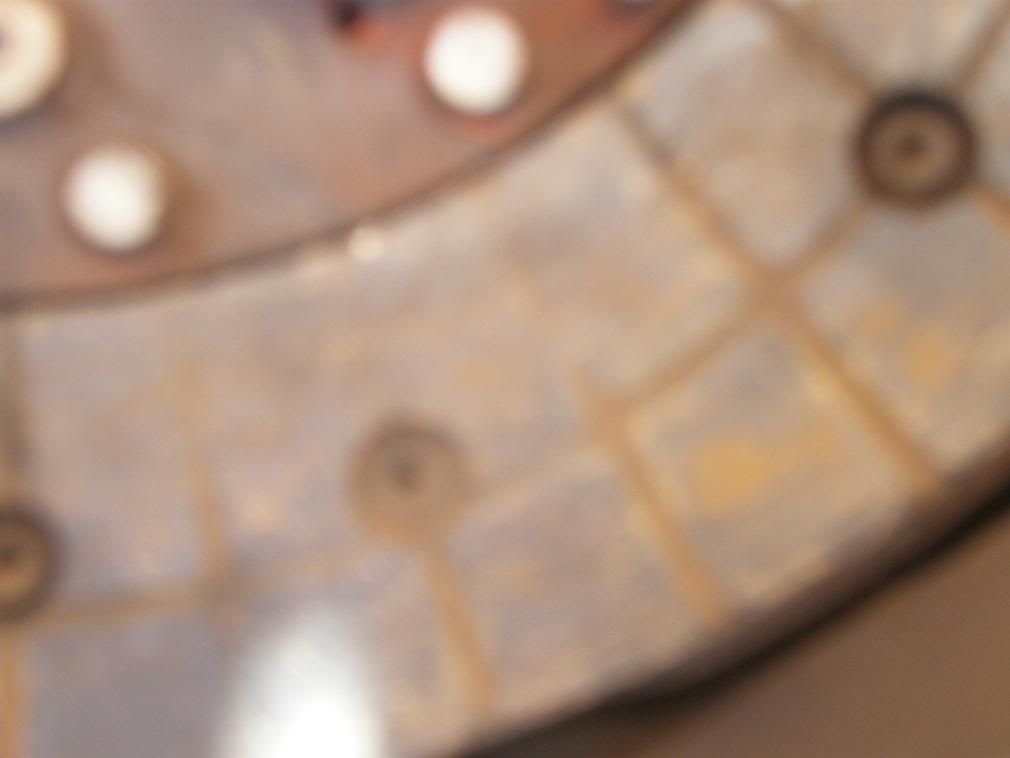

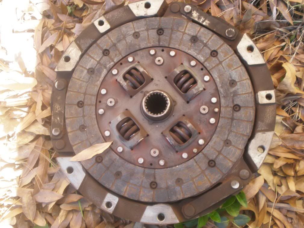

How about this for an old ass clutch!!!
http://i268.photobucket.com/albums/jj23/adicken1/SupraPics032-1.jpg
http://i268.photobucket.com/albums/jj23/adicken1/SupraPics033-1.jpg

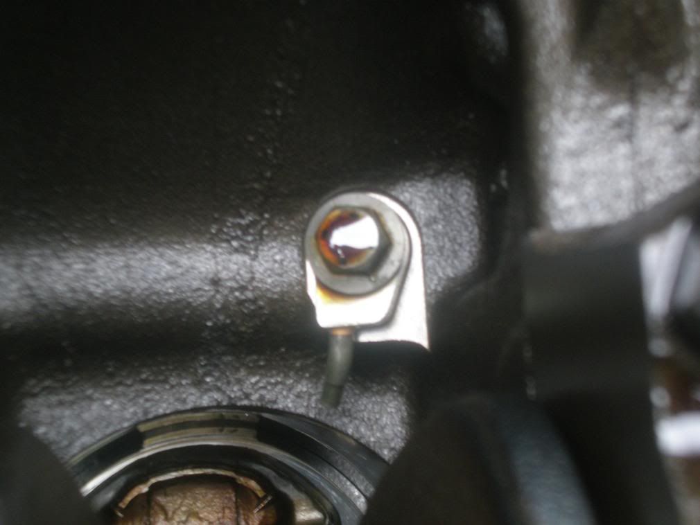

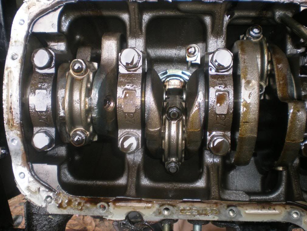

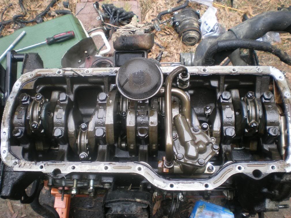

HAHA. Actually there is. I was debating whether or not to tear the motor completely down or not... keep in mind that I never ran the GTE that I bought. (The fuel pump was shot when I got the car and would only turn over on starter fluid.) I did decide to go ahead and tear it completley down to see what I was working with.
I finally found the time to get it on my stand and to pulling it apart. I got it down to just the block, crank, rods, and pistons and I must say that I was EXTREMELY impressed with what I found. There was minimal gunk in the oil pan, none on the pickup screen. (when I say minimal, I mean a very little bit on the bottom lining on the pan, thats it.) The cams look excellent. No scoring or marks at all. It looks brand new. The crank and rods are beautiful as well. The hatch marks in the cylinders are still very visible, and the is just a small amount of carbon buildup on the head of a couple of pistons.

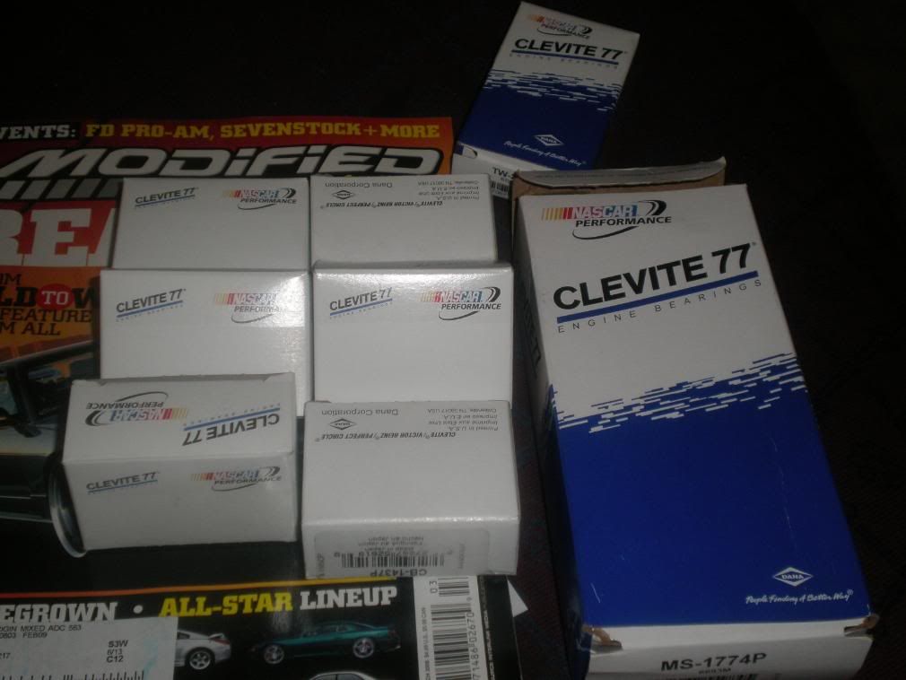

I just got my main, rod, and trust bearings in the mail the other day. Now I'm just waiting on my ARP Head Studs and my ARP Rod Cap bolts. I've got a couple of pictures that I took while tearing the motor down, but the camera in my battery was dead and I couldn't get anymore. I get some more of up of the torn down motor asap.
