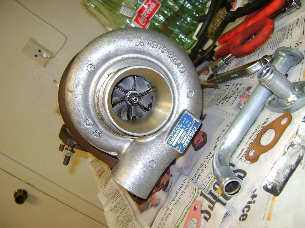

Well my 20G started smoking really bad, and i narrowed it down to the oil seals in the turbo. My BOV started to puke oil everytime it opened so i figure it HAD to be that. Well when removing it this morning removing the lower IC pipe was interesting as about a quart of oil came pouring out onto the pavement. Totally unexpected. So a local Evolution owner told me that these turbos were easy to rebuild yourself and he and others have done it many times. He linked me over to a DSM website with a how-to guide. I decided to give it a go. I was very pleased the turbo has absolutely NO shaft play. These Mitsubishi turbos sure seem to be built tough.
My Work Space

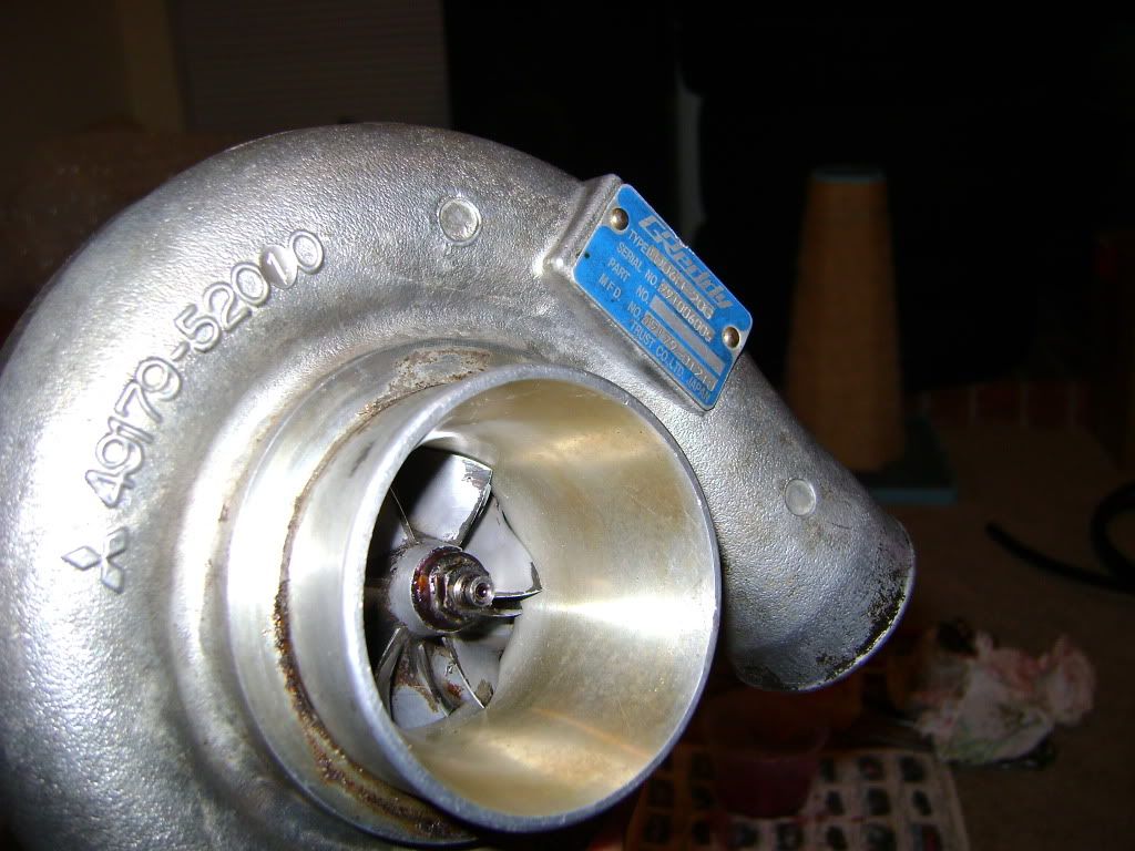

The oil seal in question
Found out its a Superback wheel model (sadly this meant the rebuild kit cost more)

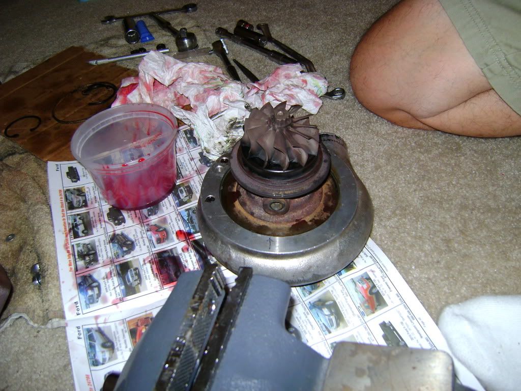

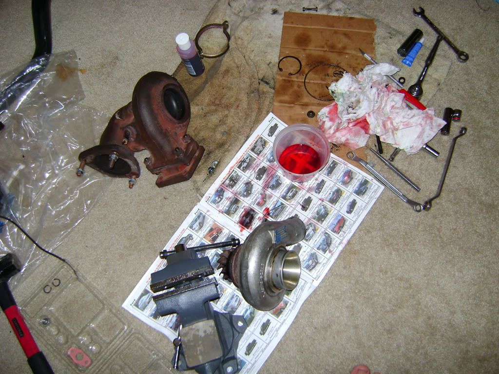

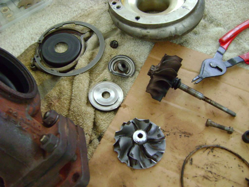

My dad and i took our time marking everything
This is quite and interesting and fun project, quite a learning experience i thought id share my progress with you as i go.

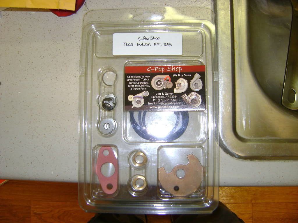

My rebuild kit should be here tomorrow, i picked up some engine assemble lube today. Im having a bit of trouble finding a 3/4" hose that can handle oil. All the transmission cooler hose i find doesnt come that big. Anyone have any suggestion?

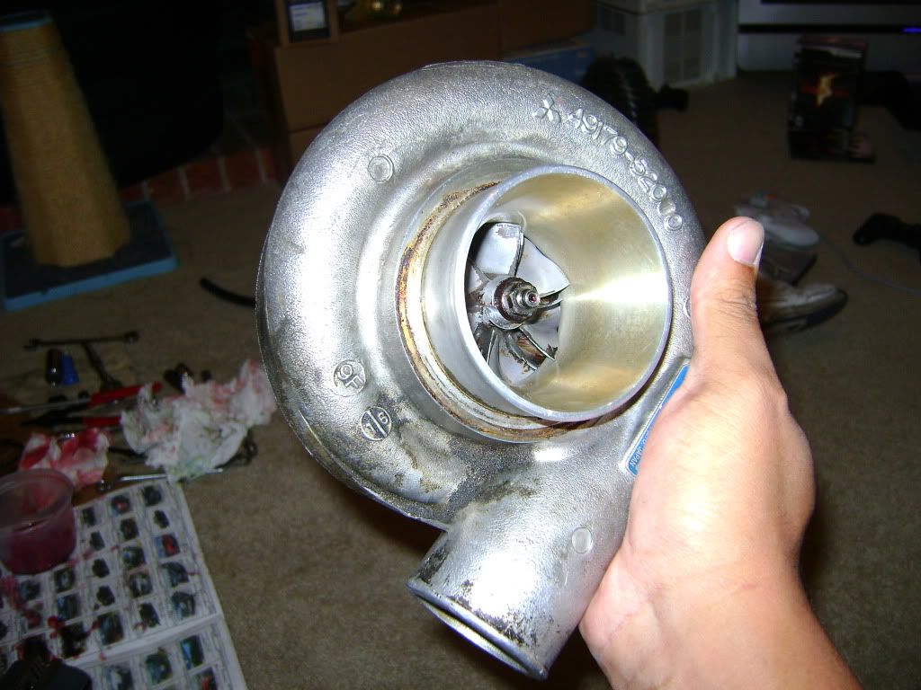

Well my dad kinda got excited and put most of it back together while i was washing his car.

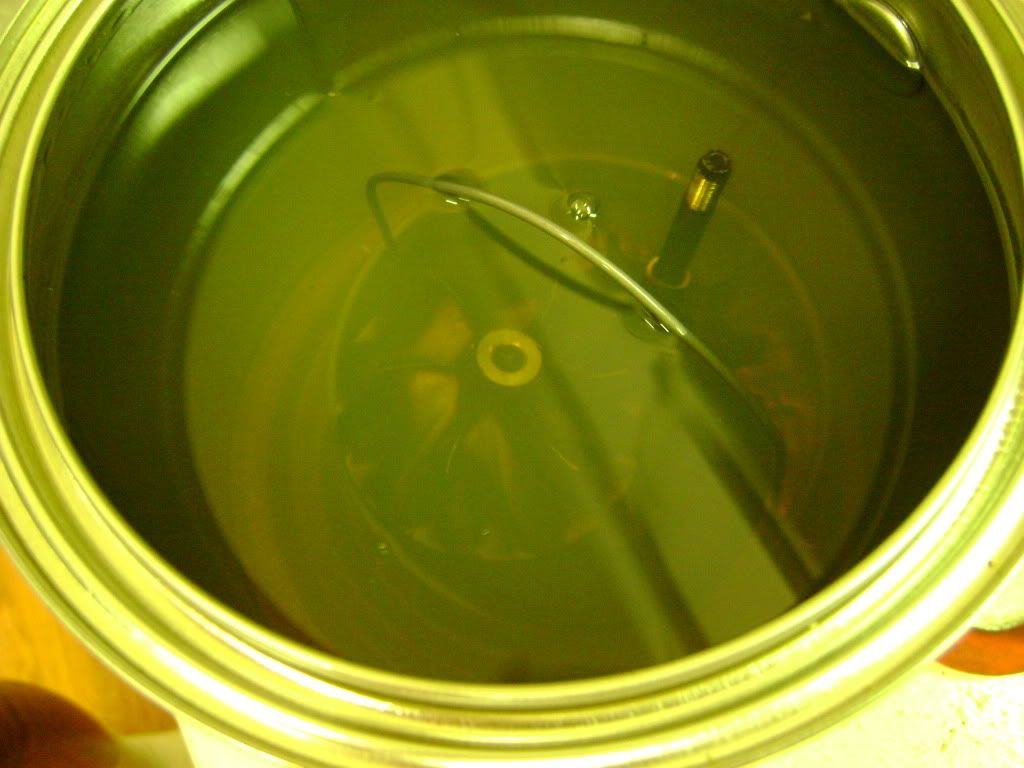

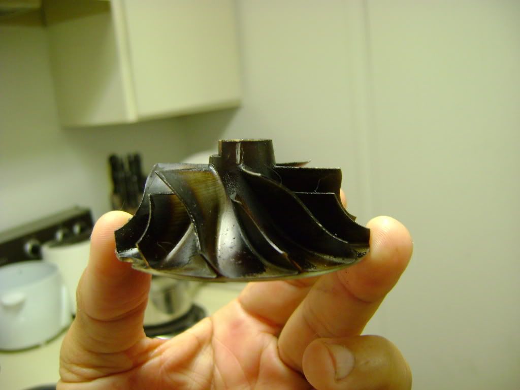

Here are some pics of the cleaning process
bought a can of carb cleaner to clean off the old varnish and what not.
heat sheild, oil splash sheild, wheel, and comrpessor wheel and shaft cleaned.
After taking a break and washing the cars i came back to find my dad on the floor and this
all it needs now is the exhaust housing back on

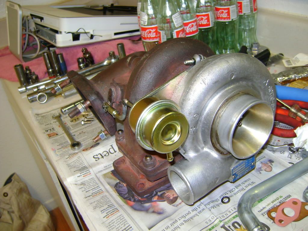

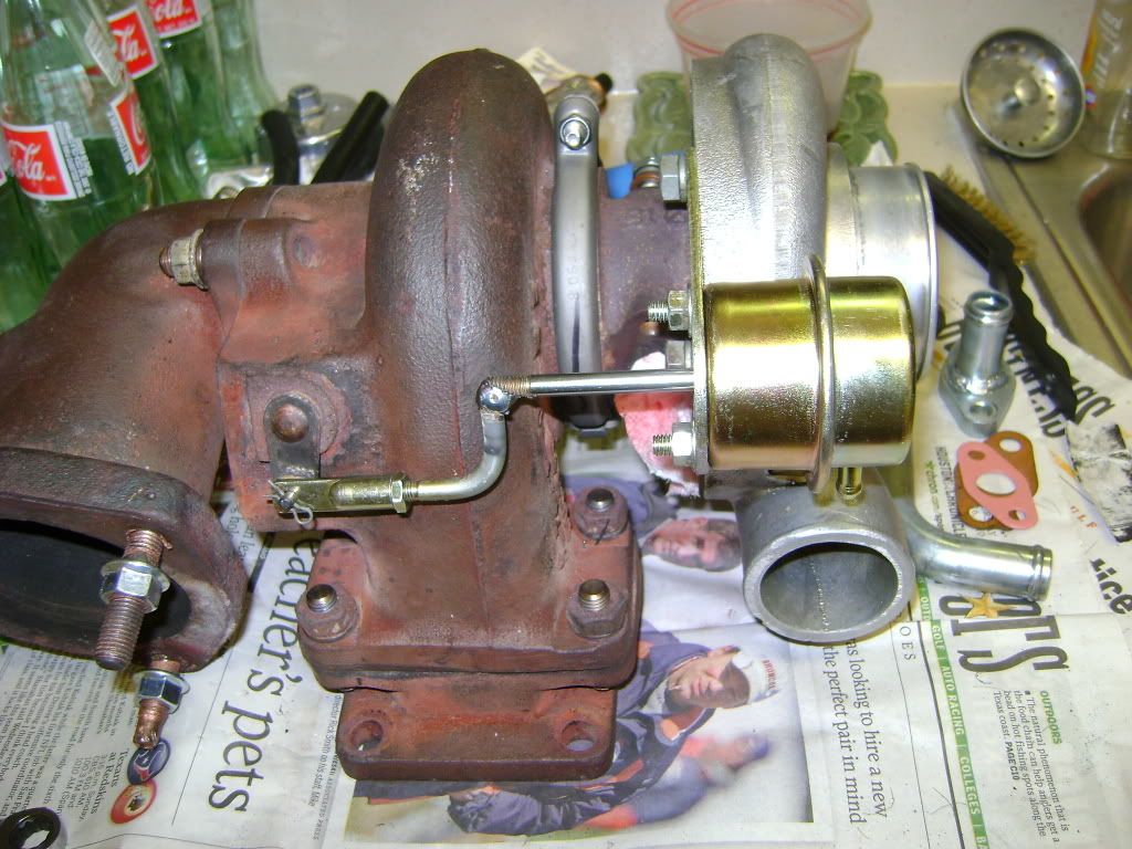

All finished just gotta get my universal wastegate fitted and she'll be back on the car.
More pics.
Got it clocked and ready to go getting the wastegate custom fitted in the morning
