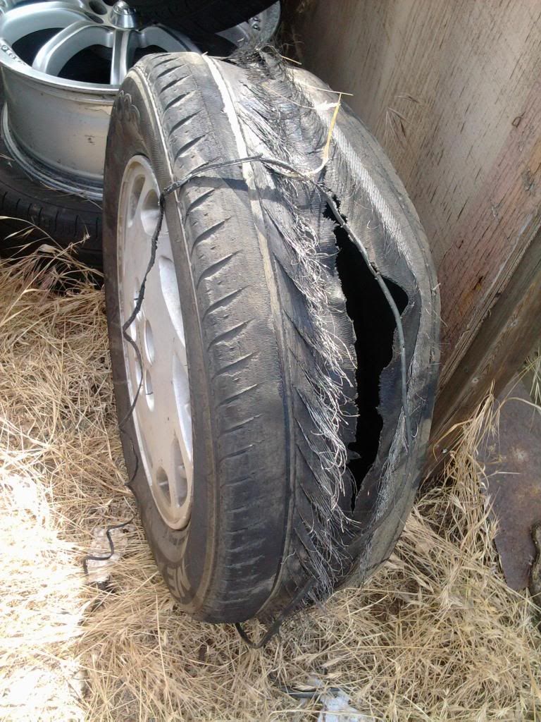

Got his soarer running solid.
It needs a new water pump no biggy but eats tires like there is no tomarrow.

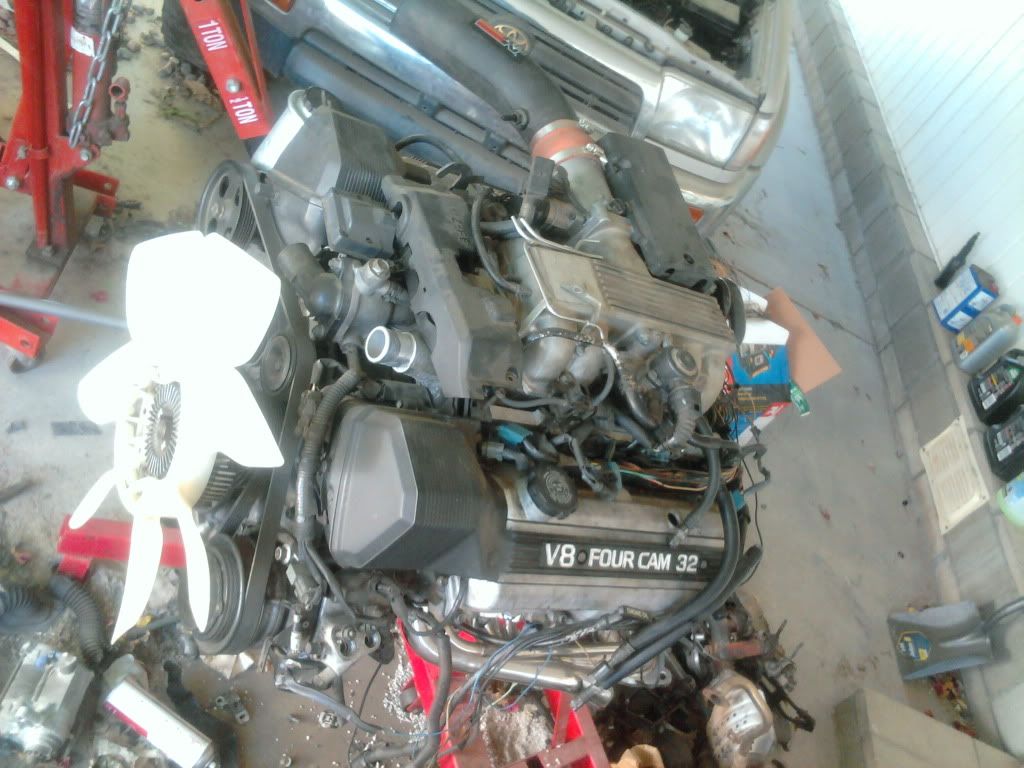

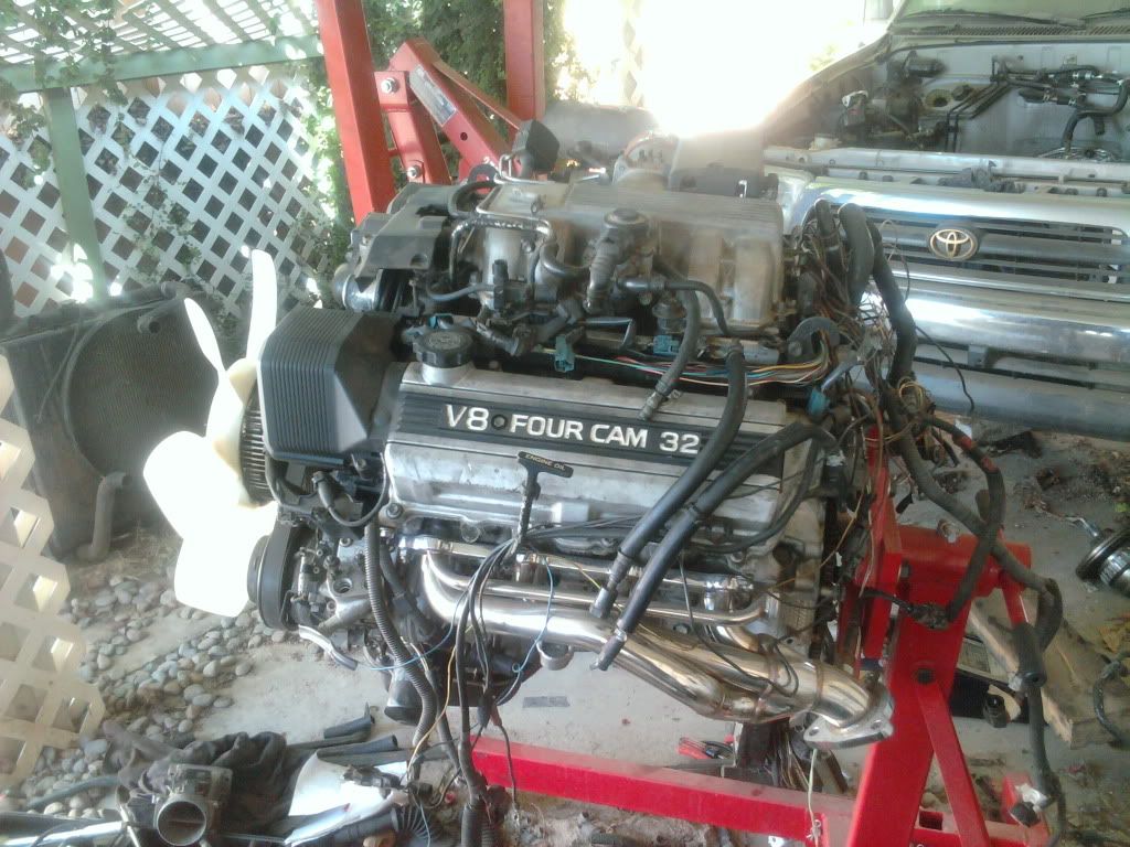

Right now I am merging technology from 2 different types of A340s into 1 adding the 4x4 controls for the 4x4 ecu into the transmission harness I am also adding the post CAT O2 sensors into the transmission harness(because SC400 runs them through the car instead of engine harness) redirecting alot of the forward junction box EFI wires to the rear body plug connectors like the 5VZ engine was.
But other then that wiring should be done shortly should be dropping the engine in soon.
Engine now haves new platnum plugs synthetic oil. Performance Stainless headers new plug wires caps rotors converted from traction control to non EGR block off mode but so that it doesnt code be feeding the same sensor through the stepper motor control but not into the intake.
Many Many mods it the works or done.

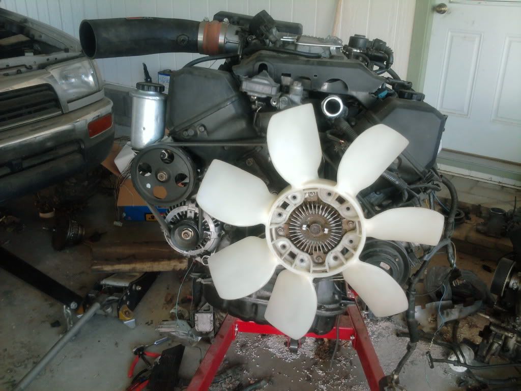

& here is the current pictures of the V8!
By the way this is the engine that should have come in the 4runners all of them!

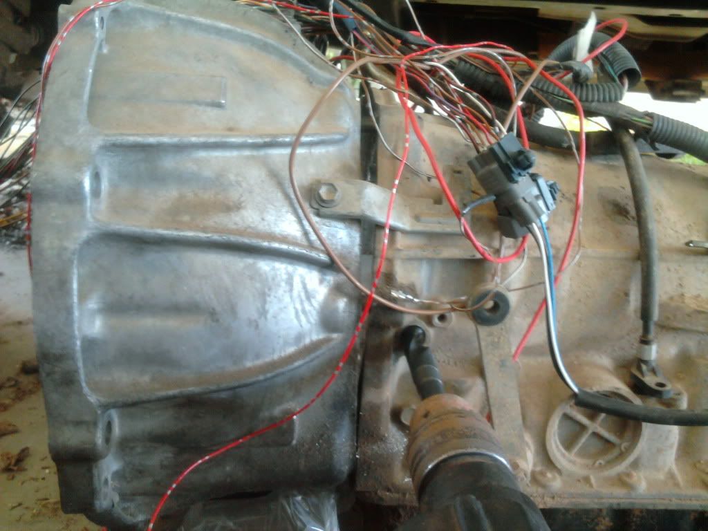

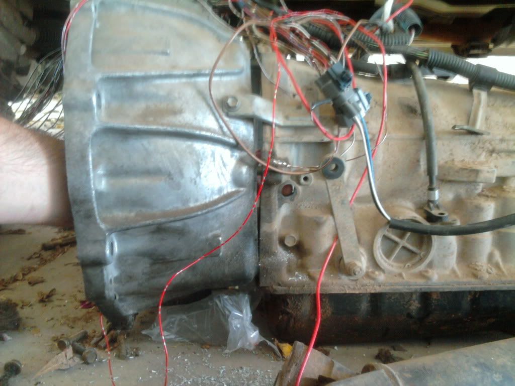

4U2QUIK;1573673 said:
there's also the a341 that comes on some of the lexus's. some of the parts off of those might be usefull to you also. I have a couple laying around if you need pix to see the differences.
I fixed one of the differences right now!
The SC400 brain looks for a clutch input speed.
The 4runner auto haves a 50% cast through hole with mounting 10mm screw hole.
I piloted the hole with a 14mm to drill it out 100% into the tranny then finished it out with a smooth factory spec 15mm for the sensor mounting/fitting/sealing.
Tada sensor is now mounted.
