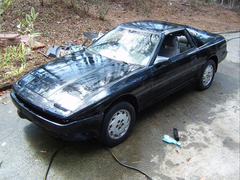

Here's some info about the car: http://www.supramania.com/forums/showthread.php?t=91913
If you don't feel like reading, here's the short and sweet:
Picked up an '87 for basically free. With sport package and targa top. No engine or trans.
There are pics in the other thread, so I'll keep it to just that one for here.
Have to file for a bonded title, but the record is clean, and the car isn't bad, who can complain? :sarcasm:
It just so happens that I have a few engines lying around, waiting for me to do something with them, as well.
Contestant number one was a 5.0 HO that I got for free. Engine was in good shape, and I figured the 210 horsepower / 270 ft/lbs of torque wouldn't be a bad match up.
Alas, it was short-lived. I had one of two choices: Either the engine clears the cross member with no problems, but sits incredibly far forward, and the engine mounts aren't remotely close. Or choice two, the engine mounts lining up, but the engine sitting about 3 inches too high. :nono: I'd need a bizarre angle to get the transmission to fit the tunnel.
Contestant number two turned out to be the winner. 305 TPI that came from my broken 1986 Trans Am. 190 horsepower, but 285 ft/lbs of torque. :naughty: With a 700R4 transmission.
So, here's that:
Engine mounts aren't nearly right, but the rest of it fits SO much better.
The hood clearance actually isn't all that bad, either. Might require a slightly modified hood, but I hope to keep it as stock looking as possible. Poor angle to truly show it, but the intake manifold is only an inch at most above the current hood line.
So, this is the beginning. I know it's not a ground breaking build or anything amazing, but I think it'll end up being a pretty fun car.
