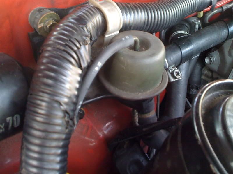

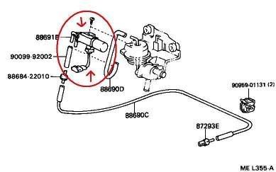

during the winter, i noticed i would have zero heat so i changed my t-stat to 180, and still no heat, so i zip tied the plunger on the vsv upward, little more heat but not much. so i completetly bypassed it. no difference with heat.

Check the VSV and make sure it is allowing coolant to get to the heater core.
A bypassed VSV. ---^
VSV - Allows vacuum to open the coolant passage to the heater core.
