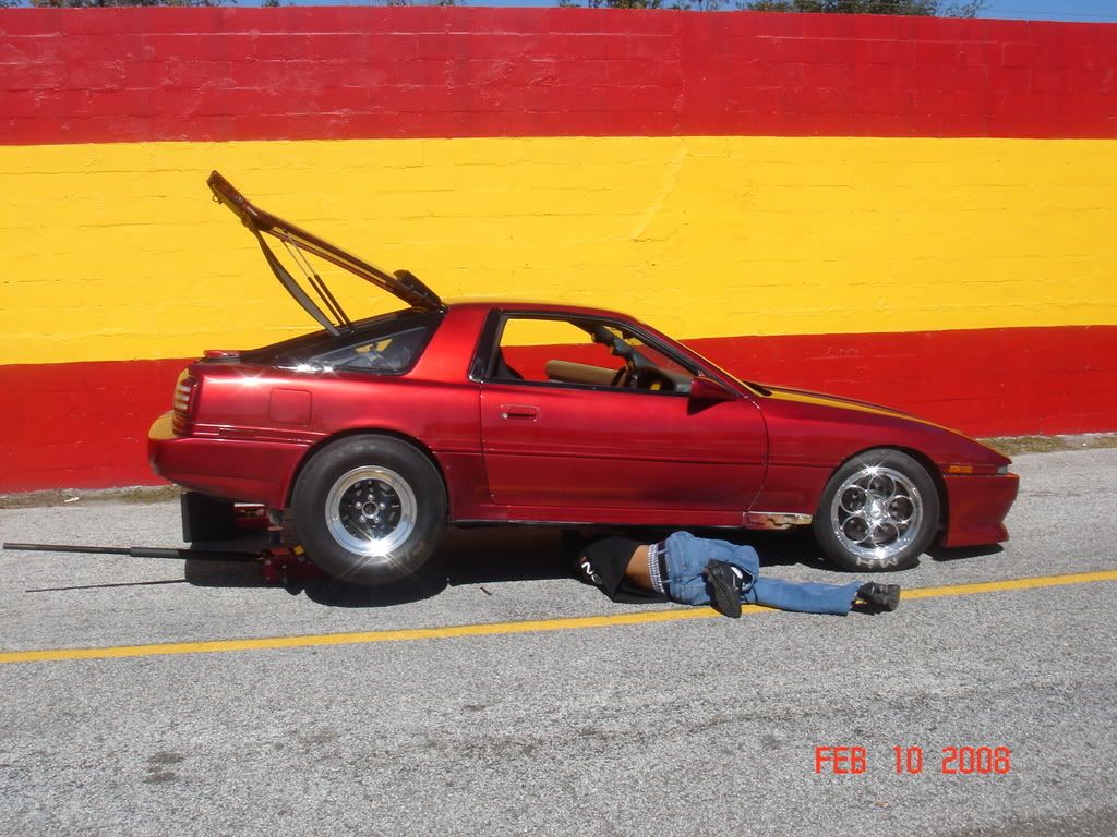

pics of the drag setup.. thanks for the pics mark...
Front Weld magnum 17x4.5 M&H tires
Rear Bogart 15x10 28x10.5x15 Mickey thompson

Slow66;917573 said:
VERY nice....How much is the car lowered? I imagine the lip is rolled quite a bit :)
the car needs to be lifted quite a bit, it was still on the 19in wheels setup.
so i have to lift it up, and roll the fenders some more.

Awesome man, what's the backspacing on the rears?? I have been wondering if a 15x10 with at least a 10" slick would fit, and how well it would. Those pics pretty much answered that.
2jzmk3
Guest
whats up guys, its a 15x10 with a 8in backspace, but i am using a 1/2 spacer with longer shank style lugs. ideally you would want a 7 1/2 in backspace with extended wheel studs which is the plan for me. just wanted to make some runs,
but i guess the sensor going out was a omen in disguise cause today when i crawled under the car to try and figure out the problem, i noticed 2 of the bolts for the driveshaft was backing out.
glad i listened to my wife and not make a pass...
only pic of the rear. let me know if you have any other questions.
