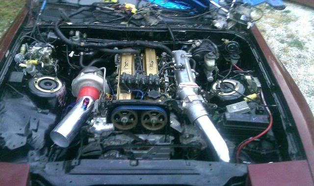

So the motor is finally done and I got it back.. slowly getting everything back on the motor, and waiting for my intercooler piping to get here. Running into a problem though. The turbo is hitting the manifold so i cant clock it down to the stock location to run the intercooler pipe down to the intercooler.. I will have to clock the turbo up, so how should i go about routing the IC piping from the turbo to the intercooler?? anyone have suggestions or pictures of a setup that has routed the IC piping differently?
Here are some pictures of the motor:

made some progress this past weekend... finally got the motor put in the car and started reconnecting everything.. slow process, having to re-wire a bunch of stuff, and lengthen some plug wires. here is a somewhat current picture. got some other stuff installed after this picture was taken, but it was dark by then so couldnt take a picture with my phone..
