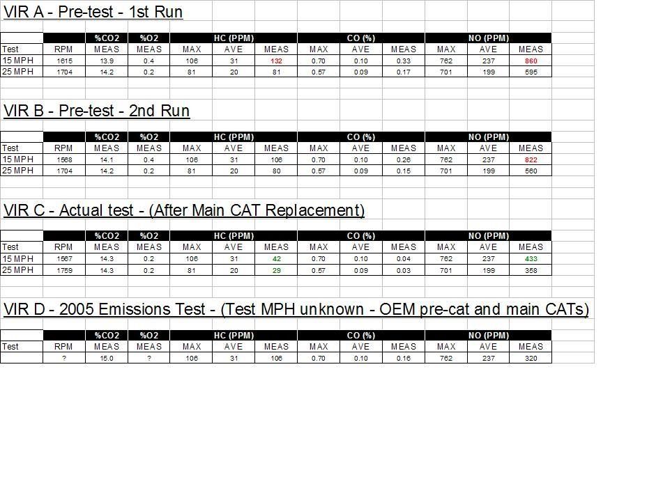

See the image below for details of the Smog Check Vehicle Inspection Reports:
VIR A - My first pre-test run. Obviously failed.
VIR B - My second pre-test run. Better, but still failed. The smog tech warmed the car up a little more on the dyno before making another attempt.
At this point the tech recommended a new CAT.
VIR C - My first run with the new CAT. PASS!
VIR D - I dug this up from archives and added it just for the sake of comparison. I cannot find the initial change of ownership smog check data.
