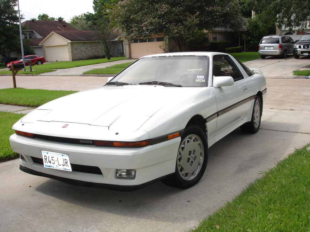

This is my dads old car he got it back in 97 and I took it from him my junior year of high school. Now I'm in my sophomore year of college without a car lol. Its a 87 turbo pearl white burgundy interior.
Things that have been done before are HKS catback, K&N are filter, hardpipe kit, hoses were replaced over the summer and the rest of them are getting done now

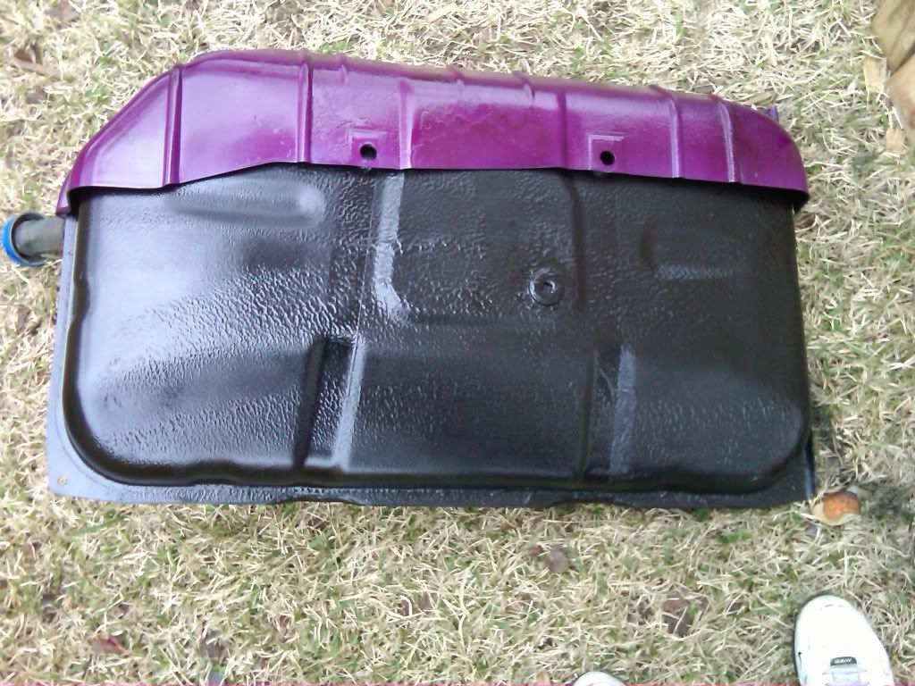

Dropped the tank and changed the fuel pump(wont ever see the purple so dont hate :icon_bigg)

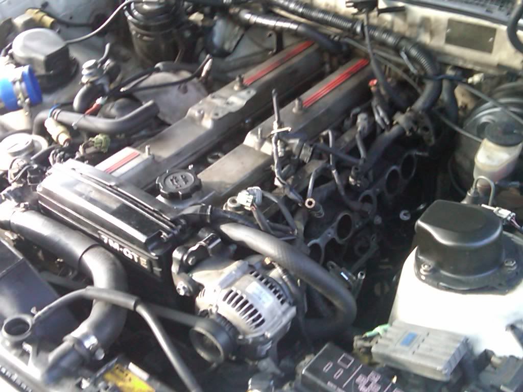

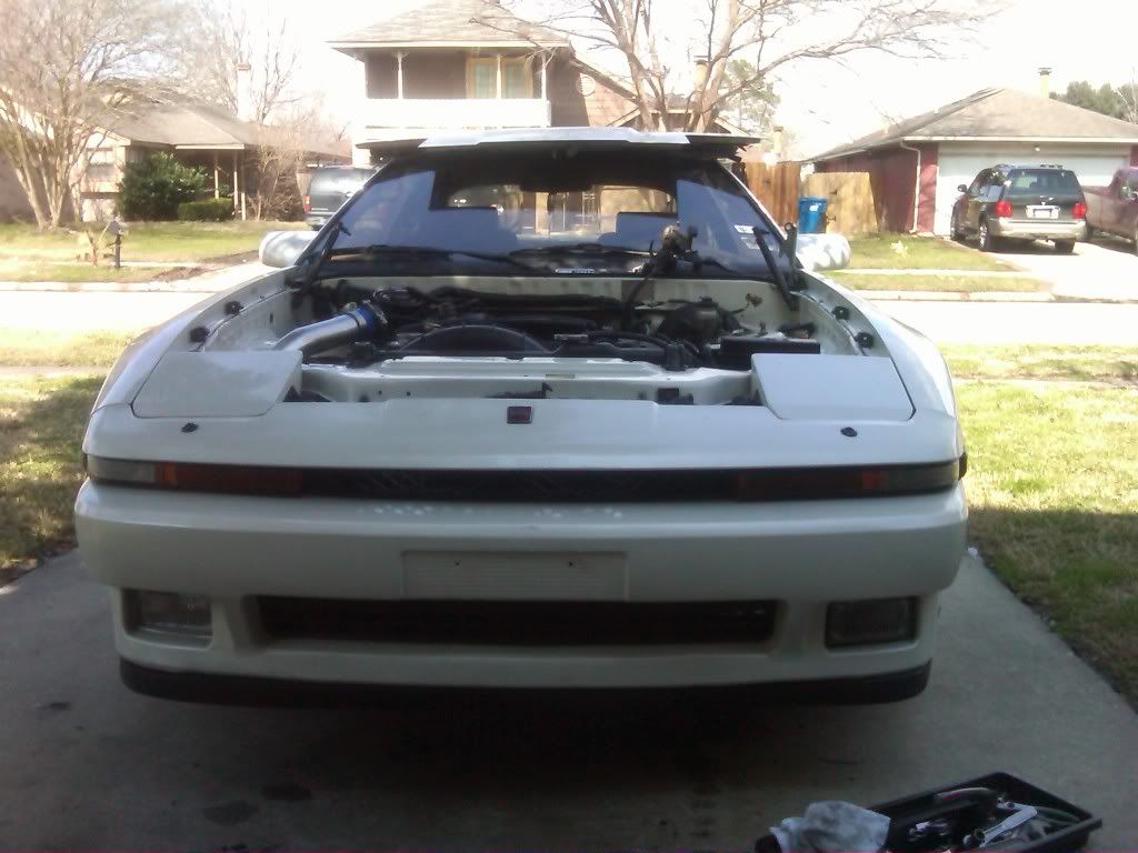

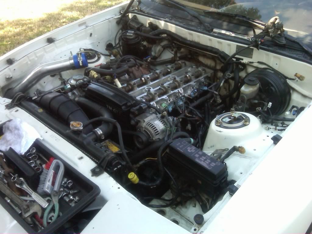

Then i moved on to the engine and decided to replace most of the gaskets and replace all the vac lines
(unfortunately i never got a pic from the starting point)
Tried cleaning up the engine bay it was pretty bad

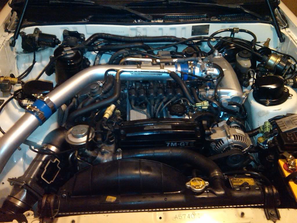

Time for an update. I started putting it back together got the gas tank in and connected and started bolting everything back on the head. The EGR is in a ridiculous spot i guess i just dont have the right tool but it took me all day to tighten it up. I ended up using the fuel rail that i kinda messed up I just have to wait and see and hope that the fpr doesnt leak fuel. As long as everything thing works it should be running tomorrow.
Thats what it looks like right now I just need to clean up some oil stains and fill her up with gas. I'll post some real pictures tomorrow after i clean it up.
