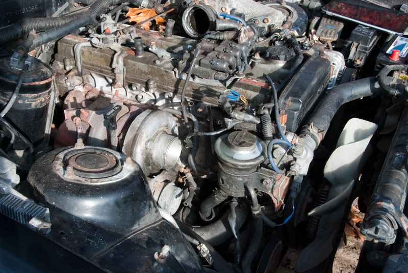

I did some cleaning and inspecting today. All of the lights came on after I dropped in a new battery. Change of oil and more inspecting tomorrow.
Now for some pics from today:

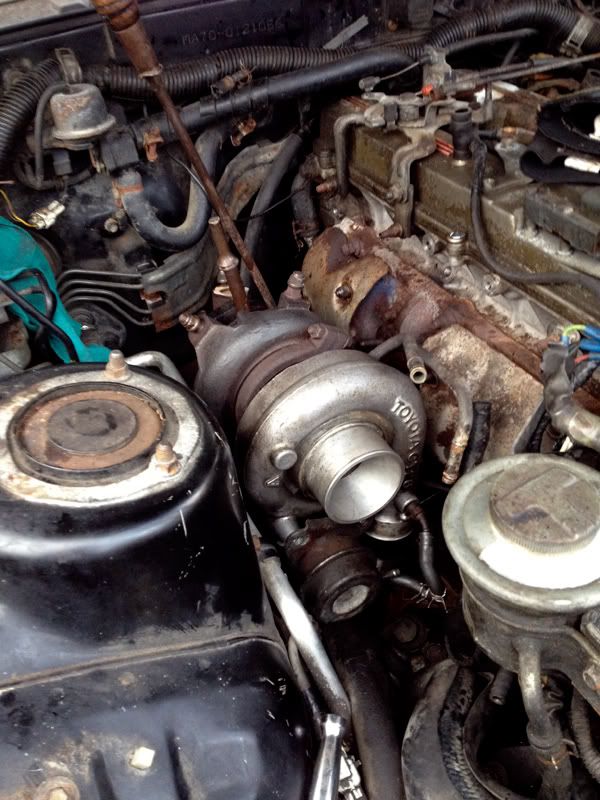

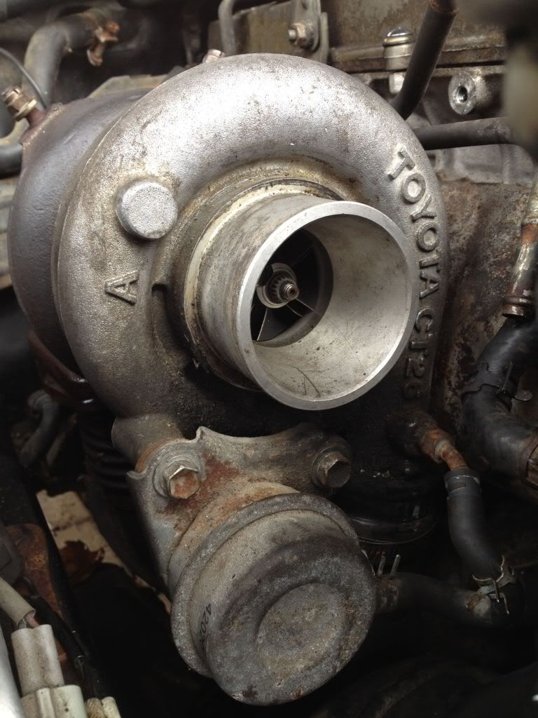

Ok so pulling the IC pipes, accordion hose and 3000 pipe shows a fair amount of oil in the piping.
I guess that's proof the seals are bad in the turbo.
Removing these bolts is a pain.
Anybody have good suggestions? The elbow and manifold nuts are rusted on.

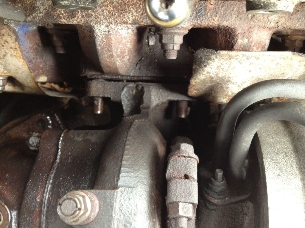

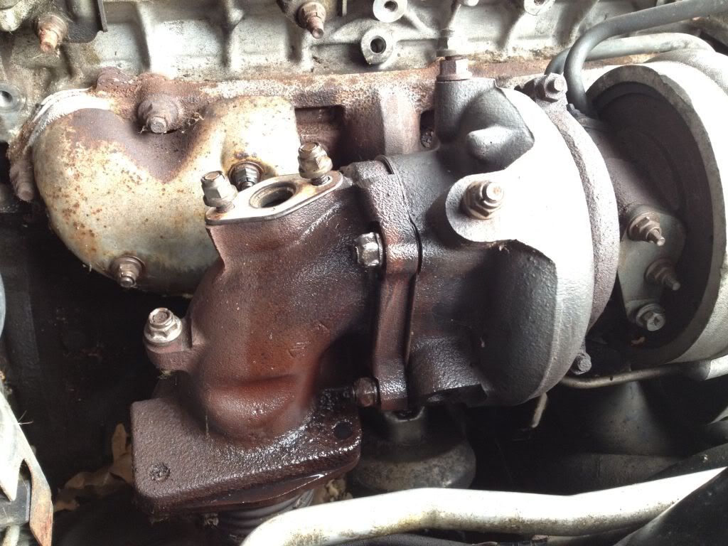

Hey turbo, why won't you come out?
These 4 nuts on the elbow? Please. That's all that's holding you in still? PB Blast is soaking in...
The ones on the manifold already came off and those were a pain to get at.
To be continued...

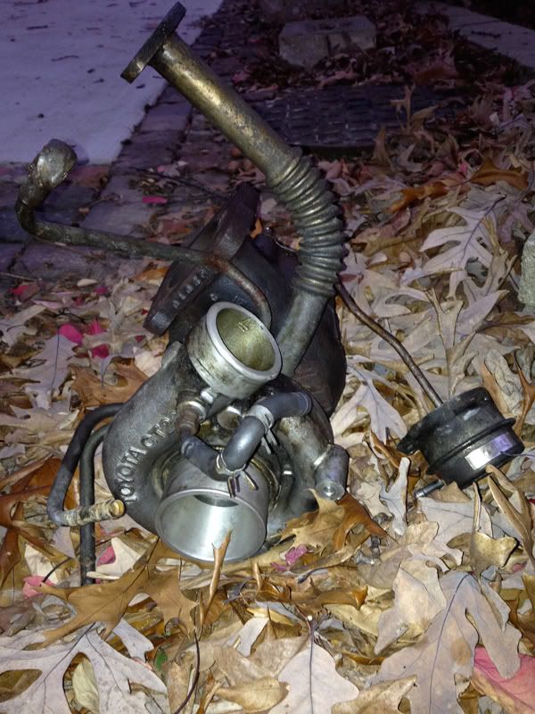

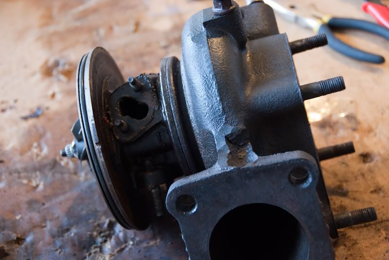

well small update.
Last weekend, a friend came by and we borrowed my neighbor's torch. Heat helped get those last two nuts off.
But, I still had the oil feed lines to remove from the engine block, then pry the exhaust side of the turbo away from the turbo elbow.
Luckily, I was successful right before the sun went down.
Turbo is out.

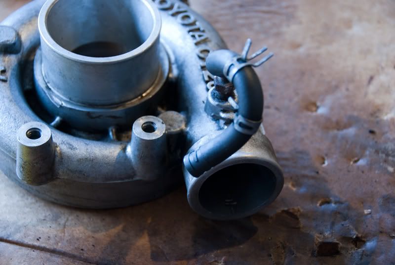

This weekend, I spent too much time trying to remove the turbine housing from the center. Looks like I'm going to have to pay a visit to a mechanic who can heat it up. I've tried about every technique I've seen online but it's fused pretty good. I guess the shape of the nuts on the elbow were a sure sign how much trouble I'd have taking the turbo apart.
