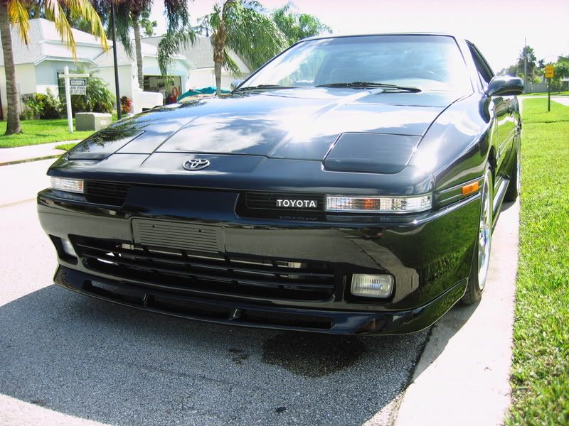

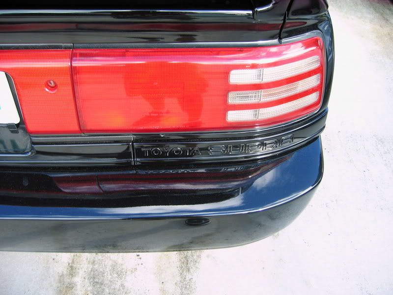

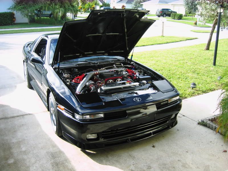

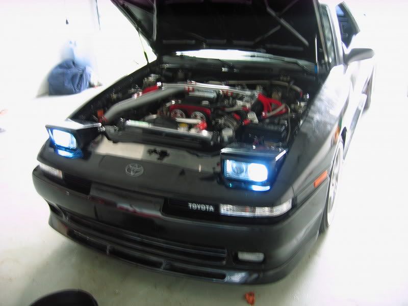

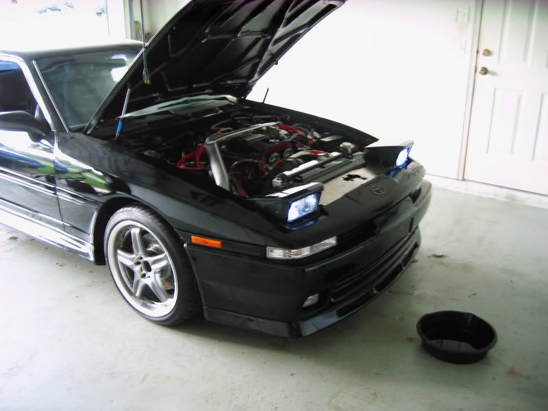

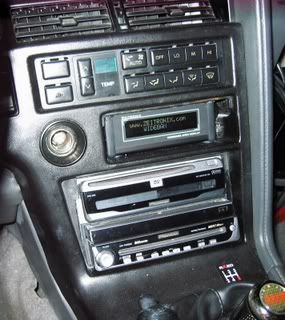

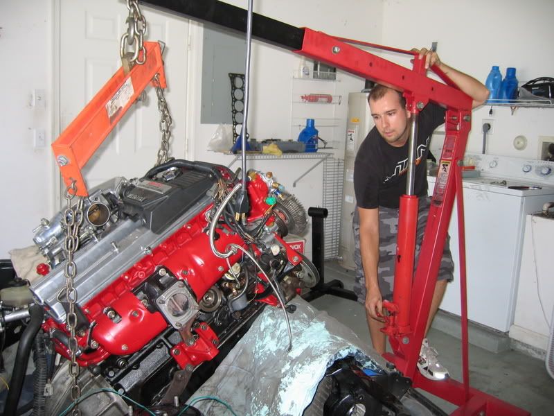

I don't post here much but I thought I'd share some pictures of my car I took mostly today. Here is a list of everything I've done the past 12 months. I've been busy. What do you think?
1990 Grand National Black SP61 Turbo Supra
Unabridged Modification List:

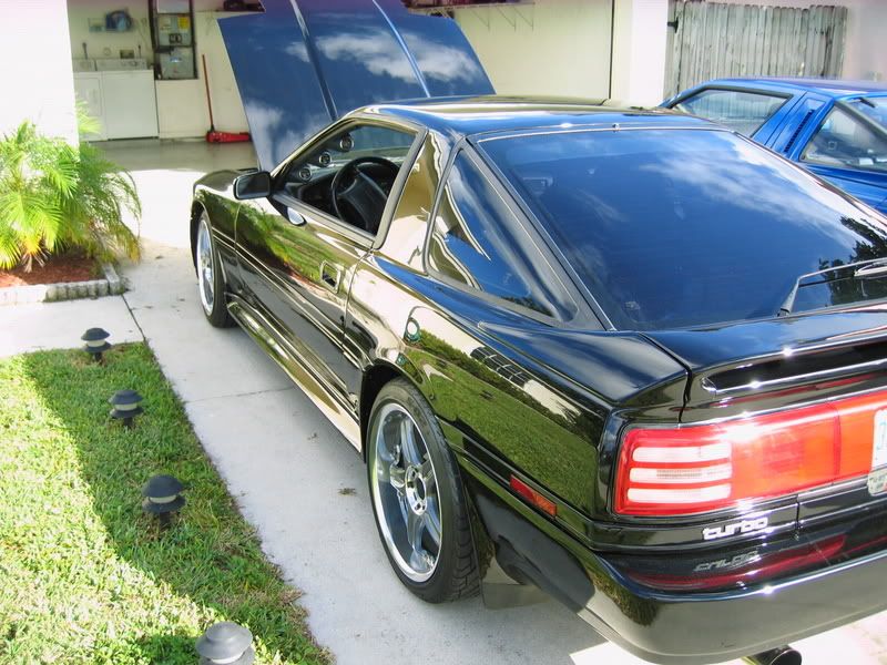

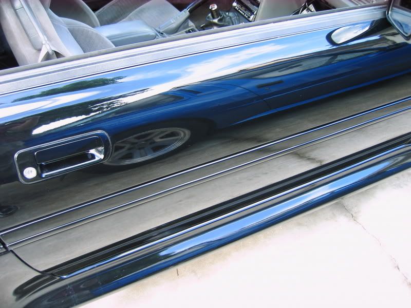

Body:
fresh Buick Grand National black paint (wetsanded, zero scratches, zero dents, never seen rain)
Kaminari fiberglass side skirts
Bomex replica fiberglass lip (Yasar)
paint matched body moldings

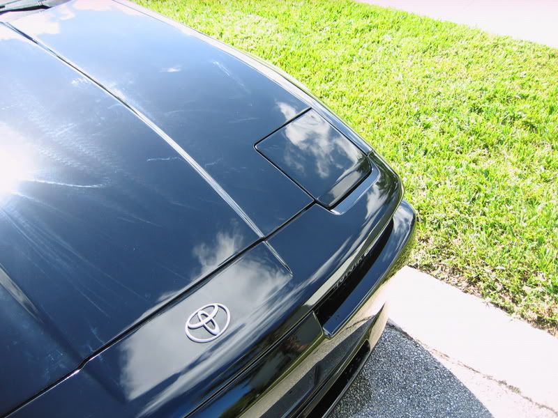

Filled in front nose logo and replace with Camry logo painted gray
painted rear turbo badge gray

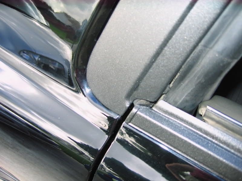

texturized and black painted window trim
window tint
Lighting:
NSX headlights (engineered by me)
HID kit
clear turn signals with orange bulbs

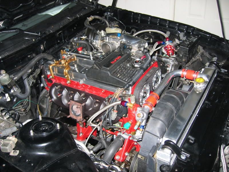

Turbo:
Sound Preformance 61 .70 A/R (polished cold side) (upgraded thrust bearing)
Tial 38mm external wastegate

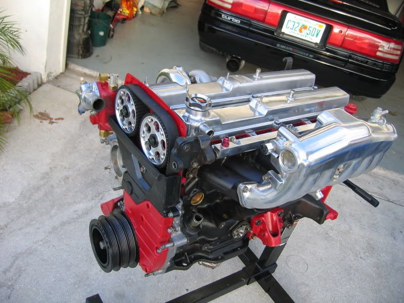

Head:
Jarco rebuilt
2mm HKS stopper headgasket
Fidanza Adjustable cam gears
ARP head bolts at 90ft/lb
LIPP spark plug valley cover
Polished valve covers
TRD oil cap
NGK plugs

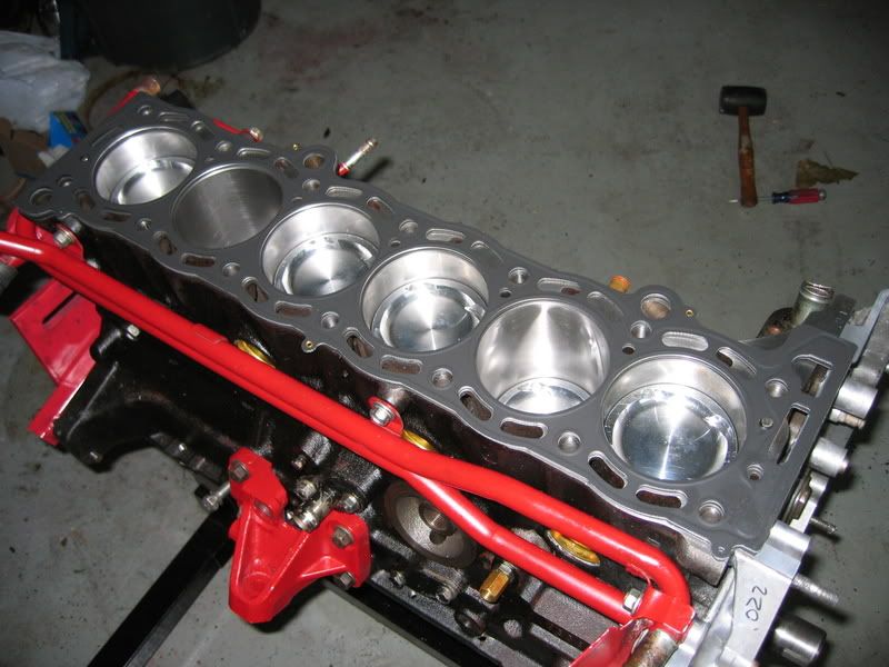

Bottom End:
20 over bore with torque plate
JE pistons
Eagle rods
ARP rod bolts
Kings bearings at 0.025mm oil clearance
custom oil pump hard line
new oil squirters
ARP studs at 80ft/lb
polished crank
Spec stage 3 clutch
solid motor mounts
Transmission:
Stock R154
short shifter
Razo shift knob
Redline MT-90

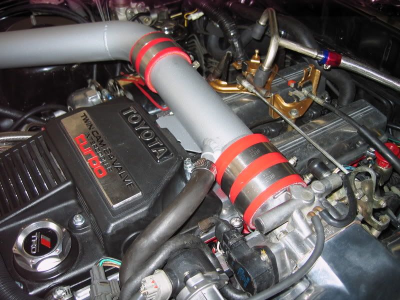

Intake:
Custom cold air intake duct (designed by me)
Filter stainless heat shield
Lexus AFM
Horsepowerfreaks 24"x12" Intercooler
powercoated 2.5" hard pipes
Greddy Blacktop blow off valve
polished stock intake manifold
custom ISC to 3000 pipe
Greddy style catch can
NA pcv pipe
Cooling:
Fluidyne radiator
Stainless overflow Tank
Stainless upper piping
Polished thermostat housing
MK2 lower radiator hose
Exhaust:
Stock ported exhaust manifold
3" powercoated custom downpipe
0.75" wastegate dump tube
3" Blitz Nur-Spec exhaust
3" catalytic converter

Zeintrix wideband with LCD screen and EGT (mounted indash)

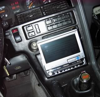

Stereo:
Pioneer AVH-P6400 CD player with 6.5" monitor
Pioneer AVIC-90DVD GPS Navigiation/DVD player
custom fit 5.25" 5002I Infinity
Wheels:
Volk GTC gunmetal 18"X9" (front)
Volk GTC gunmetal 18"X10" (rear)
Falken Ziex ZE512 235/40ZR18 (front)
Bridgestone S-02 265/35ZR18 (rear)
