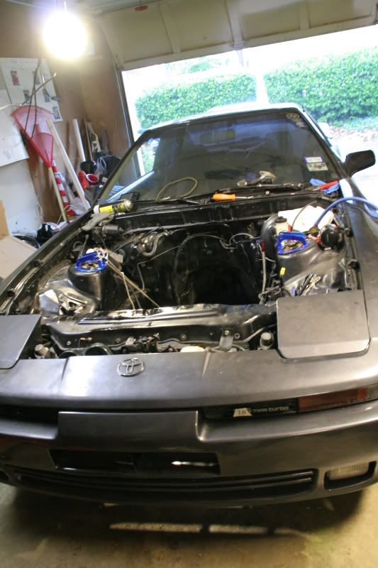

car swap is being performed on

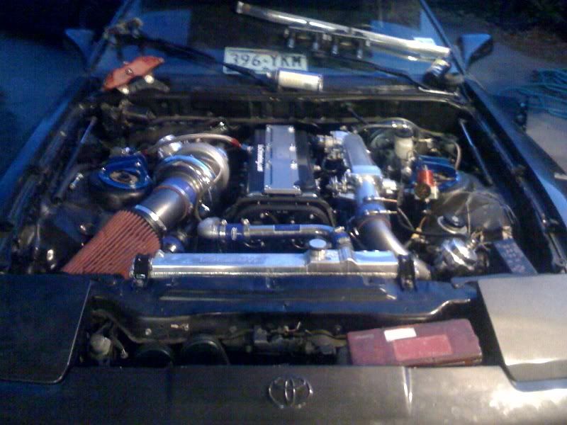

1JZ before going away, just had gotten everything powercoated by RBCoating

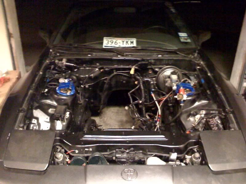

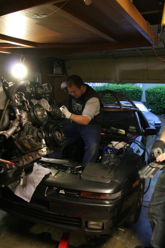

pics during motor pull

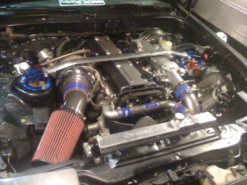

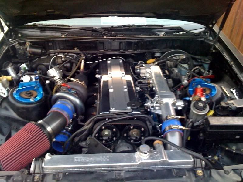

then i got some really bad new on the build, my turbo was shot, horrible lateral shaft play, i loved that turbo, had a good amount of money into it between powercoating, ceramic coating, and the anti-surge.
so that really put a hamper on the car, also kept it from making it to 2K9, couldnt source out a turbo that would match up within the week that we had to finish and go to 2K9 in.

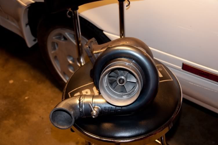

Got a T88-34D with hardly any use on it from a Local guy. He made 902whp on it and trapped 10.001 @ 147mph, then took it off and went bigger.
Had a few problems with it tho
1. oil lines didnt fit
2. DP had wrong flange and wasnt long enough.
friends spare oil drain fit it though, and dynosaur performance had the right oil line in stock for me.

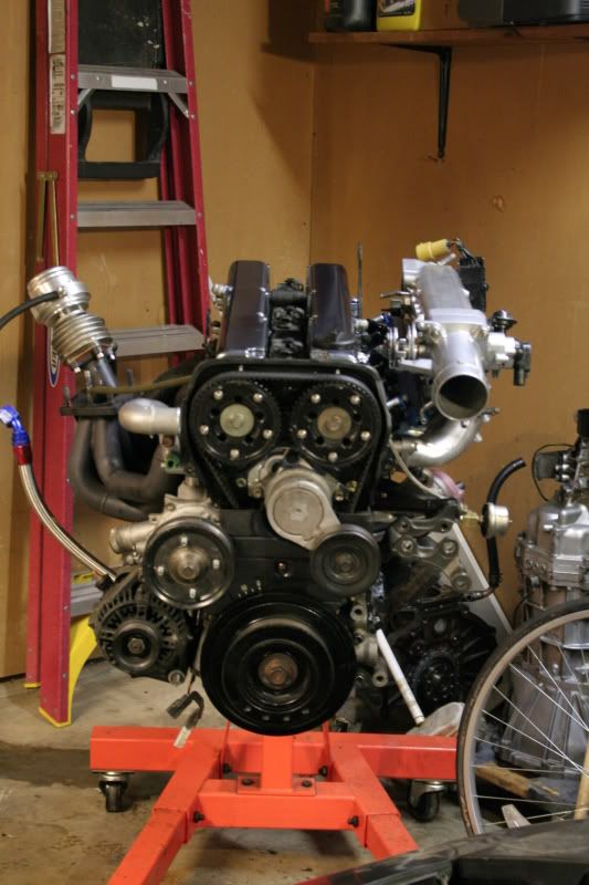

pic of the motor back together and going back in, thats me on the cowl, i was tired and ready for it to get back in.

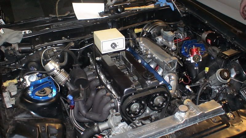

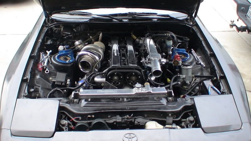

Motor back in with new turbo mocked up

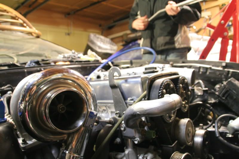

fast forward about a week. most of the motor is assembled with the old i/c piping setup
heres with the changed/new i/c piping routing.

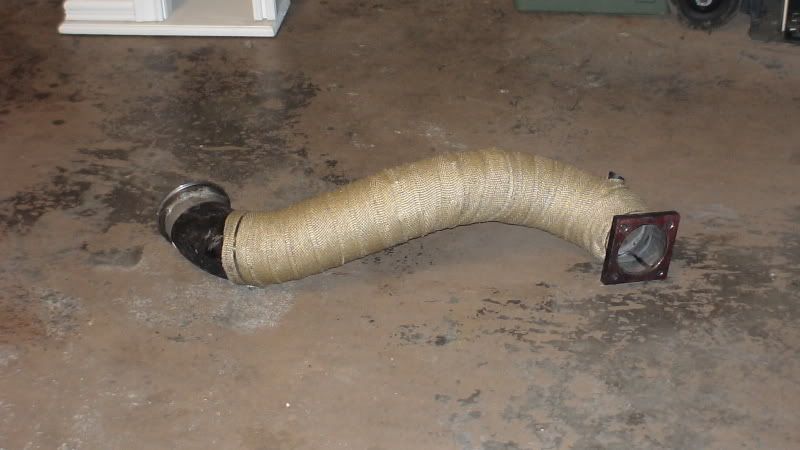

time for exhaust/dp. decided if im gonna make my own exhaust and dp again, might as well go big, 4" all the way.
exhaust not finished in the pic, has a 2nd v-band downstream and flex pipe.

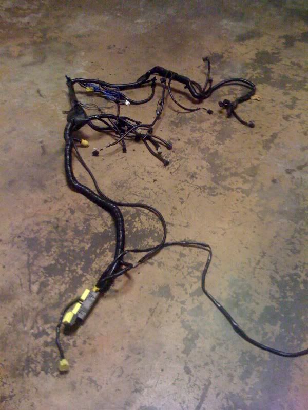

also got the harness adapted for the car, was able to get rid of a shit ton of wiring and connectors in the process

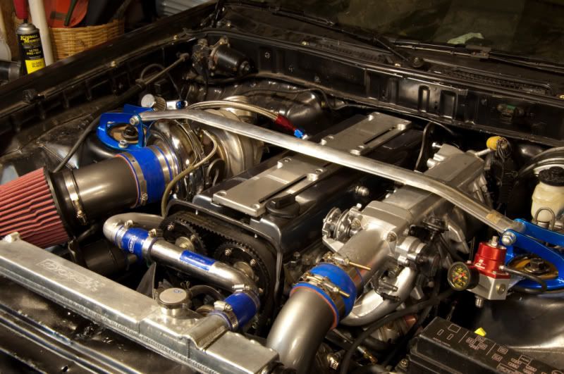

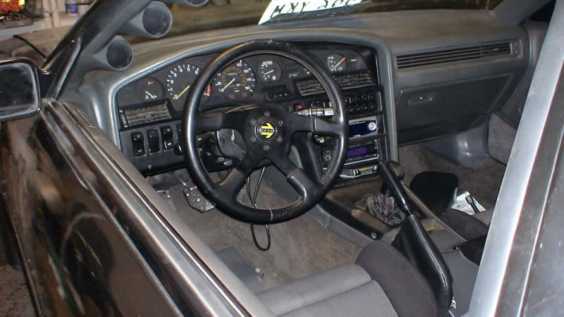

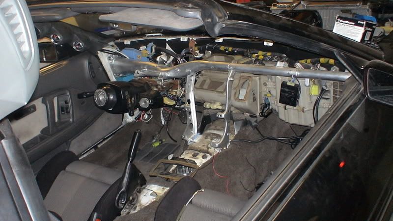

Fast forward to today, talked with OS Giken about the issues im having with the clutch, and it turns out i have the wrong sized release sleeve bearing. I have the single/twin plate one. and it does not work on the triple, as ive found out. cant get the bastard into gear. so i started to take the motor down to pull it to fix it this coming weekend.
and heres the interior re-assembled
thats it for today, probably take it down more tomorrow just so i can pull it easily come saturday.
