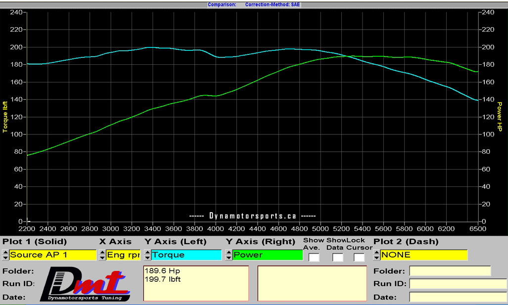

189.6Hp
199.7lbft of torque!!! needless to say I am happy. I have exceeded my expectations with this 7mge project.
I went in with a peak hp of 178hp. 10 or so runs later and I had my peak number. Initially, I reduced the timing two degrees (to 10 degrees) as the motor was pinging at low rpm. I actually picked up about 1.5hp from this. 6 runs later and I had the cam gears dialed in...finally settling at -4Ex and 0 intake. The SAFC worked perfectly to adjust the A/F ratio and I got it to hovering between 12.5 and 13:1.
the car feels fantastic! I am very happy. Power gains were solid all across the powerband and I gained 18hp at 4000rpm (very nice to cruise now) and a whopping 23hp at redline! I did not lose ANY power from the cam gear adjustments, nor did I move the powerband at all, it truely did increase power across the whole rev range. It was really neat to see the A/F ratio change too as I got more power out of it via the cam gear adjustments...it was definitely burning more fuel! I didn't need to do much safc work to get it where I wanted.
the car pulls excellently throughout the rev range now...look at that torque curve! it sounds great and smooth (as you can tell in the video) with no smoke!

Weather: 16 Degrees celcius, 94% relative humidity. 99.58Kpa
The Best Run:

Mr.PFloyd;1355705 said:
Nice steve. So how did Tony treat ya :D
excellent! he gave me some advice for the cam adjustments and showed me how to use the safc properly. he was invaluable. I should have paid him more, really.
that acis certainly isn't a gimic. That early torque peak is very nice on the highway, right where my car cruises.

IJ.;1356511 said:
Nice job Steve!
ACIS's looks a little slow reacting (my understanding is there shouldn't be a dip when it's right)
thanks, IJ. sounds even better coming from you!
that's interesting about the acis. I didn't know that, I'll inspect the system the next chance I get.

AJ'S 88NA;1356521 said:
Nice Steve, keep at it,very close to that 200 mark. What were your AFR's?
they were pretty good actually. it was around 11.5 when I started. as I made adjustments to the cam gears power increased across the whole rev range and the AFR curve moved up to around 12.0:1. It was neat to see this happen as it confirmed the motor was being more efficient with the fuel it was dumping in.
once the cams were dialed in, I went to the safc. The motor needed no adjustments below 3500rpm. when I finished I had -10% adjustment on on the safc at peak power which carried that to redline. Just a gentle scale up to that adjustment point from 3500-4500.
interesting enough is at one point I did go even more aggressive with the fuel to around 13:1 but the car didn't make anymore power at all, so we turned it down for some safety margin
final air fuel ratio was relatively flat, hovering around 12.5:1 area, never getting leaner than 13:1. Unfortunately, I didn't take a picture in all the excitement.
