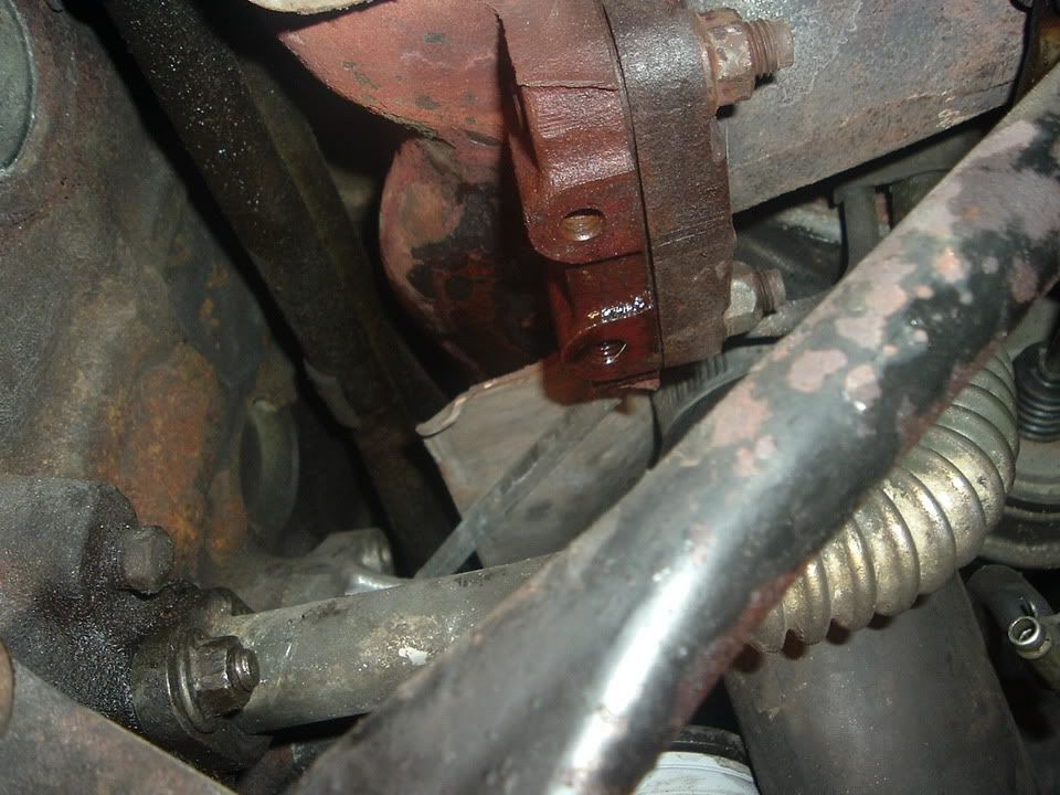

last week i started the car again and investigated since i ahd finally come across some time to invest into the car. after running the car and watching it smoke after a minute of running i noticed a wet spot on the flange where the turbo bolts up to the manifold.

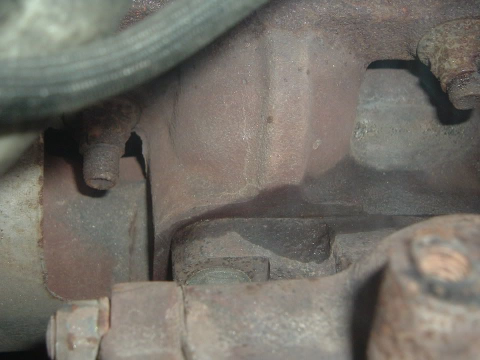

so i i took a trip to daves and he gave me that gasket and a few others i didn't put on (manifold to motor and o2 housing gasket). i removed the ic piping and the acordian and downpipe and everything necessary to pull the turbo and i noticed this while i was under the car as i pulled the down pipe..
so i was pretty sure this gasket was the problem. while removing the turbo i noticed that 2 of the 4 bolts were darn near hand tight!.. i just loved that (take the sarcasm). so i pulled the turbo and took at look at the origional gasket and sure enough it was cracked from where it meets the center of the flange to the top. not to mention my turbo wasn't even on my manifold tight. so i put that gasket on and bolted everything back up. as i was finished i decided to check the bolts on the manifold too (im a retard since i could ahve done it much easier having the turbo off) but i ran my 14mm wrence across them and sure enough iw as able to righten all of them. so then i ran the car and it was great. its still running perfect but i notice on short trips i get a little smoke. the smoke comes from the front of the motor and it seems to eb comming from the manifold right where the cam position sensor is located. could this jsut be oil dripping fmor my cam position sensor because it does have a bad seal and i just never got around to replacing it. would that cause a little bit of oil on short drives? if tis not that could it be the front bolt on the manifold not tight? one other thing that came to mind is my oil feed not being tight enough or could my valve cover gasket be bad? any imput would be great and im just not sure what to check or look for. please suggest any other possible ways this thing can be smoking.

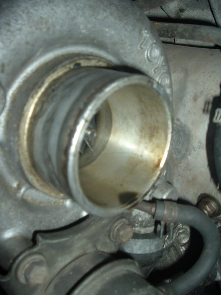

since the motor swap i can hear my turbo very well (stock ct-26). i can hear it spool and wind down and i noticed a bit of oil in my ic piping when i removed it. i know tis normal for turbo cars to consume oil but isn't it a bad thing to see oil in the ic piping?
theres a little dab of oil right there. there was a bit of shaft play when i checkd while the turbo was off. is that normal or bad for a turbo with about 65k on it?
