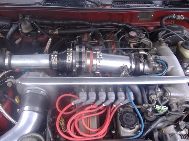

Here's a pic of what I'm doing. I just wish I could remember who's set up this is to give them credit.
I cannot find the thread this pic came from, but if I'm not mistaken, he had no problems w/ heatsoak.

midniterider said:
nice...but y ur plug wires so long madsupra??
Those wires are long because i plan on mounting the coils on the firewall, and i will shorten them to make them perfect, just had to get extra long ones so i have room to cut :D

you're planning to cut your ignition cables? uhh..
i've never heard of that..wont that mess with the resistances and shit? someone fill me in here.
theKnifeArtist
Fire on High!
Apr 6, 2006
2,332
North Jersey
no i havent, guess thats why. just seemed weird to me cuz i thought changing the length of the cables by buying aftermarket cables that weren't the same size would mess with your ignition pattern, so cutting them just totally threw me off

when the coil pack is relocated to wherever it is he's putting it, they should be pretty close to the stock sized wires, some people will even use a wire set for the NA (like 8.5mm MSD's) cuz they are a longer. To my knowlege no one has had problems with the wires being too long so far. Ever seen how long a plug wire is on a mustang 5.0? ;)

I'm not saying it's ok, I'm just saying that the people who have lengthened the wires so far haven't had any issues unless they were DIY wires and not done correctly (I plan on relocating my coil pack too BTW since I got a nice set of chrome ceramic coated NA valve covers ;)).

Lol ^^ that was the first day my car left the garage after the build, i wanted to drive it so bad that i looked everywhere in my basement and found bunch of clamps and made them work. ofcourse a week later they where all changed, butt then decided to go bigger :D
