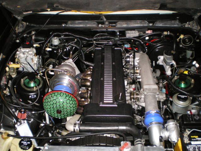

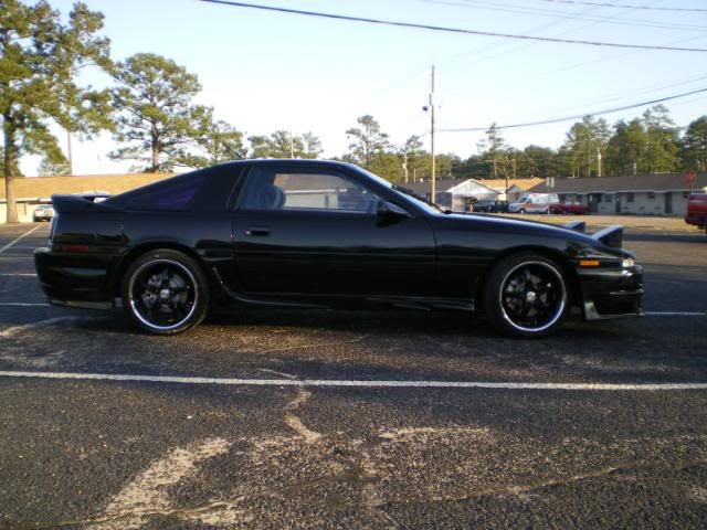

My Sup is finally back together took some mo pics, car was dirty though.

The wheels are 18" Tork. The interiors been white since 2000, so it's not a problem. The turbo is a 60 trim, and the other .4% is getting my fuel problem fixed.
macjac69
Feb 5, 2007
274
Mississippi
It has normal lag, not ball bearing though I wish..
E-bay manifold
No spray just a 10" sub!
Mod list:
Spec clutch stage 3
Tanabe Hyper medallion exhaust
Tanabe sway bars
Turbonetics T3/T4 60-1
Stainless manifold
HKS blowoff valve
FMIC
custom IC piping
Apexi-neo
Apexi BC
Apexi- TT
550CC blitz injectors
Axxis pads
drilled/slotted rotors
Tein efdc
tein flexx coilovers
Koyo rad
HKS 44mm wastegate
Walbro fuel pump
Prosport Gauges
AEM UEGO
Sony Head unit w/I-pod control
Pioneer digital signal processor (old skool)
Polk audio component speakers front/rear
Pioneer amps
Pioneer Sub
Corbeau safety belts
6000K HIDS
Momo steering wheel w/detach
Momo pedals

what are you boosting and when do you get max spool ? :) i have the 62-1 i get 1 bar at around 2.8k rpm but its ball bearing.
and also are you surging at all with the hks? i still get some
