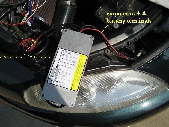

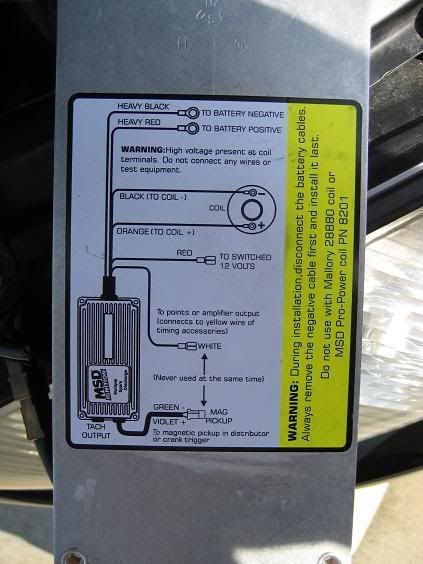

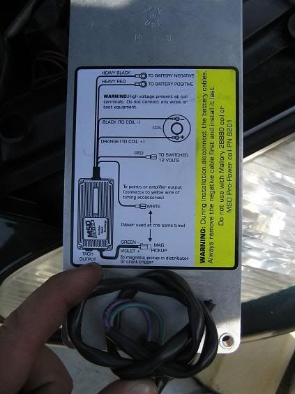

I've never installed a MSD Ignition and if anyone could please explain it to me so I can be sure it's done properly, I would sincerely appreciate it. The car is scheduled for tuning tomorrow, so I really need this done asap. This is what I know so far:

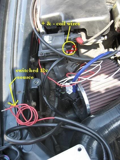

Where do I tap-in for the "switched 12v source?"

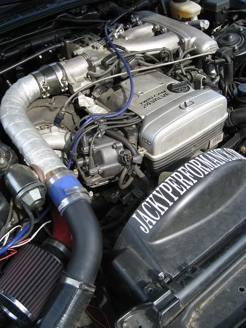

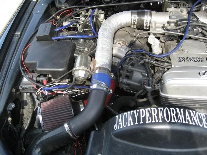

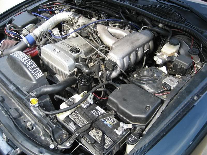

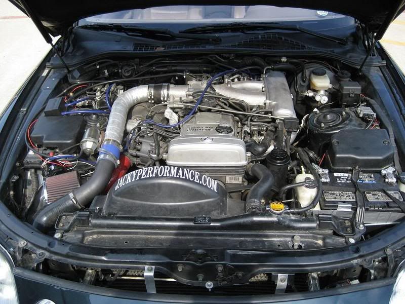

Where do I connect this green and violent colored wire pair to the "magnetic distributor pickup?" Here are some engine bay shots if anyone can point out the wire connection locations :
