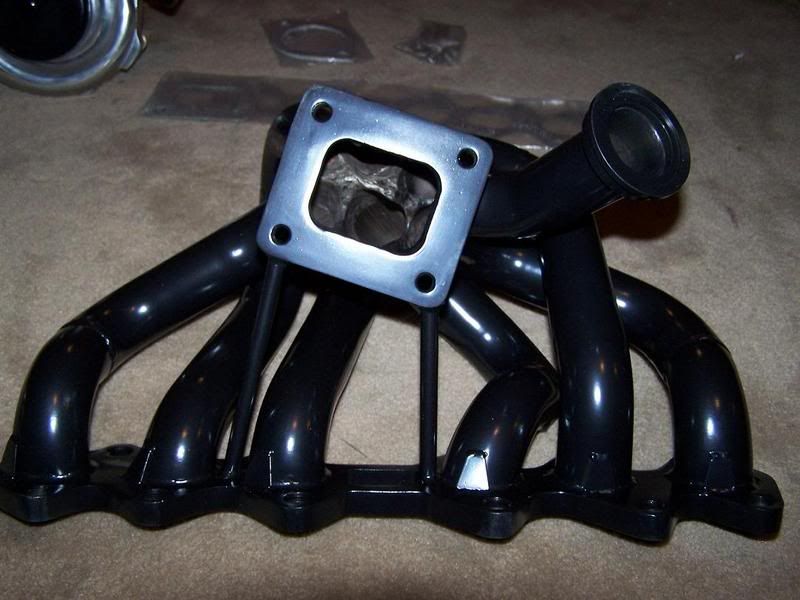

the wastegate could be ok if i have better manifold design.
if wastegate connection to manifold have angle of 90 deg , the flow capacity reduce by up to 50%
good (wastegate face up)
bad (wastegate face down)in this case you have to put bigger wastegate
