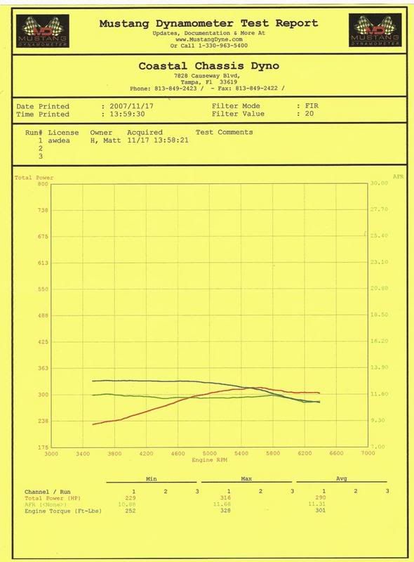

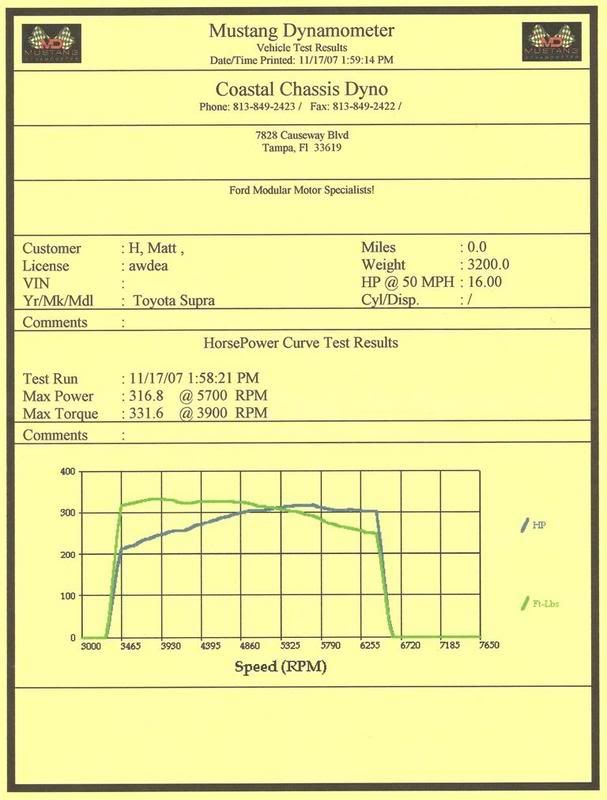

Here's a post from the dyno sheet thread.
mhopemk3 said:
Here's mine from the Tampa meet last weekend @ 12psi on a 60 trim CT26.

s7mgte said:
i got an 88 turbo supra and so far i have brian crower cams upgrade t4 60-1 turbo. hks intake, 3in downpipe and exhaust, metal head gasket with apr studs,. i also have a lexus afm and safc2 and boost controller that are not hooked up. how much boost could i run on the stock 440's with a good tune on the safc2 with these parts. ?
I would think the duty cycle of the stockers would be like 90% @15psi or so. Correct AFR's of course.
My dyno sheet that bowser posted was with the below mods. The Turbo has now been changed to a 60 trim without the BB..
