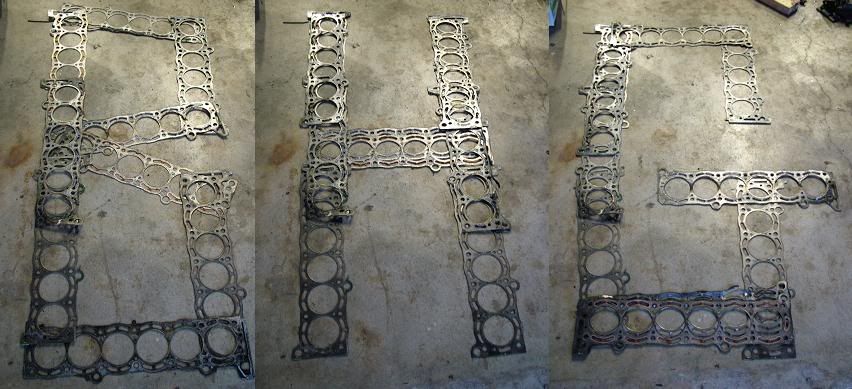

The BHG denial stage....... we have all been there before.
