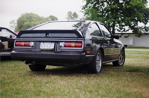

how seems that its space is limited. if it is anything like the MKII then i can see how, but from the above pic. it looks like it would be cramped.

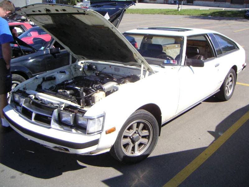

That's exactly what I thought until Damon brough this thing of beauty to the 2001 Toronto Meet:
Here's his 7mgte non-intercooler MK1...don't let it's looks deceive you...this thing has eats Vettes for Breakfast and $#!t's out STI's:
