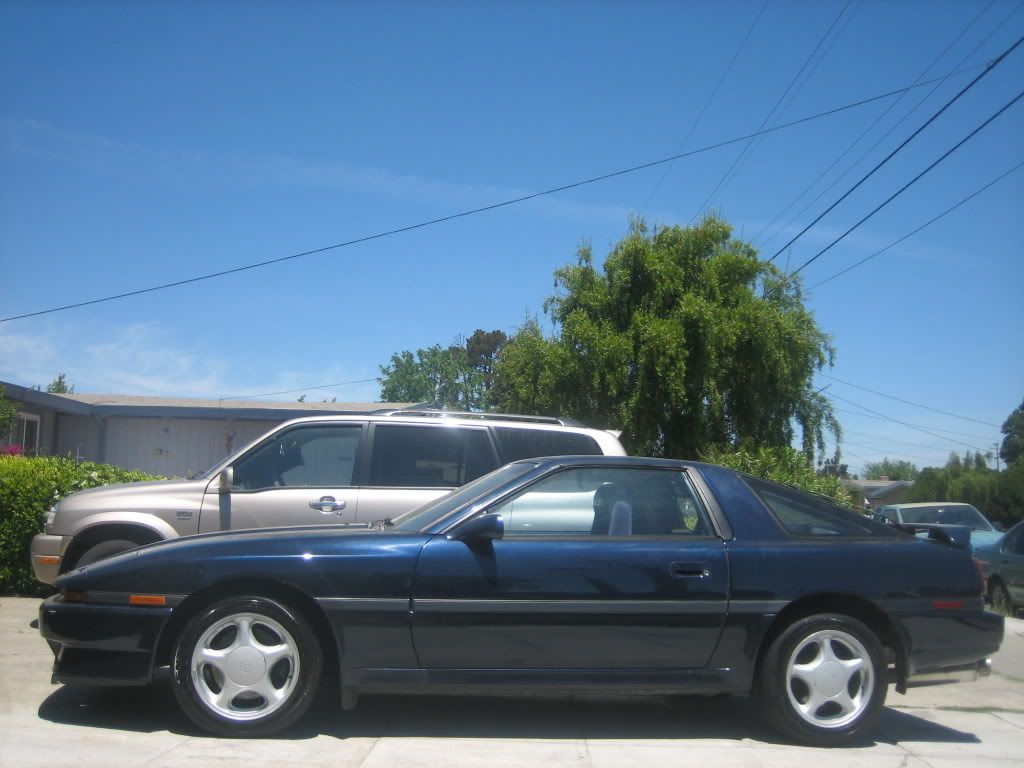

Yea purchase some wheel spacers or those project kicks spacers would be a safer alternative. I think I used 10mm spacers in the front, none for the rear. With out spacers the inside of the rim will rub the control arm on full lock when turning.
My car.

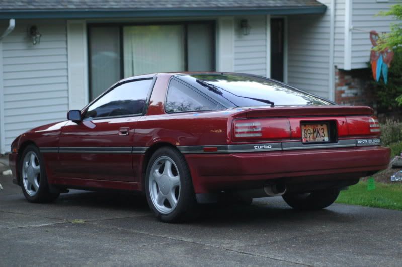

the 17x9.5 and the 17x8's or 8.5" not sure
they're not thaaat bad just because they're so damn wide
in the rear im rockin 275/40 and clearance is fine and this is before i lowered my car
and in the front they're 245/45

tsuper92;1380793 said:
^^^those are turbo wheel's.the mkIV N/A wheel's are 16"
still the same shit. :) Only diff is .5 in width for the rear and 1'' in diameter all around
