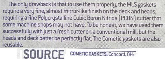

A Cometic is a metal gasket. You still need to have the surfaces smooth. Less than a RA (roughness average) of 50. See pic below.

The following is what Cometic recommends in terms of smoothness.

damn so im doomed, this car is the only car i have, and I cant take it appart and let it stand for a week to get thte head resurfaced and shit.
whats my alternative ??? OEM gasket ??? from Toyota ? will I be able to run 350hp on those torqued 72lbs
