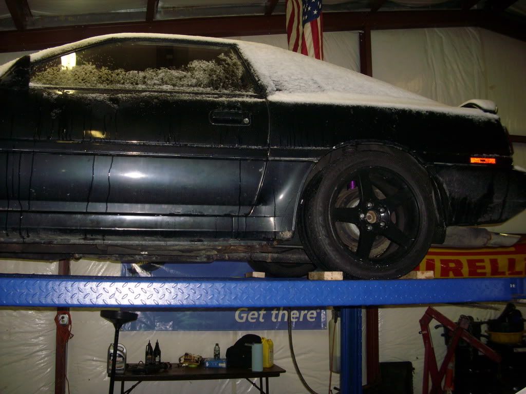

17x9 Racing Hart Rev wheels, damn if I recall what the offset is. Maybe I can find the sticker... Tires are 275 width, 40 height. Fronts are 17x8, with a 245 45 tire.
Edit: Offset is a +35 on the rear.

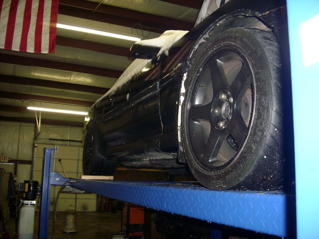

Here's another pic, showing just how little clearance there is on the back...
Looks great Grim! Are your fenders rolled? It also looks like you may have a degree or two of negative camber, which would help those clear.

No rolled fenders there, that car has a stock body. Definitely had some negative camber, as shown by tire wear - no way to pull it out, either, as this setup came so damn close to the body on the outside that I was constantly amazed it didn't rub. On compression, there wasn't enough room to slide a popsicle stick in between the tire and the body.
The front were actually too close, they would catch the body occasionally.

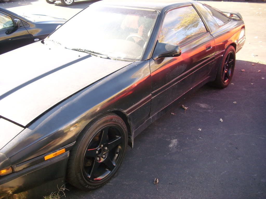

Sounds exactly like my setup now (but with 18s). They are 18x9.5 +31 in the rear w/ 275/35 tires and I don't think they would clear without a little negative camber. This is the best shot I can find right now:
