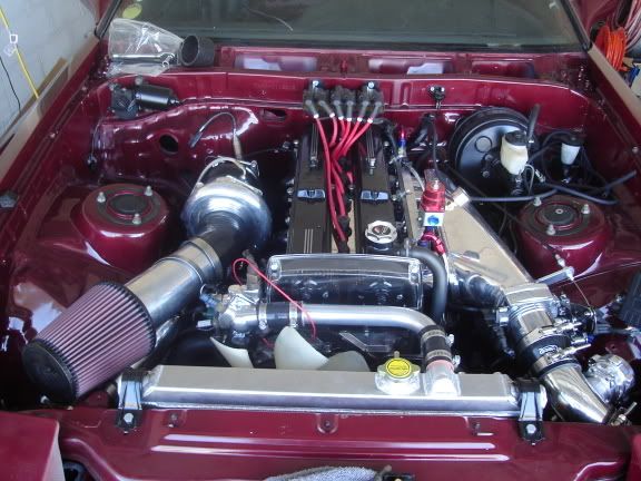

its funny cause most of the things mentioned in this thread are in this engine bay:
the next thing would be the COP setup and it would be pretty much as clean as it gets. and yes the wiring harness IS in the engine bay...the red wire is the only one not hooked up as we are waiting on a ring connector...
teh week sause....hahaha, looks good, bet you have professionals working on that beauty.:bigthumb:
