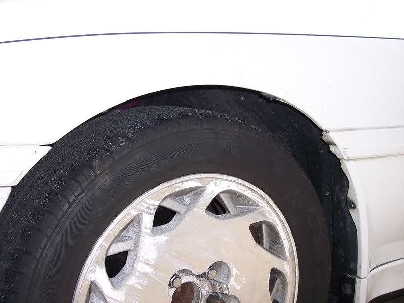

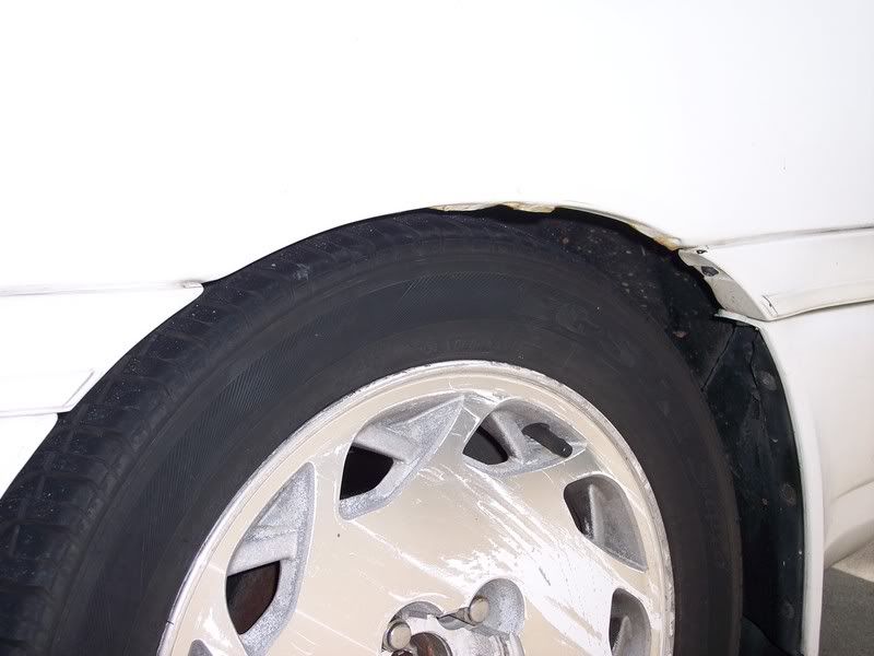

this is what it looks like after over 6 months.
rear
front
looks way worse in person
is it possible to put the shocks/struts on backwards? anyone with this problem? or is it just the springs?
i will probably get a new set.
