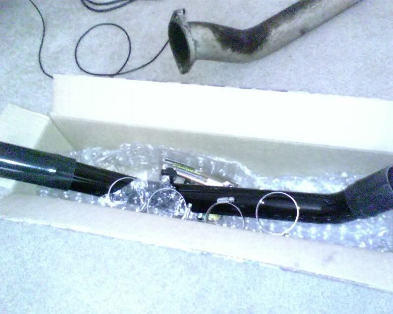

Found this Lower IC Pipe online. What do you think. Seems like a good deal considering the Toyota oem rubber hoses are just as expensive. Seems to replace two hoses and the elbow.
The link is provided below and look at the bottom of the page 3rd row from the bottom in the middle column. (Supra intercooler Piping kit)

Im running it.
Fit perfectly and i felt the car spool faster and stronger, possibly due to a fubard lower ic hose. Its good for its price.

HommerSimpson;1017850 said:
have any pics of it on the car ?
That looks very nice to... how much was it ?
Ill get some pics later on today and it was i believe $99 + shipping

I'm running the same pipe as well. It was $95 shipped which is a really good deal. Fitment was pretty good too.

bro has it on his car and has been running it without issue for over a year now. biggest thing is the paint isnt all that great as we are going to need to pull his off and repaint it in the coming weeks (flaking pretty badly) powdercoat would be the best bet

I bought one of these when I did my 7M swap.
Pros:
Cheap.
Fewer connectors than stock.
No fitment issues (though getting the silicone coupler onto the CT26 was a chore)
Cons:
Not larger than stock.
Overall, it was a good buy, and I don't regret it. Even if I have to replace it when I finally get around to bolting in my new turbo, I can probably get most of its purchase price back selling it used, since it's still a good piece.

I'm running it and its a great peice ,the only thing i could find wrong with it is that it comes with screw clamps and not T-claps but thats not really a problem

The outlet on the CT26 is a 2.15" outlet and that pipe looks like a 2.25 incher. so i don't know.............if it's a 2"er i'll buy it gladly. Who has it off to measure it?
I dunno if this will help but i have the pipe mounted to my GReddy TD06H20G turbo and it fit fine no fitment issues
is it really tight on the greddy, aka you had to use WD40/oil to slip it on? I put a 2.25 coupler on my CT26 and it was too loose for my liking, and then use my vernier to measure the outlet and got 2.15 then i took a 2 inch coupler and couldn't get it on, used lube and got it on no problem.
