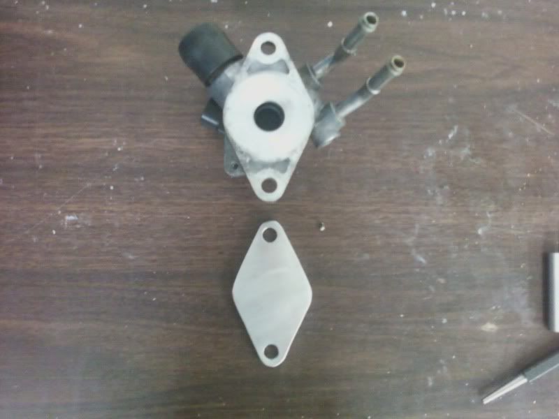

I would check you IACV. Might be stuck closed, or open. Or just not running right. Or take it off and make a block off plate like I did then crack the throtle open a tad:
