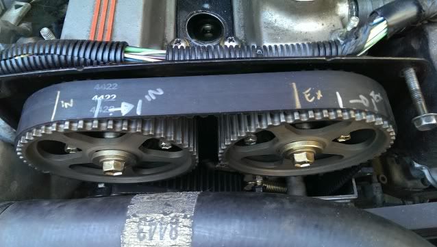

first of all i just want to thank everyone for their input, this is why i love this community
i went out and bought a new compressor and then before doing the compression check, i figured i should triple check the initial timing
turns out both the intake and exhaust cam were 4 teeth off,
20 min later tdc and timing set compression jumped to 150 across the board
threw on some new plugs and it started right up
THANKS!!
super51fan
Jul 28, 2010
497
Indianapolis
Thanks for sharing the cause of the no start. And the picture is also a great help. These cars can be tricky, however it usually is the basic things that cause problems.
