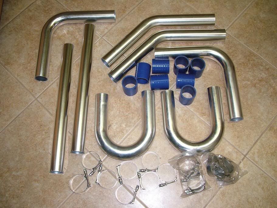

The problem is that once there is a little oil inside the piping the stock clamps can not get tight enough to keep the hose from popping off. T-bolt clamps will fix that issue. The lower ic is also known to crack, and it's hard to see without removing the accordion pipe.
I never use worm-drive clamps for intercooler piping anymore. The t-bolt clamps are around $4-$4.50 from your local Napa auto parts, or about $3.25-$3.75 from me.

The pcv system is what gets oil in there. A light coat inside the pipes is common. Yes, you can run 2.5" piping and it will be fine. You will just need some reducers to go to the turbo, intercooler and 3000 pipe.

As Aaron stated, get rid of your stock clamps and or worm drives & step up to T-bolts. For good measure, replace as many of your couplers along the intercooler piping as your wallet will allow. If the budget is tight, at least try to replace the couplers at the 3000 pipe to TB & the one coming off of the pressure side of the turbo as these are the most common to fail. That *should* heal your ailments.
