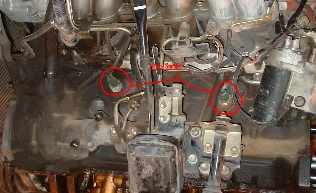

I'm pretty sure I know what the knock sensor are, seeing as I’ve done the KS rewire twice on two different turbo cars. Plus I have two Knock Sensors sitting in a Ziploc bag out in storage.
Here is the knock sensors on my block(a 7MGTE to avoid confusion). Don't have a pic of his.
I don't know what was up with my friends car. He lives in denver and bought the car with a bad starter. It had a dead spot in it. So I helped him replace it and I seem to remember two knock sensors. It was a 1987 N/A. I don't know what was up. I had to head back to Craig before we got the chance to start it. So maybe it didn't even run? Don't know.

sweet. i'm always worried that i'm going to come off sounding like a dick. :drink1: i'm willing to bet he has a turbo block then, because all N/A's came with only one KS. i wonder if he has turbo pistons too... lower compression etc... you now have me curious haha.
