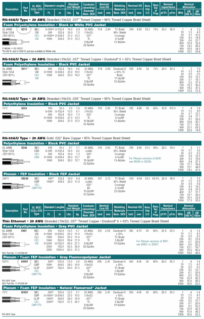

You need some RG-58 stranded core cable:
What ever kind of cable you get, stranded core is more flexible.
8219 or 8259 will work well:
