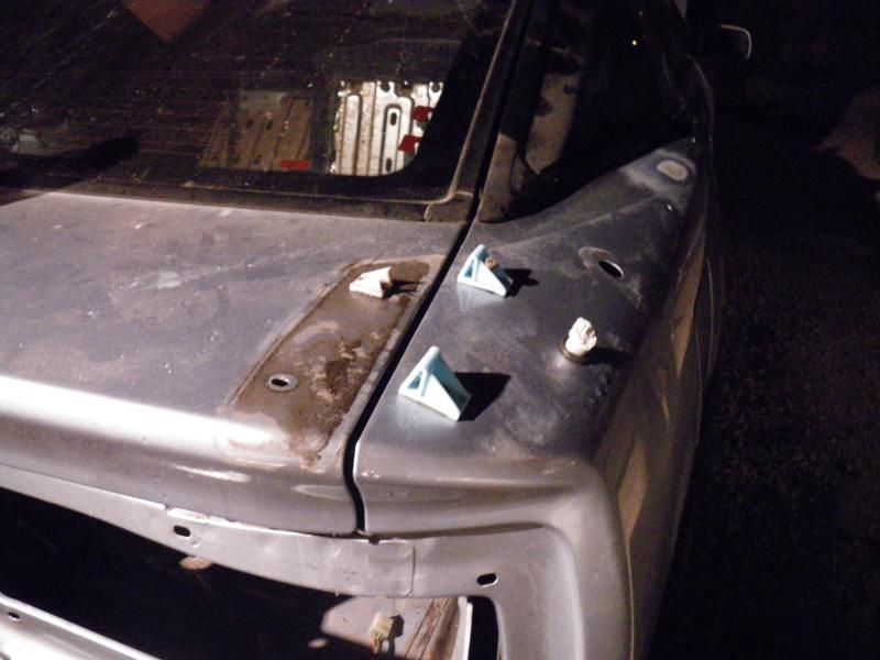

I do have a curiousity though, walked out of Fred Meyer (Grocery store) to some kids standing around my car, seemingly checking it out, and when they noticed I was walking more-or-less straight towards them they all walked away.
Checked out my car and it was fine, but when I popped my hatch, then shut it, I noticed my wing was loose on the left side (as though someone yanked up on it)
The little (fiberglass?) brackets inside the hatch are broken, is there a good way to fix this? or should I just figure a good DIY way to secure it?
Do you mean these little plastic brackets??
If so, a couple of mine were broken, too. I just reinforced them with some carbon fiber chunks that I had laying around and fiberglassed over it.... they are never going to be seen under there, so they don't look pretty, but they're not going to break. Then I just made a new... gasket, I guess, for them out of some sticky-backed sheets of vent foam that I found at home depot.... If you can understand what on Earth I am saying, it worked pretty good.
