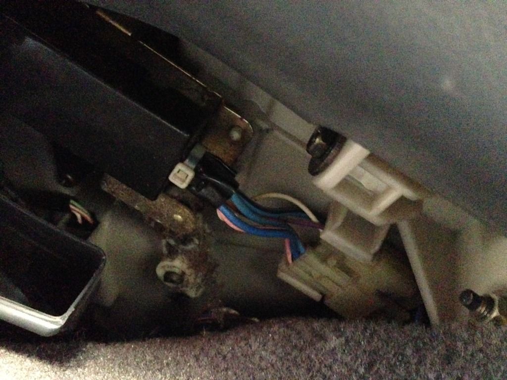

well, it did it again, only this time it did it after the car had been on and driving around for about 45mins.. I played with the temp buttons and cycling on and off, and tapping the gas with no noticeable change in the noise.
I did however feel exactly where it's coming from. I grabbed the black block in the pic and the noise/vibration is coming from directly above it.. I still don't believe this is coolant system related, and to the touch it feels mechanical in nature, so is that the general area for the solenoid or something else that would cause this?
(looking up under the center of the dash from the passenger side floor)
