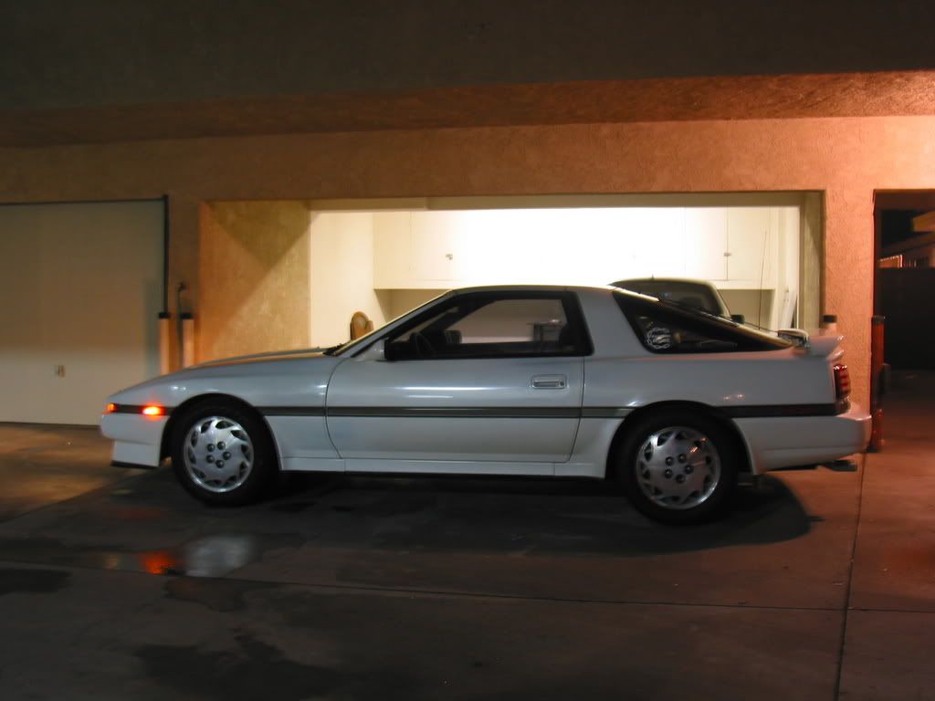

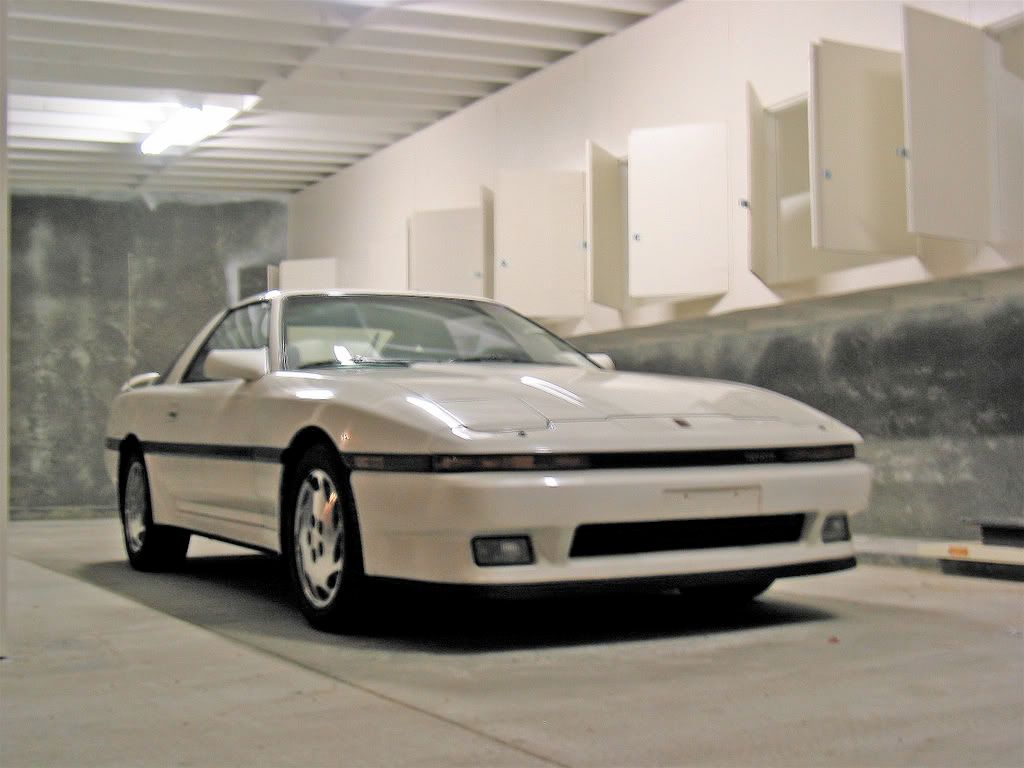

I repaced my stock setup with JZA70 Springs (not TT-R), and KYB GR-2's...they are great shocks and are really cheap...IIRC, you can get a full set for like $100-120.
And yes, the JZA70 Springs lower the car about 1.5"...Here are a couple pics:
I like them, I think they give you the perfect ride height...the others are too low, even with these springs, I still scrape on driveways and speedbumps occasionaly.

Nice, I really like that height. I'll look around now, but is that the usual going rate anywhere for those struts?
I just bought some aerosol aircraft paint remover so come spring my wheels should look like yours.
