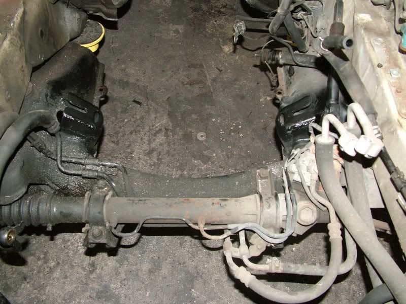

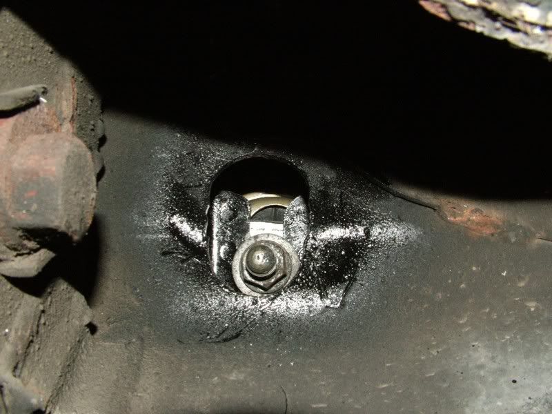

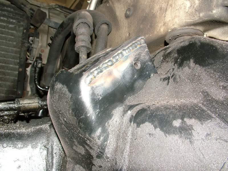

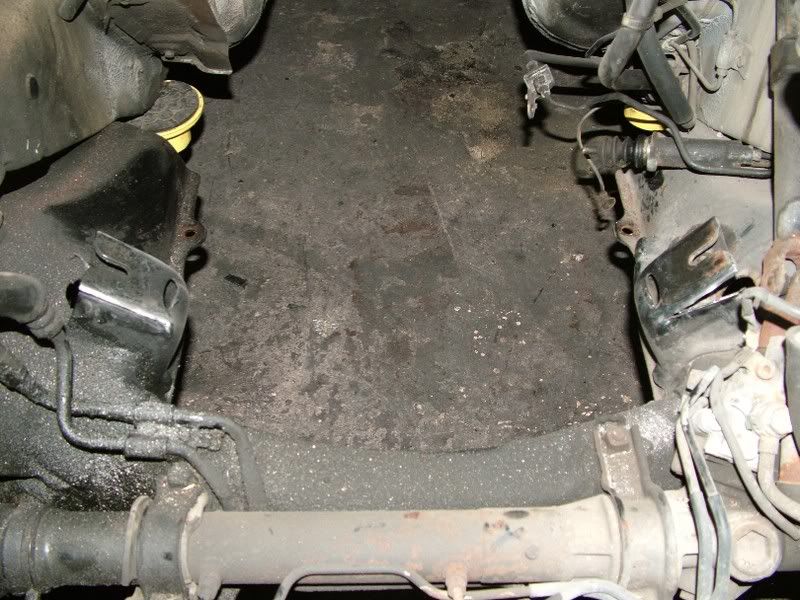

The BAC mounts. But I wasn't making fun of BIC, I like his stuff and he has sold many items to happy SM customers. We have used his mounts before several times and also the ceramic coated ddp's are really great.
This job takes a few hours and you need a welder, holesaw, grinder, paint, drill, sawsall, and 1/2" drill bit. If you don't have all those items you might as well buy the BIC mounts.
