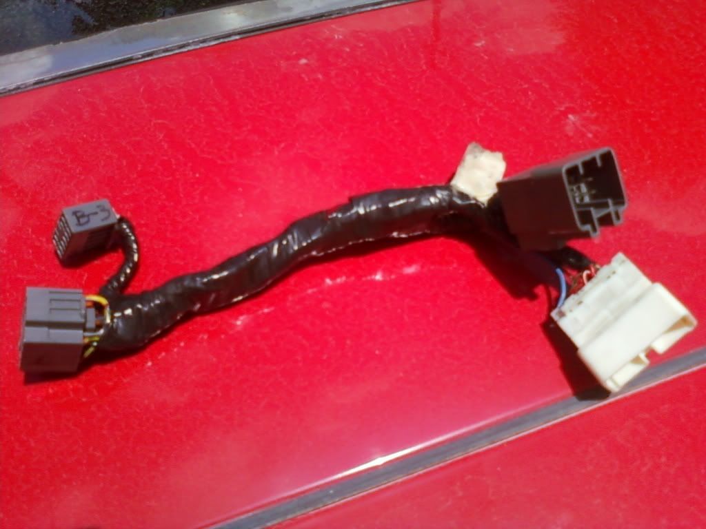

ok, the 1J engine harness doesn't have a B3 connector, the B3 should be on the MA70 chassis and the wires splice into the IH2 of the 1J. When I did my swap I didn't use the wires because I don't have ABS or PPS. I can't find any info on the ID of that plug either.
I just took out my glovebox and snapped a bad cellphone pic of the same plug you have there and I didn't need it for the swap, I don't know what it went to on the JZA70 halfcut I got my motor from but you won't need it for your swap.

Like he said you may not use the plug. I used the plug because I wanted power steering and abs. I looked for pics but didn't have any, sorry. If you are really concerned about the colors just trace them back to the abs ecu cause most of them go th the abs ecu. It's right next to the ecu, Should be easy.
Here is the only pic I have of the jumper harness I made. It shows what Foogoo said tha there is now b3 for the engine harness and how it is spliced in to two of the plugs from the engine harness.

Sweet then I guess I'm done. The plug I'm dealing with is the same exact plug as the B3 plug as I have the one from the MA70 and it looks exactly like the plug in question but with different color wiring. Thanks for the info.
