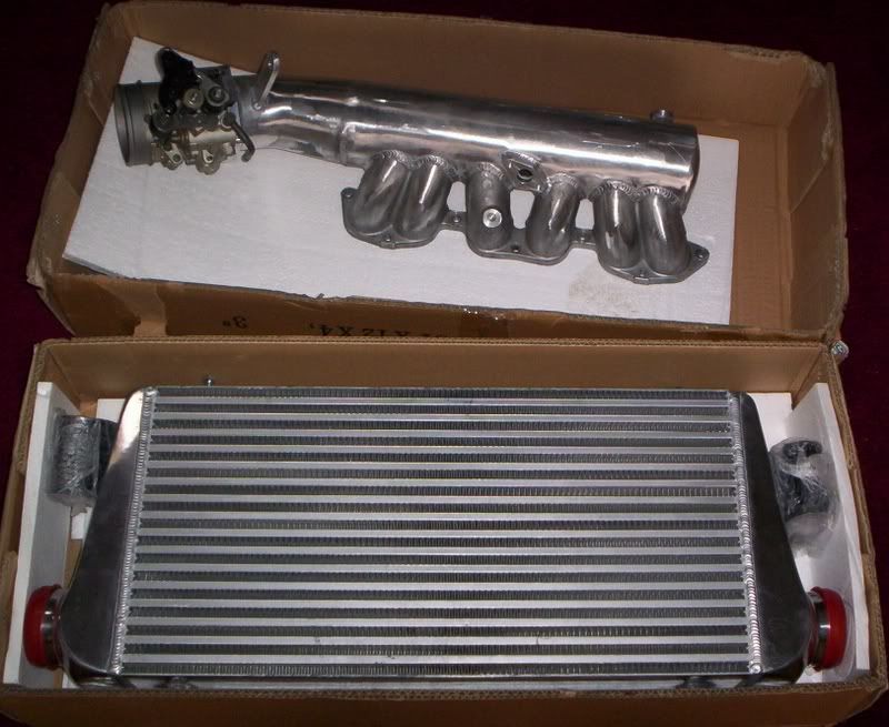

Maft Pro setup
RR FFIM with 31x4x3inlet and outlet intercooler
3" ic piping

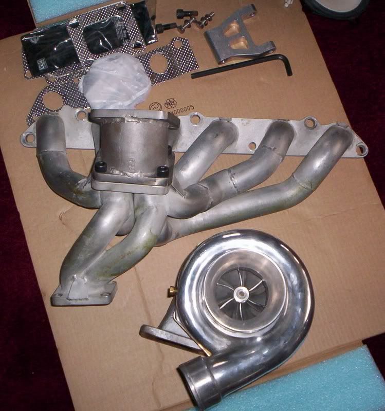

and of course the whoopdy doo Turbo with Ceramic coated manifold and custom made spacer

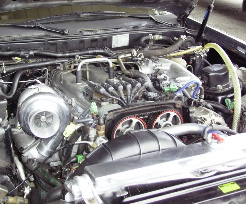

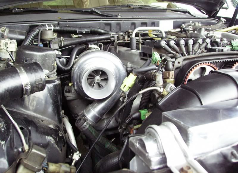

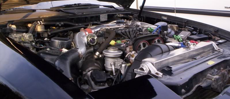

The Engine how it sits in the somewhat stock form

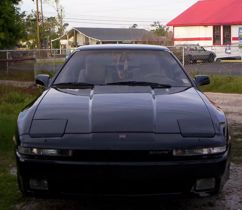

o and the car before i put it in the garage where it sits at the new house. Photo recently taken at the old place.

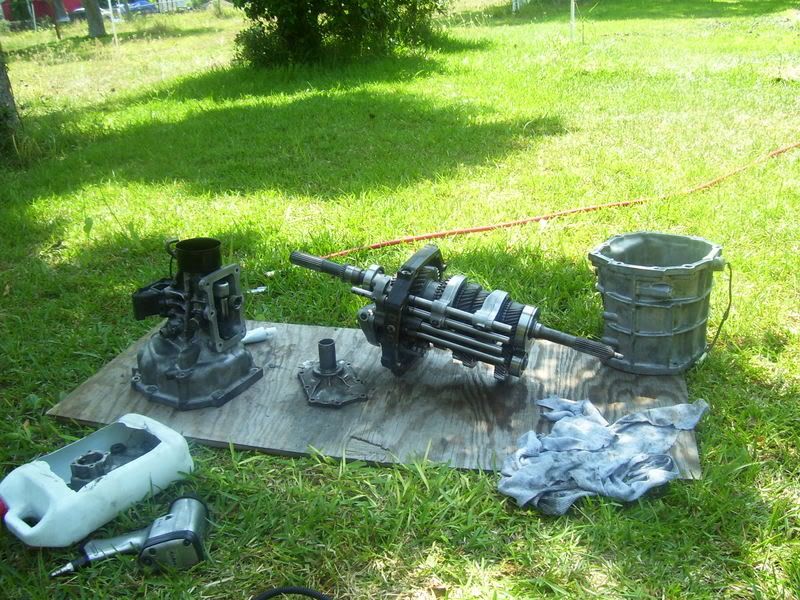

But before I took it to houston i did have a small problem. 1st gear went out, it wouldnt stay in 1st gear so I tore the tranny down.

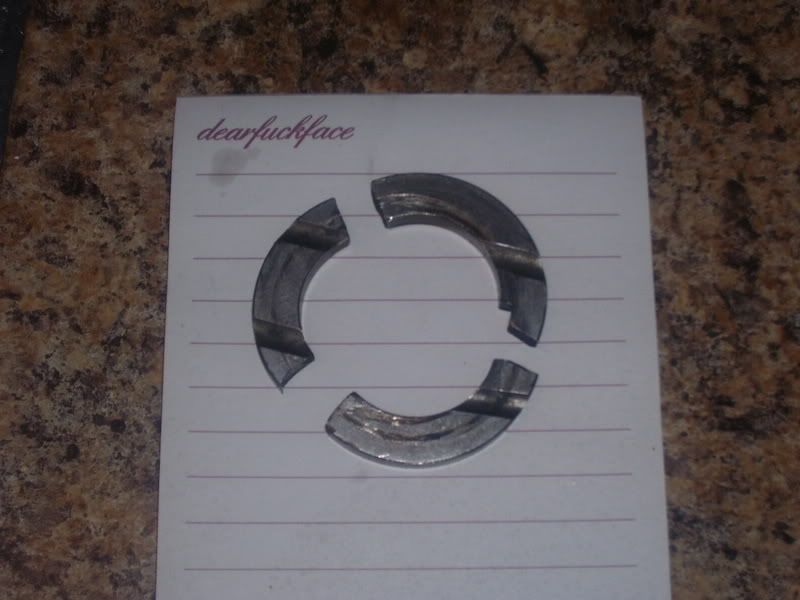

And found out that it was what I and a few others thought. Broken 1st gear thrust washer
Rebuilt the Tranny and it drives fine now! I do have a few more problems that have popped up since then and that a blown out driver side rear strut soon to be replaced by coil overs and a dead rack and pinion soon to be replaced!

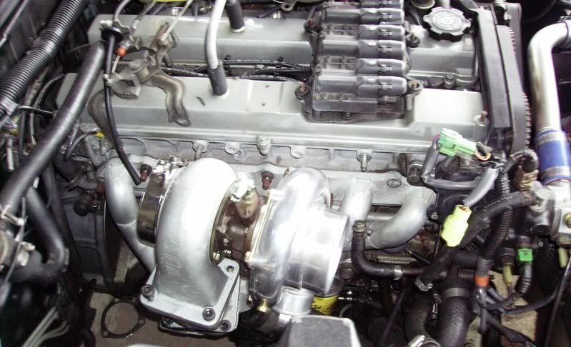

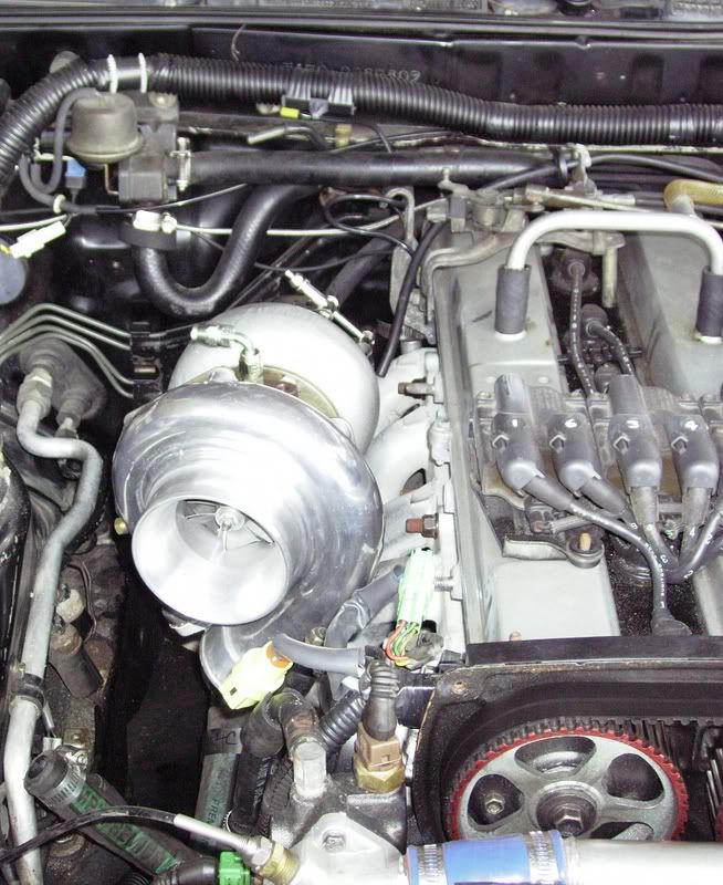

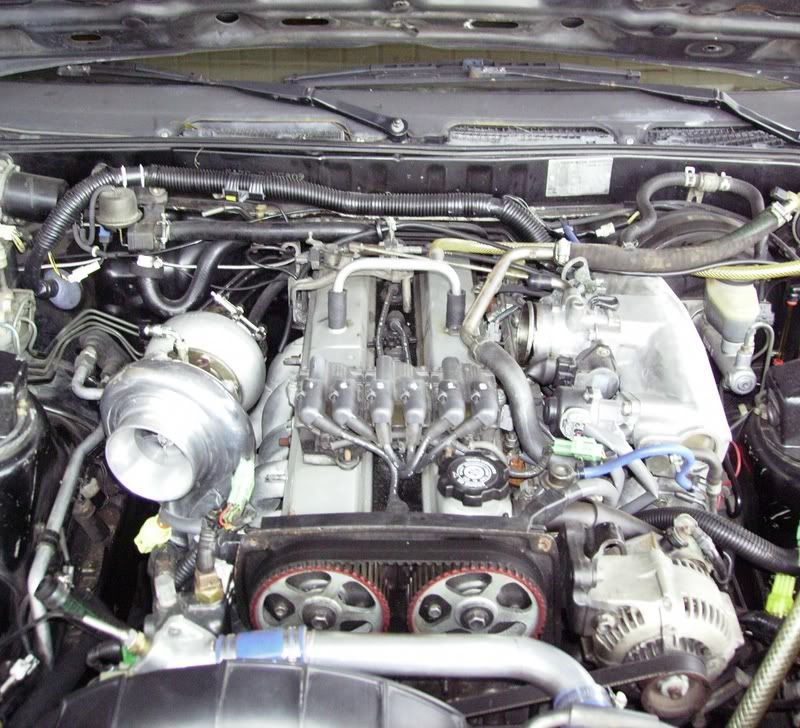

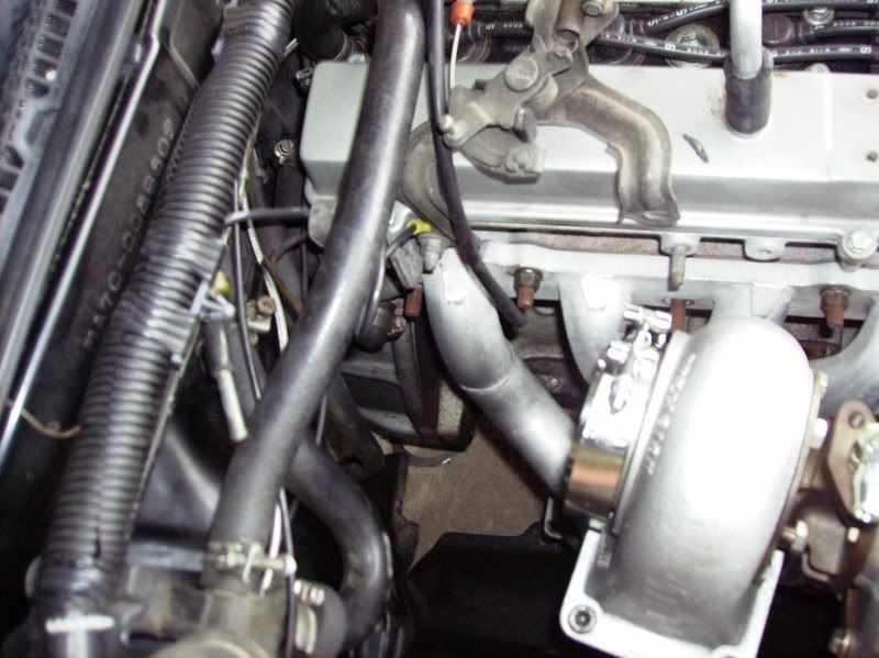

Well took off the old Ct and stock exhaust side. Mocked up everything simply to measure and cut my SS lines then I will take it apart to mess with the wg position and weld some more bracing to the manifold itself. Everything is dirty now but when i finalize everything it will be cleaned up.

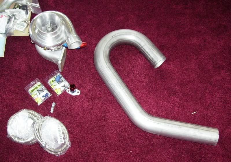

my stainless pipe I will be using to build the dp!

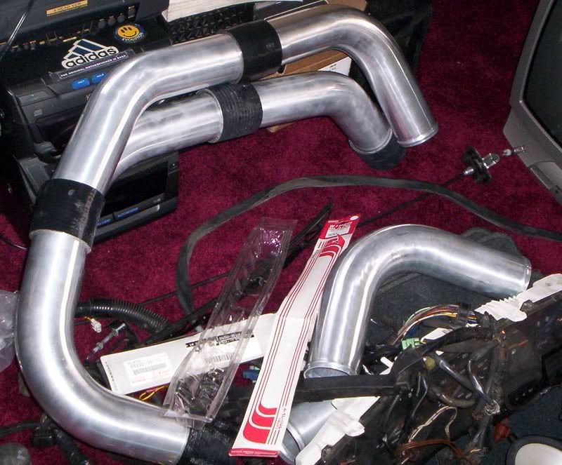

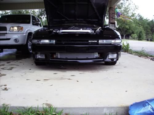

no real updates just yet. besides getting a new steering wheel (momo), shift boot, ebrake boot. Still routing ic piping, ordered some more couplers, and waiting for christmas to pass so I can buy my fuel pump and injectors all in 1 purchase.

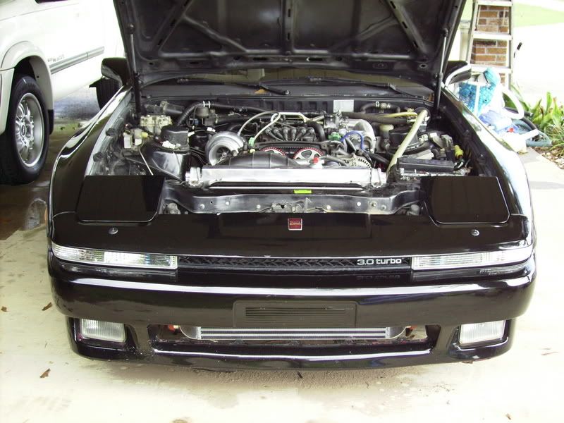

But here is a pic of the car before I parked it.
IC mounted
just a mock up pic, the intake pipe will be different along with the placement of a few other things.
