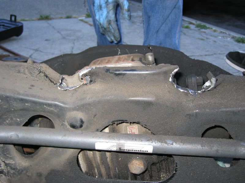

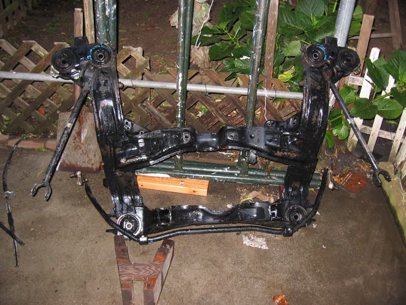

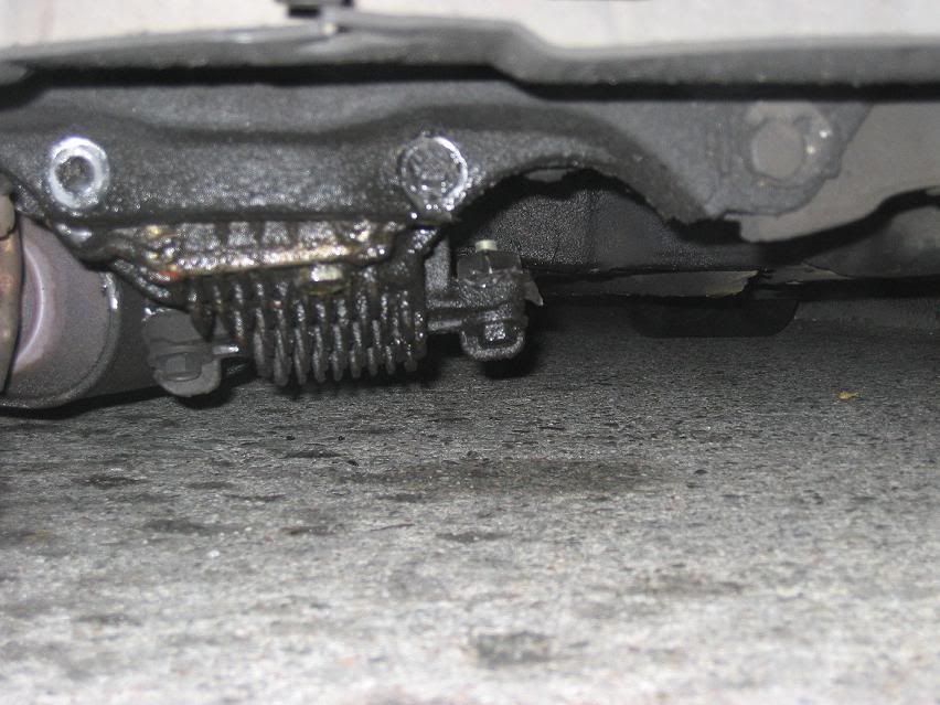

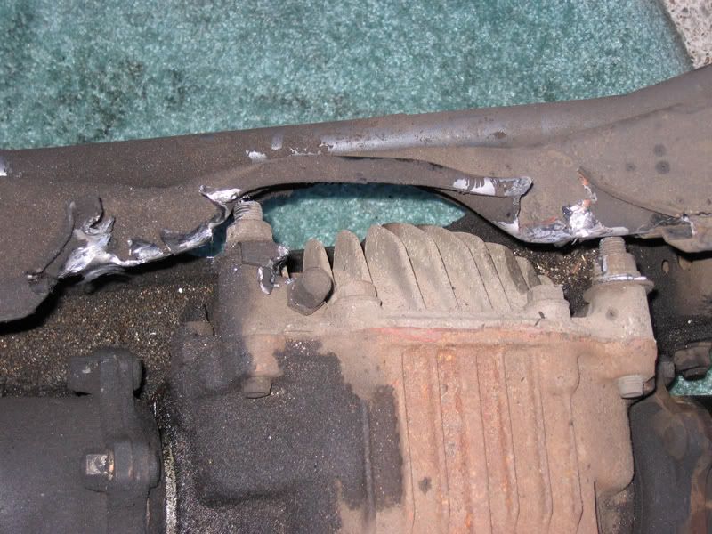

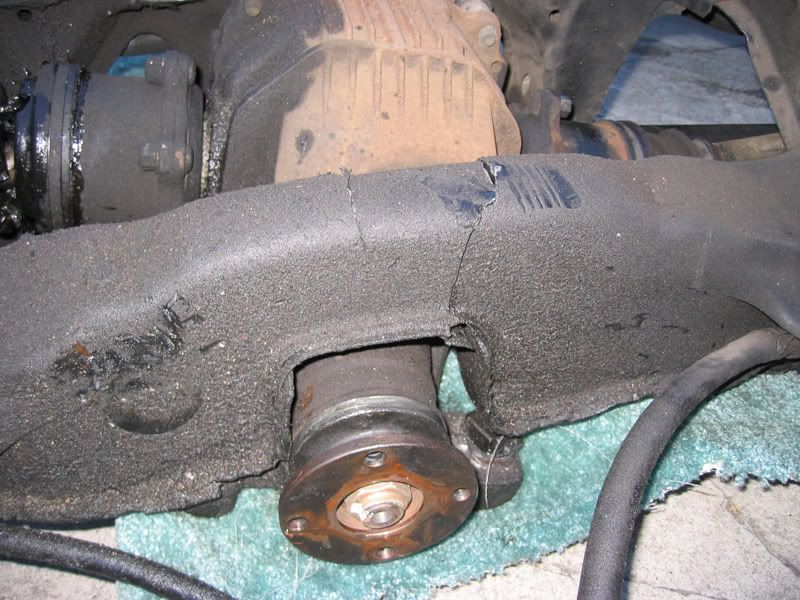

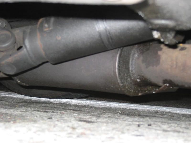

fast forward some more, I have bad turbo seals, and guess what... one night my subframe finally decides to give out.
2 of the bolts on the differential broke off, and the whole top part of the subframe got ripped out.

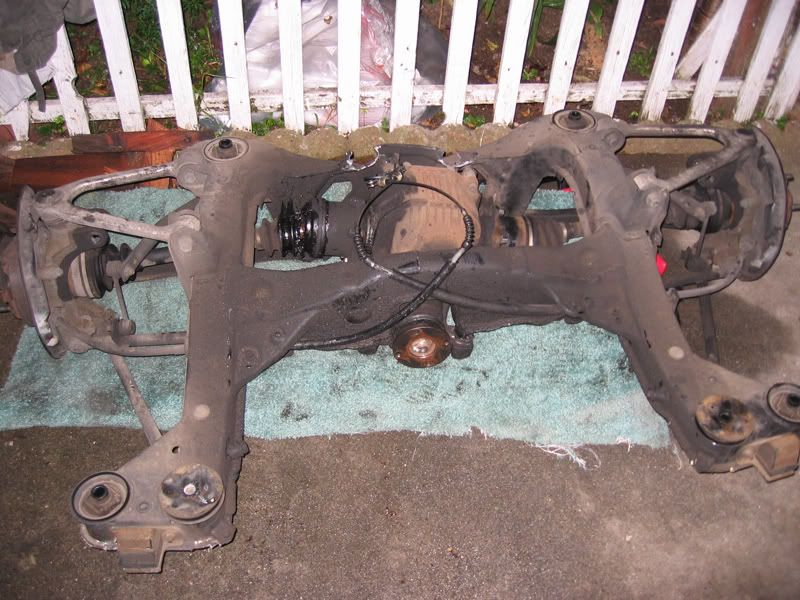

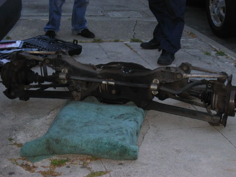

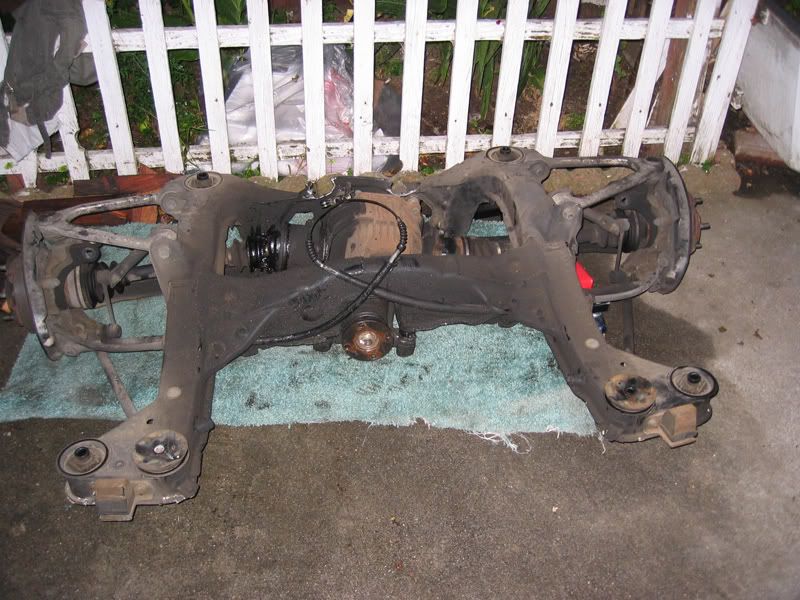

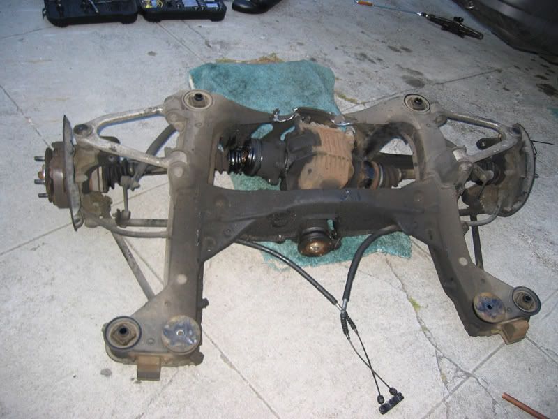

finally got this bastard off!
old, useless subframe
new... well new subframe i'm putting onto the car

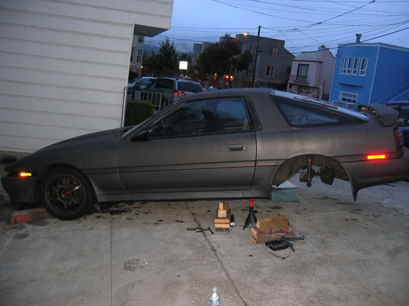

car as it sits without the subframe

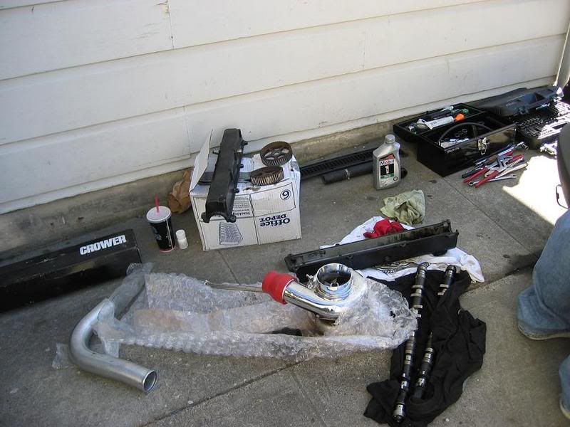

now that the car is running good and have an alignment time to upgrade!

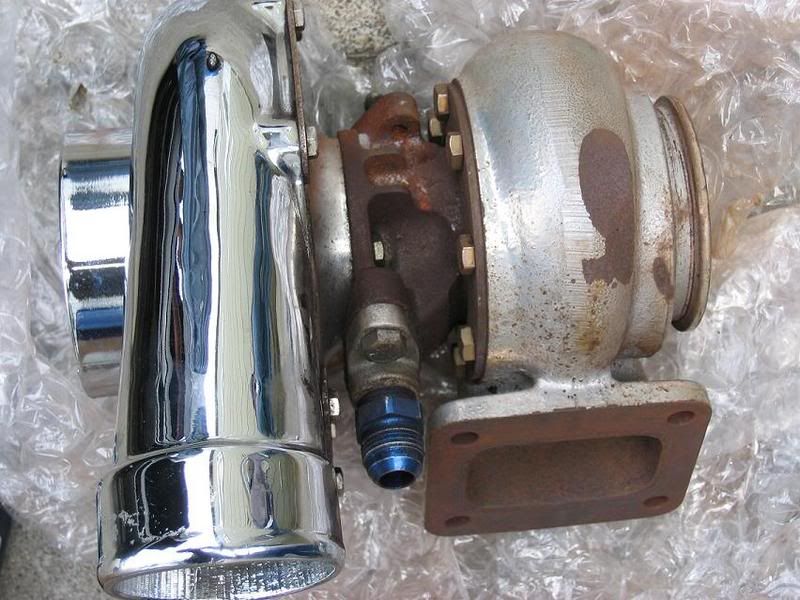

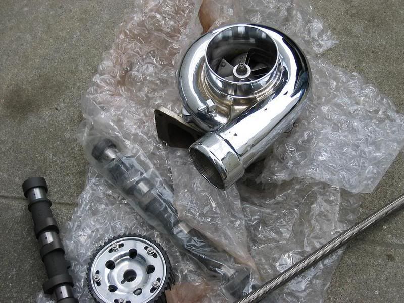

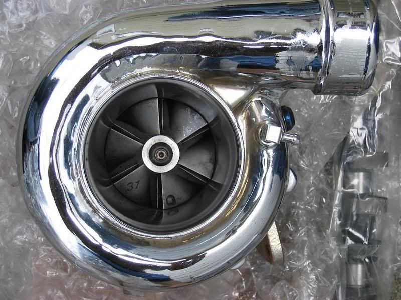

SP74HO turbo thanks to fstoy

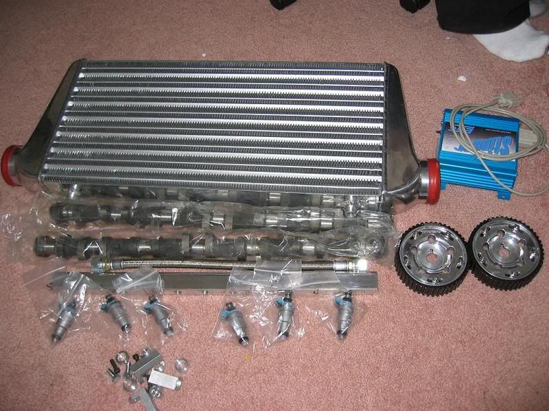

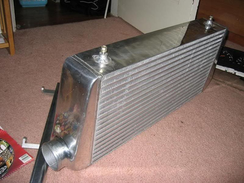

24x12x4 FMIC bar and plate thanks to BoostAddct
FMIC, Stinger Standalone EMS, Titan cam gears, GReddy 720cc injectors (swapped for Precision 780cc injectors), and a TTC Top Feed Fuel Rail
HKS EVC 5 woot
Stinger Standalone thanks Jose

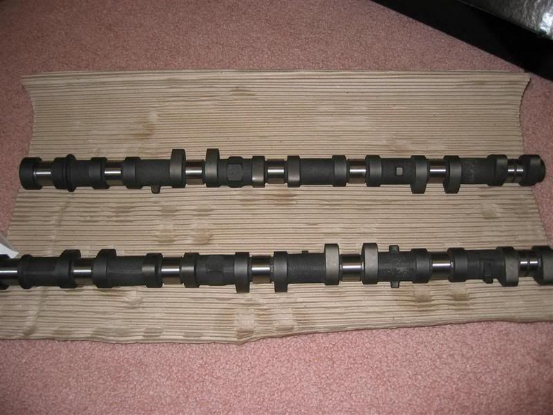

Crower 272 small core cams

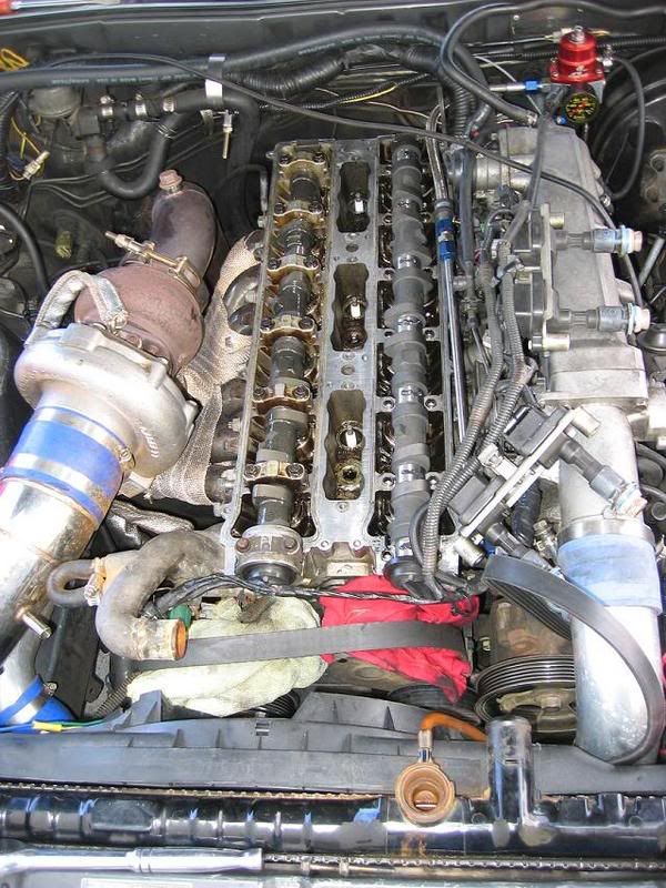

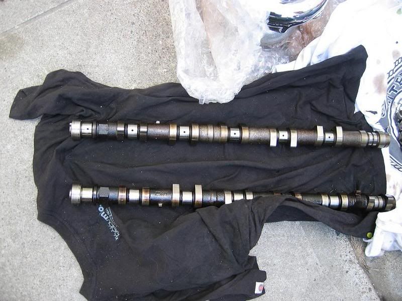

you can see how much fun we're having installing these
old 1JZ camshafts are out
new camshafts installed :)

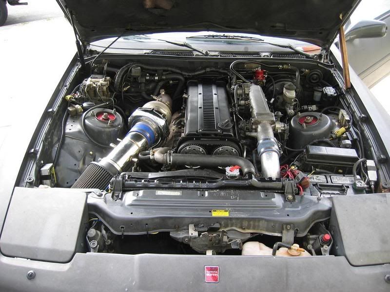

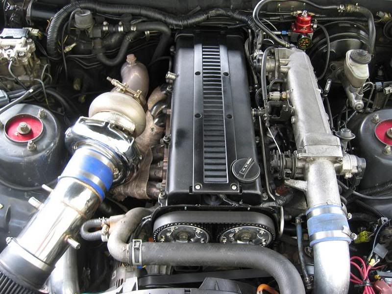

everything assembled back together

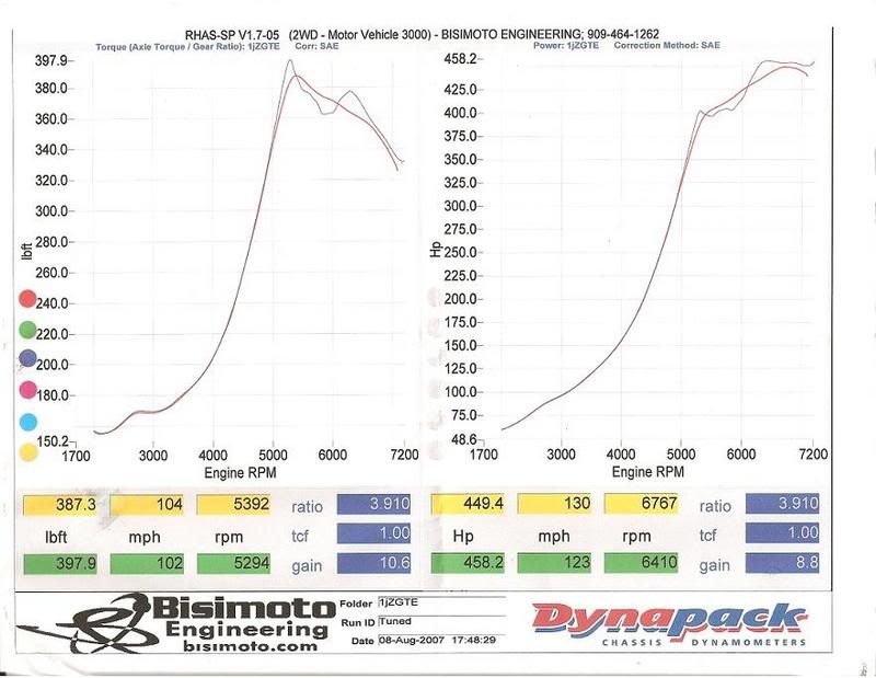

brought her down to DriftMotion/Bisi motorsports to get this baby tuned!
458.2rwhp 397.9rwtq at 14 psi
the engine bay as been cleaned up some more and everything is just slowly getting cleaned up, and eventually it'll get the long awaited paintjob that it needs. Stay tuned

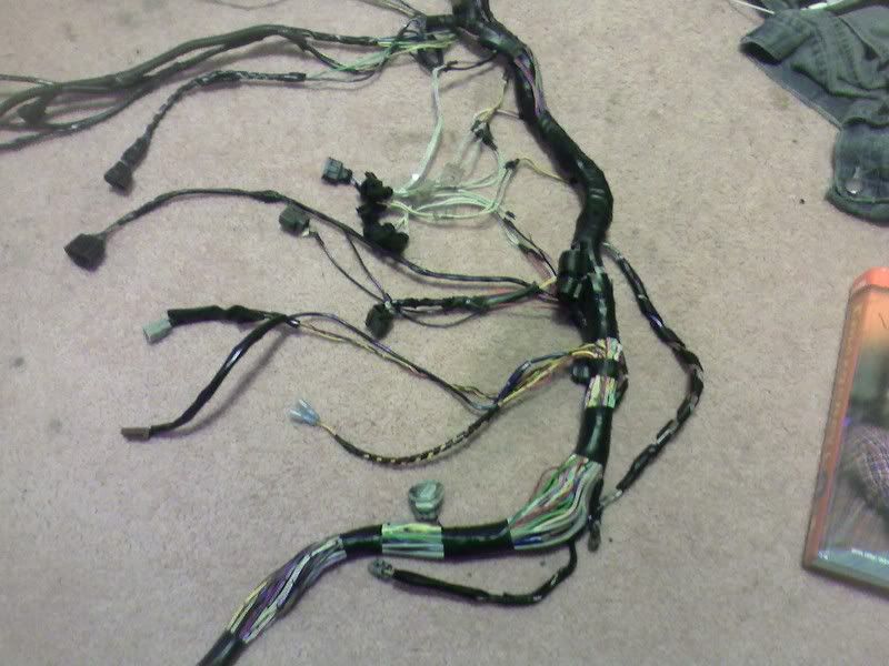

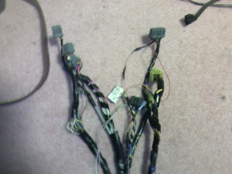

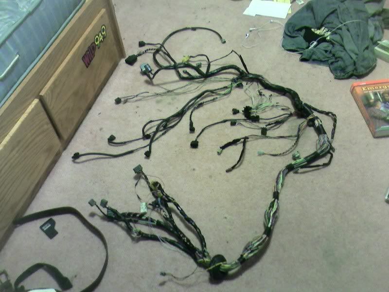

this is the harness after I fixed a good portion of it and rewrapped a whole lot of nasty harness, still not completely done yet, but it's getting there. stay tuned

Im interested in your work on the harness. I have one that I would like to freshen up and replace old wires but just curious on how much of my time it will take or if it would just be worth it to purchase one from toyota.

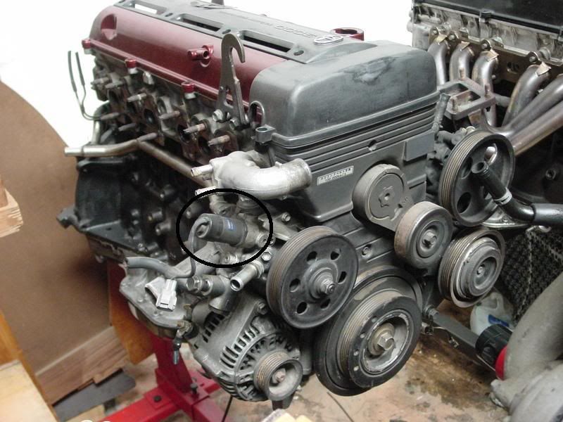

EvoLuTioN said:
you mean this?
The one beside it actually. The larger one is the CLT sensor for the ECU, which is the same on both motors. The smaller one is for the gauge. While the signals are the same, the sensor on the 2JZ has a different connector, and the two sensors are not interchangable. It's not a big deal.
The oil pressure sensors are different too, but they are interchangable.
