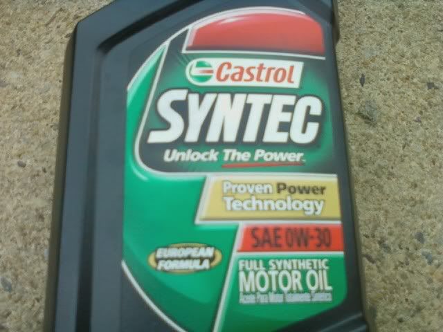

Pulled and threw the built 7m with the r154 into the clean white shell. I just got it running today! I put 0W40 European Blend castol oil because everyone says its the shit! lol drove it to my buddies about 2 hrs ago, showing him whats up in the toyota world. lol (he loves his pontiac GTP's) lol
After i hit it a couple times, i was pulling into his driveway and started to hear Rod Knock! WTF!!!!!!!!!!!! i couldnt believe it! im so pissed and hurt! i really am. After everything i went through to try and get this car going it just screws me again!
it only comes in 0w30 although i doubt that was the problem

Yes your correct.. Lol its 0w30... I was to caught up in the story.. Lol but ya im gunna pull the motir and thriw new bearings in... Hopedully that will work... Wat do you guys think? Wat about my mains?

And from wat most ppl say on here, the 0w30 euro blend is their favorite... So i just chose it based off that... Lol
