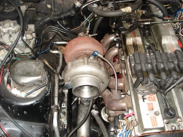

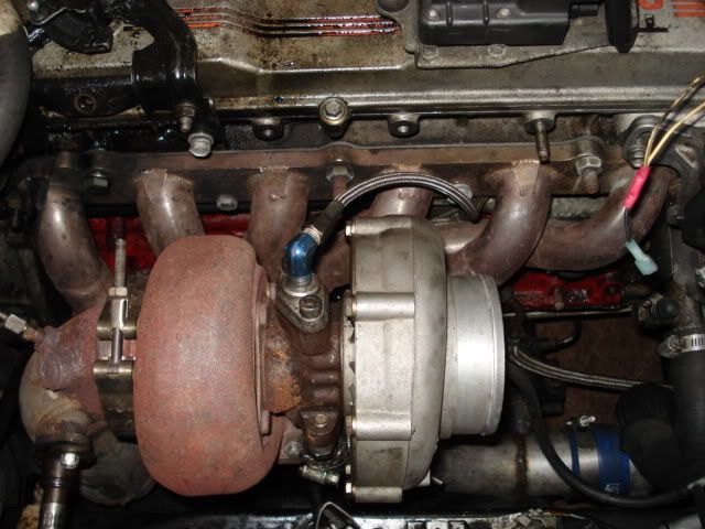

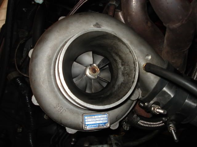

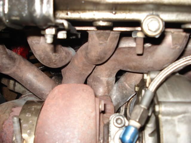

Would like to see what turbo and manifold you have on there too...
i couldnt remember what it was called and i didnt touch the timing
and ill get pix of the turbo and manifold im not sure what brands they r i just knoe the turbo it 70mm t3

and pix of my turbo and manifold that MDCmotorsports asked for
