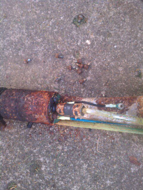

Actually found somebody had unplugged the fuel pump :nono:
Still i had a walbro 255 sitting on the shelf and continued with removal of fuel tank to drain old fuel
Drained fuel, new pump installed, fresh gas and a few cranks with fuel pump turned off(to get oil through out the engine)

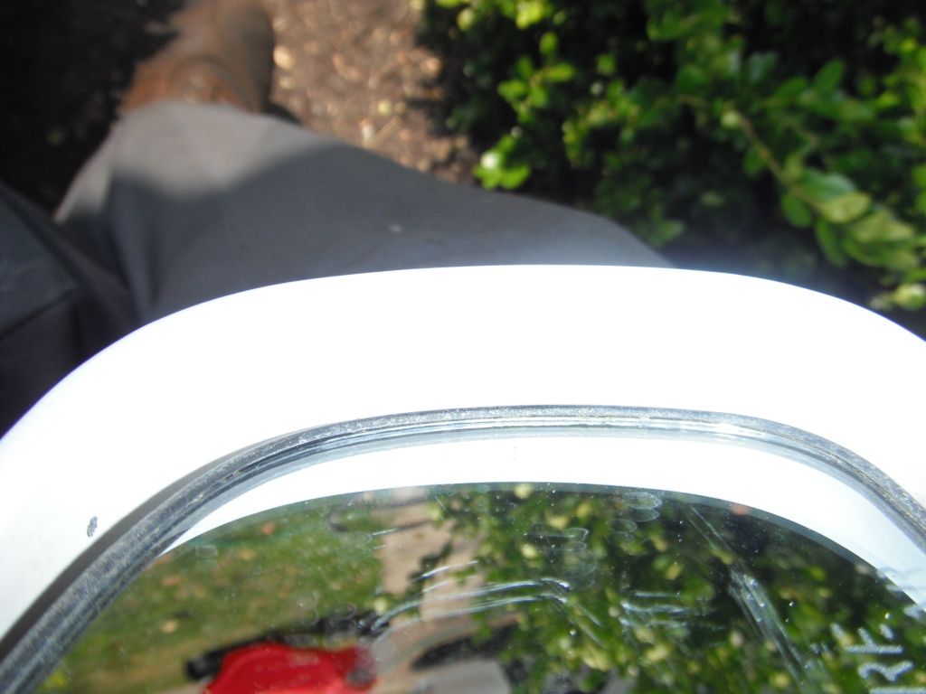

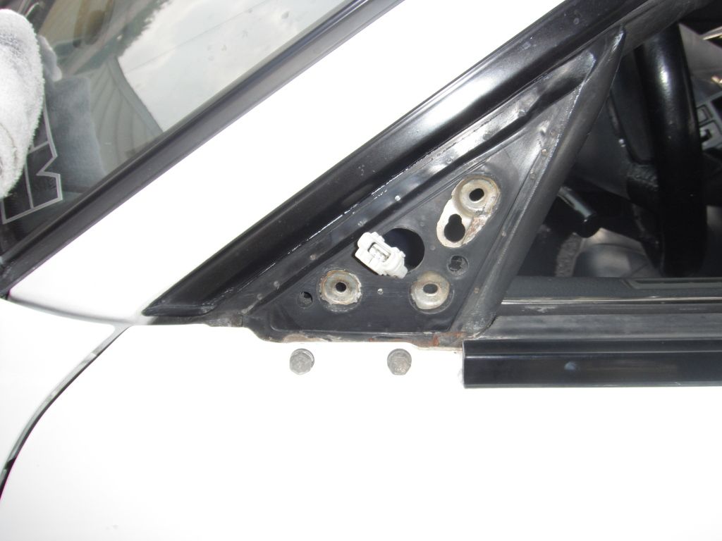

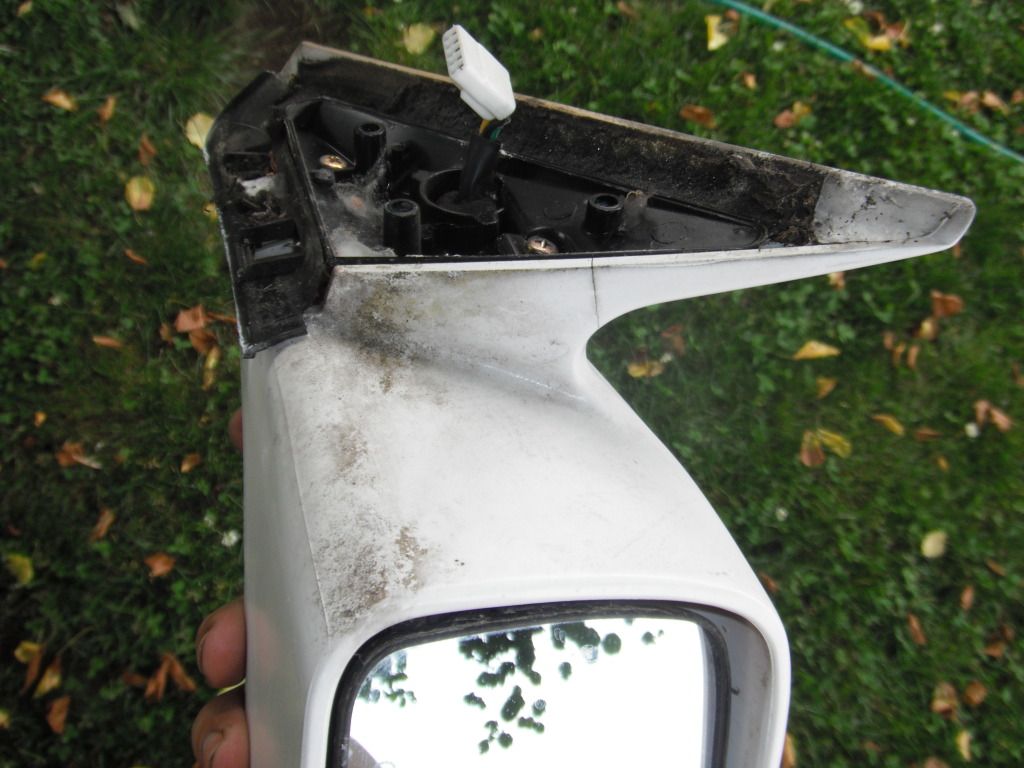

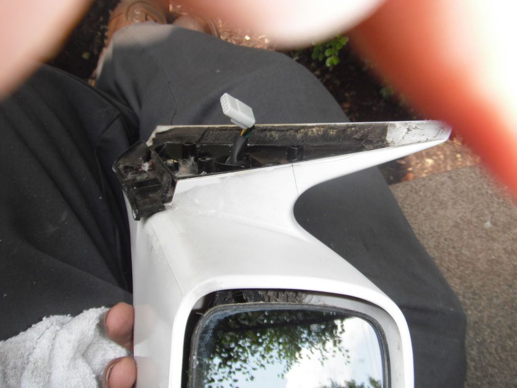

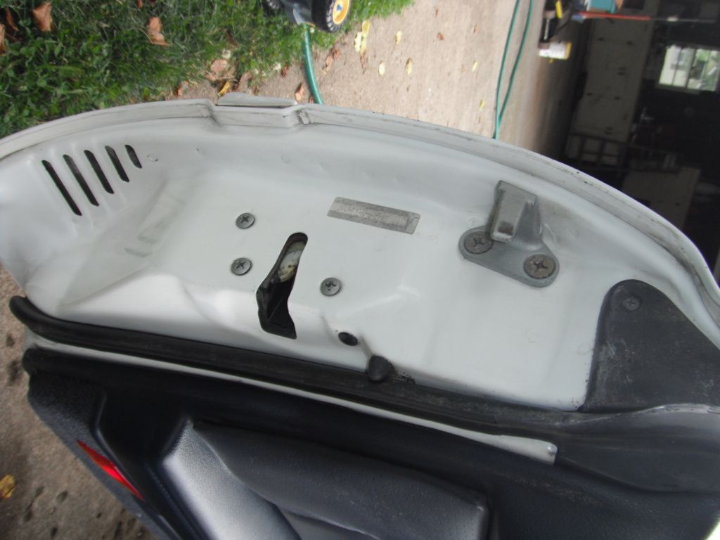

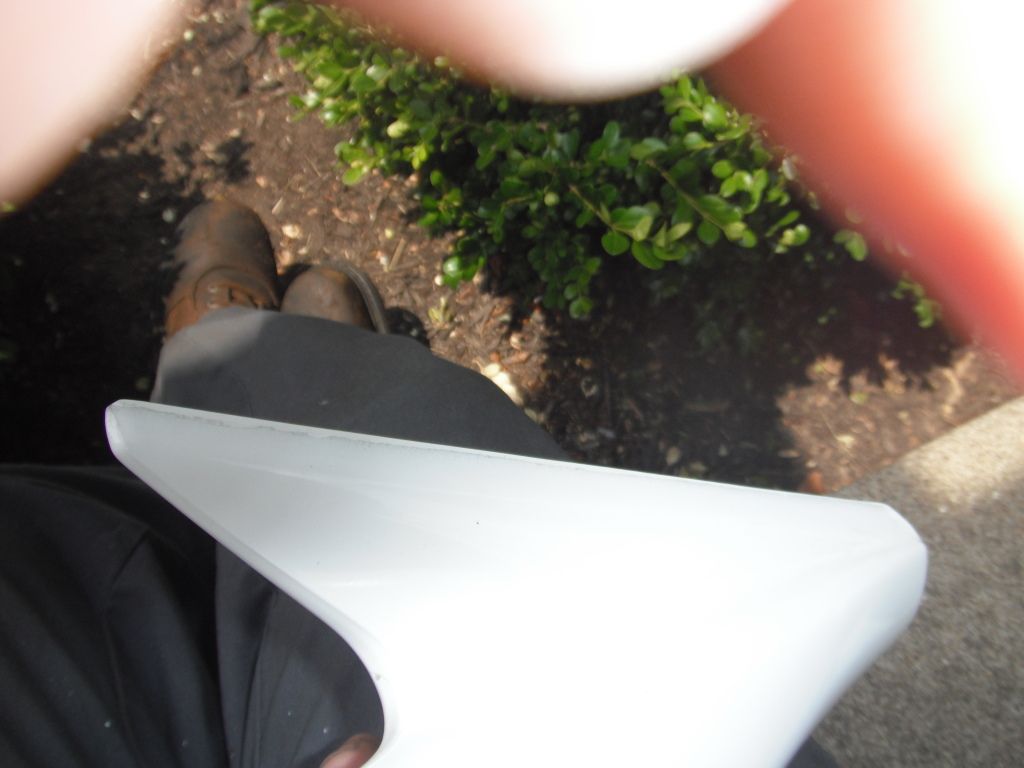

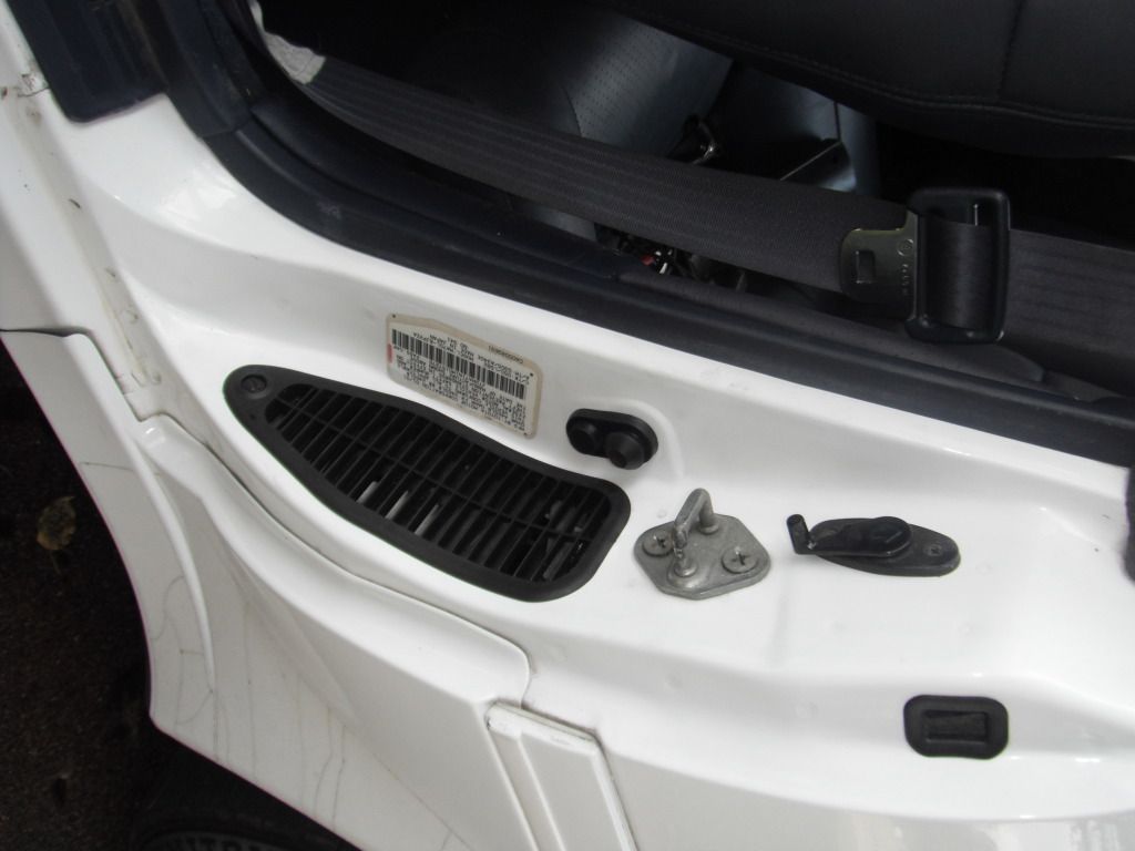

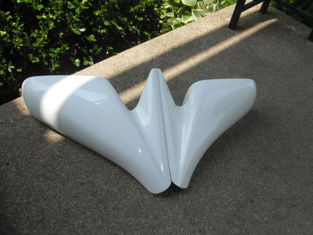

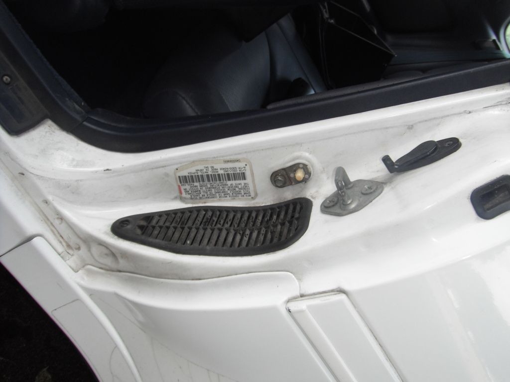

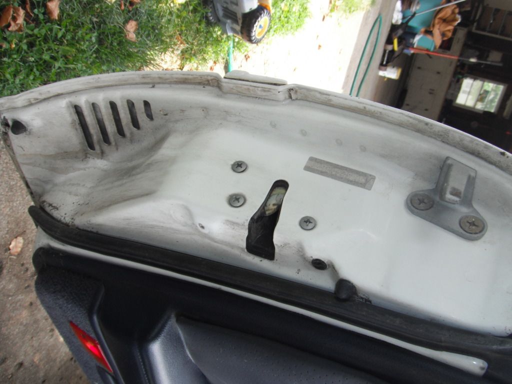

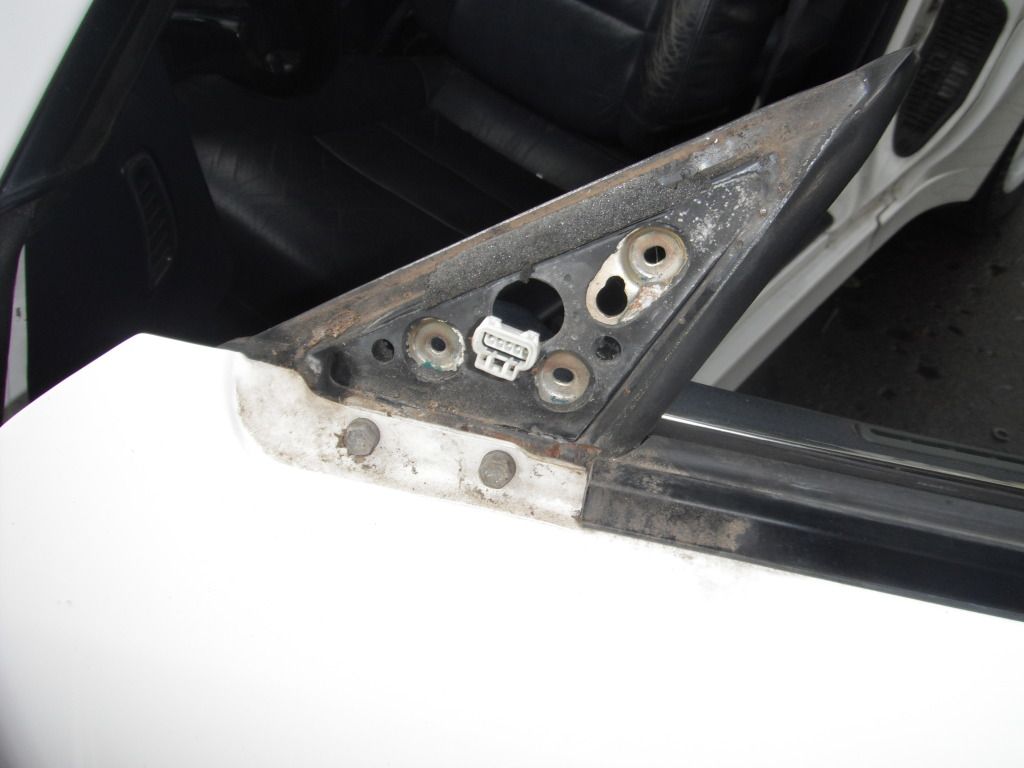

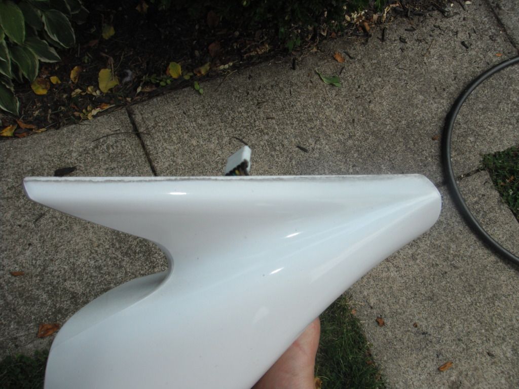

So far today I managed to continue my deep cleaning
Cleaned door seals, removed mirrors/cleaned, replaced door sensors and performed the HAC mod to my ecu
Before pics:
After:
Heres a picture of my fuel pump hanger when i first removed tank:
